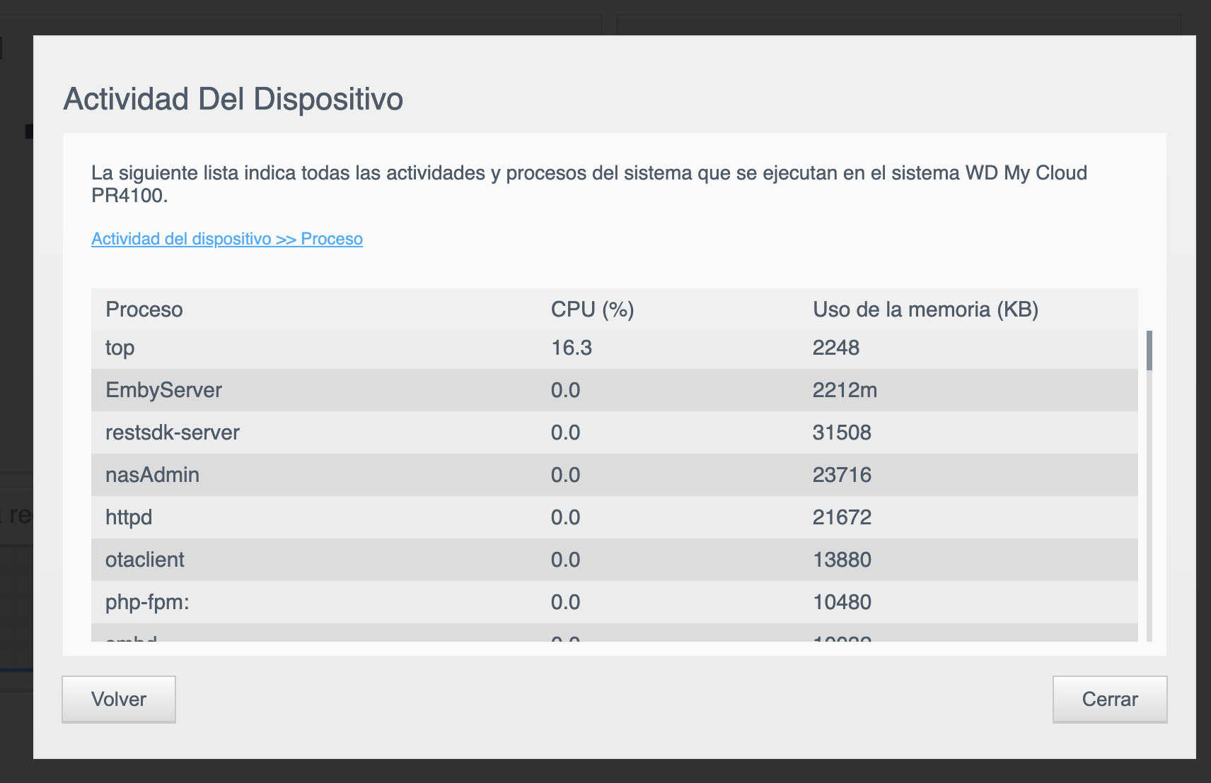

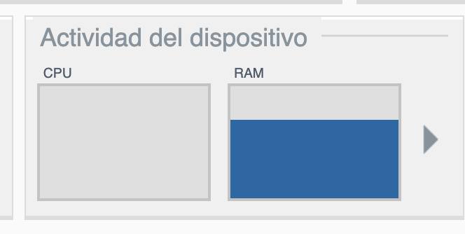

DarkStar1977 120 Posted October 17, 2025 Posted October 17, 2025 (edited) Emby Team. I don't know what you've made with 4.9 but is completely overloading a PR4100 NAS that worked perfectly on version 4.8. The new version is consuming RAM and CPU resources like hell and even sometimes crashing EmbyServer service iself, making the unit to overheat and launch warnings that temperture it too high, freezing the NAS completely with no other way to recover to force a shutdown by pressing the power button, taking more than 20 seconds to load the "edit" page for images in all content, and the last one, adding a new podcast source, making freeze the NAS forcing me to press the power button to shutdown. Every time you press the button to shutdown you risk to damage the information on the NAS and takes more than 20 minutes to restart to check data integrity and coherence. I'm attaching the last log, but please check this version because it's clear is not optimized for this Hardware at all and must have been stayed as beta for longer time. Thanks. Before Shutting down: embyserver-63896316744.txt After rebooting, hardware_detection-63896316778.txt embyserver (3).txt Edited October 17, 2025 by DarkStar1977

sa2000 695 Posted October 24, 2025 Posted October 24, 2025 3 minutes ago, DarkStar1977 said: I'm happy to run any test needed, but the memory consumption is happening all the time. We need to understand what actions make memory go up faster. Hence @Luke's suggestion to see what it is like without the added plugins On my WD MyCloudPR4100 memory was reaching 3Gb daily with scheduled Scan Media Library every 4 hours. Switching to weekly it is now at only 1Gb after more than a day. So I will probably just need once or twice a week restart of the Emby Server process - whilst we have this issue with high memory use. So what I am after is establishing how soon after launch we reach 2Gb and 3G and look for clues in the debug log files and second by second RSS / Swap memory usage log You can start with just normal running for a couple of days and then I can have a look at the diagnostics and suggest next step It would still be good to know on a vanilla install without added plugins, how emby server uses memory - so that could be another 2 days test Note that the script can be left running and it would detect any PID changes after Emby Server restarts. If you do need to restart the script, make sure you make a change to the output filename if the restart is on the same day - best to make sure the PC running the script does not restart / shutdown and leave it running all the time - until completion of all tests

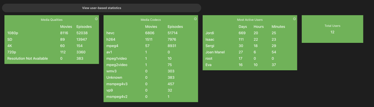

DarkStar1977 120 Posted October 24, 2025 Author Posted October 24, 2025 BTW, this is coming from the "Statistics" plugin, in case helps on sizing of my libraries: 1
