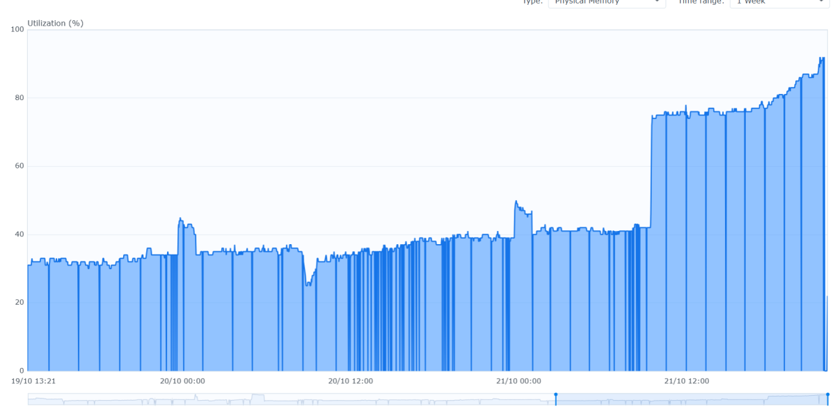

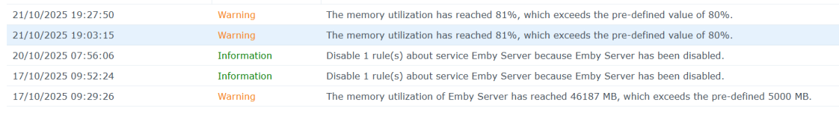

GOTCHA_SA 8 Posted October 21, 2025 Author Posted October 21, 2025 (edited) Hi @Luke Just had the server crash again with the same System out of memory error: embyserver-63896682700.txt I checked the server Logs Can see it ramped up since 12:00 today I also have just seen a log rule I configured for the 17/10 ( for some reason it disabled) stating the memory usage had increased to a maximum level from the Emby App, I have re-enabled the log rule. Something is causing the Emby to ramp up in Memory usage and I am not sure what, hope you can assist with this many thanks in advance Edited October 21, 2025 by GOTCHA_SA
