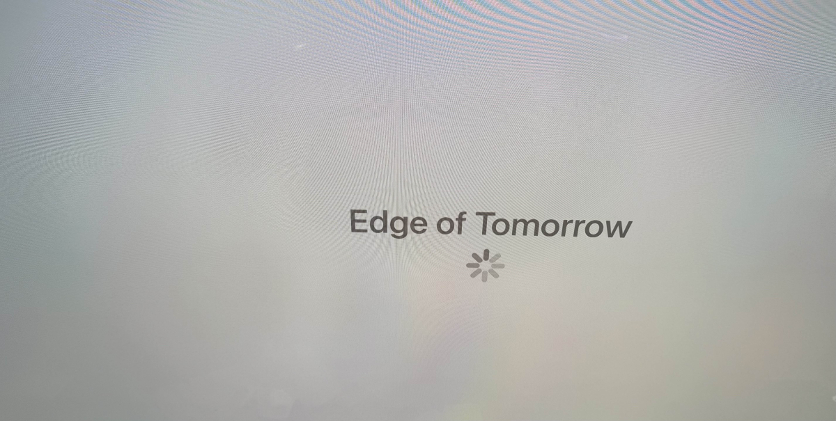

WhiteStig 2 Posted October 17, 2025 Posted October 17, 2025 Any update or solution for this. I have the same issue.
Luke 42239 Posted October 17, 2025 Posted October 17, 2025 @WhiteStig HI there, can you please provide a specific example? How to Report a Problem Thanks !
WhiteStig 2 Posted October 17, 2025 Author Posted October 17, 2025 When I attempt to load videos that will actually play it takes over 30 seconds to load the screen with the name of the movie, the graphics, etc. It seems the tvOS side of this product is not ready for prime time. I am getting a better experience with the LG app built into the television.
Luke 42239 Posted October 17, 2025 Posted October 17, 2025 42 minutes ago, WhiteStig said: When I attempt to load videos that will actually play it takes over 30 seconds to load the screen with the name of the movie, the graphics, etc. It seems the tvOS side of this product is not ready for prime time. I am getting a better experience with the LG app built into the television. Hi there, can you please provide the information that I requested above? Thanks.
WhiteStig 2 Posted October 17, 2025 Author Posted October 17, 2025 About 20 seconds to load the page for the movie embyserver10172025 .txt

WhiteStig 2 Posted October 21, 2025 Author Posted October 21, 2025 Probably here? 2025-10-17 13:25:21.378 Info LibraryService-0HNGC9U5TJ82H:00000001: http/1.1 Response 500 to host2. Time: 9ms. GET http://192.168.1.61:8096/emby/Items/111340/Similar?userId=91ebf8f74d044ac49f64aac2604c5e7e&ImageTypeLimit=1&fields=BasicSyncInfo,CanDelete,PrimaryImageAspectRatio,ProductionYear,Status,EndDate&limit=12&includeItemTypes=Program&GroupProgramsBySeries=true&EnableTotalRecordCount=false&X-Emby-Client=Emby for Apple TV&X-Emby-Device-Name=Apple TV&X-Emby-Device-Id=7F3746E1-E5E0-42D2-9C3E-B6B339A420B9&X-Emby-Client-Version=2.0.0 (4)&X-Emby-Token=x_secret6_x. 2025-10-17 13:25:21.379 Info SqliteItemRepository: Interrupt query due to cancellation.
Luke 42239 Posted October 22, 2025 Posted October 22, 2025 7 hours ago, WhiteStig said: Probably here? 2025-10-17 13:25:21.378 Info LibraryService-0HNGC9U5TJ82H:00000001: http/1.1 Response 500 to host2. Time: 9ms. GET http://192.168.1.61:8096/emby/Items/111340/Similar?userId=91ebf8f74d044ac49f64aac2604c5e7e&ImageTypeLimit=1&fields=BasicSyncInfo,CanDelete,PrimaryImageAspectRatio,ProductionYear,Status,EndDate&limit=12&includeItemTypes=Program&GroupProgramsBySeries=true&EnableTotalRecordCount=false&X-Emby-Client=Emby for Apple TV&X-Emby-Device-Name=Apple TV&X-Emby-Device-Id=7F3746E1-E5E0-42D2-9C3E-B6B339A420B9&X-Emby-Client-Version=2.0.0 (4)&X-Emby-Token=x_secret6_x. 2025-10-17 13:25:21.379 Info SqliteItemRepository: Interrupt query due to cancellation. It looks like you have a live tv guide refresh and a library scan going at that exact same time. Perhaps that is the reason?

WhiteStig 2 Posted November 8, 2025 Author Posted November 8, 2025 Tried to load a movie twice around 22:36 ET. Takes about 15-20 seconds each time embyserver110720252236.txt
mandjou 3 Posted December 6, 2025 Posted December 6, 2025 (edited) Any update on this ? I'm having exactly the same problem and sorry, it's very annoying. One side remark, this only happens for libraries with the content type movie. For all the other libraries (content type) like Music, Music Videos, Home Videos & Photos the screen with the name of the movie, the graphics, etc. are almost instantly shown. Edited December 6, 2025 by mandjou
mandjou 3 Posted December 6, 2025 Posted December 6, 2025 One other thing to add, this all applies for Apple TV only, on a web browser on the same network everything works perfectly. Apple TV and PC are both connect to the same network switch, so no WiFi involved.
mandjou 3 Posted December 7, 2025 Posted December 7, 2025 Everything seems to be working again, at least on my end. Not sure for user WhiteStig though. I haven't touched anything, and I checked to make sure no scheduled tasks were clogging things up earlier. Looks like Emby did something 'under the hood' to fix itself over night. 1
WhiteStig 2 Posted December 8, 2025 Author Posted December 8, 2025 On 12/7/2025 at 5:03 AM, mandjou said: Everything seems to be working again, at least on my end. Not sure for user WhiteStig though. I haven't touched anything, and I checked to make sure no scheduled tasks were clogging things up earlier. Looks like Emby did something 'under the hood' to fix itself over night. No improvement on my end.
Luke 42239 Posted December 8, 2025 Posted December 8, 2025 2 hours ago, WhiteStig said: No improvement on my end. OK we are still looking at it. Thanks.
WhiteStig 2 Posted January 21 Author Posted January 21 On 12/29/2025 at 6:38 PM, Luke said: Hi, has Emby for Apple TV 2.0.3 helped? I’ve only tested a few titles but it seems way better. I think you also fixed the issue I was having with titles completely erring out instead of loading. 1
