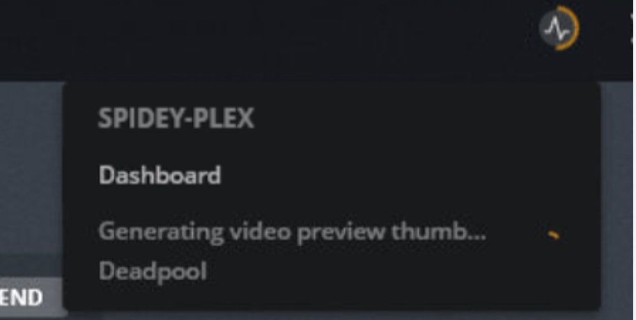

UsamaWaheed 12 Posted October 17, 2025 Author Posted October 17, 2025 I let the process run for several hours and noticed it completed 100/960 movies during that time, but the progress indicator stayed stuck at 0.0% until it suddenly finished. This makes it hard to tell if the job is actually progressing without constantly checking the logs. As a suggestion, it would be really helpful if the UI could show some indication of activity — even something simple like “processing media X, Y, Z…” — so we know it’s working. I understand percentages can be tricky to implement accurately, but Plex, for example, shows on the dashboard which file it’s generating thumbnails for, which makes it much easier to gauge that it is indeed working and not stuck on something. Plex example:
