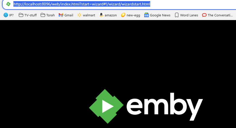

markie 2 Posted October 17, 2025 Posted October 17, 2025 **Quick synopsis ** emby died today. first couldn't find my log files (found log files: error was missing file: \dashboard-ui\index.html' could not be found. found it, and copied from another drive dated 09-30-24-t1710pm (index.html) from a different drive before I installed /upgraded the hardware Now I hang at the URL: http://localhost:8096/web/index.html?start=wizard#!/wizard/wizardstart.html And I am at least hanging at the EMBY login screen NEXT I found an old copy of the wizardstart.html file and got slightly further but it also hung after I selected english One problem I have is i don't see any logs from before today when I was having problems. can someone give me another nudge in the right direction to help troubleshoot this? Thanks again in advance. I've attached a log file from 5:30 and a hw file (same time) to this message TYVM --------------- embyserver-63896232806.txt hardware_detection-63896232783.txt
