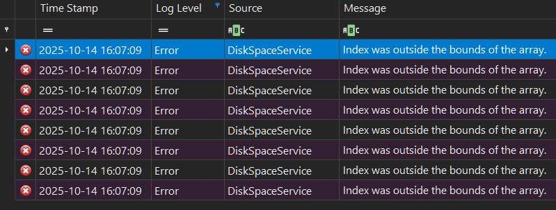

justinrh 266 Posted October 16, 2025 Posted October 16, 2025 I'd like to know why the (2) TV shows (Cheers) at 10 and 10:30pm CST didn't record. Any clues in the log? embyserver-63896083200.txt
justinrh 266 Posted October 16, 2025 Author Posted October 16, 2025 (edited) Well, lacking space is not it. I have 9GB free and <1GB would have been needed. Three other shows were recorded on Wed. Maybe Windows had an issue? Is the shown error what is normally seen when space is not available? Edited October 17, 2025 by justinrh

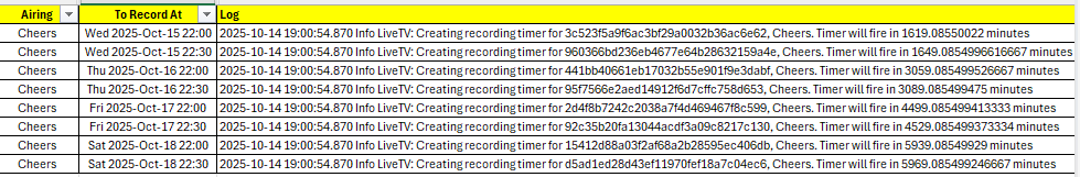

emveepee 133 Posted October 17, 2025 Posted October 17, 2025 These seem to be 10:00pm and 10:30pm on the 15th which he was asking about 2025-10-14 00:05:35.592 Info LiveTV: Creating recording timer for 3c523f5a9f6ac3bf29a0032b36ac6e62, Cheers. Timer will fire in 2754.406787133333 minutes 2025-10-14 00:05:35.638 Info LiveTV: Creating recording timer for 960366bd236eb4677e64b28632159a4e, Cheers. Timer will fire in 2784.4060248 minutes 1
Luke 42239 Posted October 23, 2025 Posted October 23, 2025 2754 minutes is 45 hours away, so we would need the logs from the next two days to see what happened.
sa2000 696 Posted October 24, 2025 Posted October 24, 2025 (edited) On 16/10/2025 at 23:23, justinrh said: I'd like to know why the (2) TV shows (Cheers) at 10 and 10:30pm CST didn't record. Any clues in the log? embyserver-63896083200.txt 310.57 kB · 7 downloads The fact that we do not have a log entry for timer trigger created to fire in 179 minutes and 209 minutes with these log entries indicates either: * The guide schedule did not have these episodes for the 14th, or * The series recordings settings were for New Episodes Only and the guide did not have that indicator set for the 2 airings, or * The episodes as identified in the guide / schedule metadata, match ones already in the recording library (or any library if the series option to check all libraries was selected) 2025-10-14 19:00:54.870 Info LiveTV: Creating recording timer for 3c523f5a9f6ac3bf29a0032b36ac6e62, Cheers. Timer will fire in 1619.08550022 minutes 2025-10-14 19:00:54.870 Info LiveTV: Creating recording timer for 960366bd236eb4677e64b28632159a4e, Cheers. Timer will fire in 1649.0854996616667 minutes 2025-10-14 19:00:54.870 Info LiveTV: Creating recording timer for 441bb40661eb17032b55e901f9e3dabf, Cheers. Timer will fire in 3059.085499526667 minutes 2025-10-14 19:00:54.870 Info LiveTV: Creating recording timer for 95f7566e2aed14912f6d7cffc758d653, Cheers. Timer will fire in 3089.085499475 minutes 2025-10-14 19:00:54.870 Info LiveTV: Creating recording timer for 2d4f8b7242c2038a7f4d469467f8c599, Cheers. Timer will fire in 4499.085499413333 minutes 2025-10-14 19:00:54.870 Info LiveTV: Creating recording timer for 92c35b20fa13044acdf3a09c8217c130, Cheers. Timer will fire in 4529.085499373334 minutes 2025-10-14 19:00:54.870 Info LiveTV: Creating recording timer for 15412d88a03f2af68a2b28595ec406db, Cheers. Timer will fire in 5939.08549929 minutes 2025-10-14 19:00:54.870 Info LiveTV: Creating recording timer for d5ad1ed28d43ef11970fef18a7c04ec6, Cheers. Timer will fire in 5969.085499246667 minutes 2025-10-14 19:00:54.870 Info LiveTV: Creating recording timer for 9af89e816c3e03510827845414b6b431, Cheers. Timer will fire in 5999.085499203334 minutes 2025-10-14 19:00:54.870 Info LiveTV: Creating recording timer for 76b20ab7c896b5cbce650a29798f043d, Cheers. Timer will fire in 6029.085499163333 minutes 2025-10-14 19:00:54.872 Info LiveTV: Creating recording timer for 3c523f5a9f6ac3bf29a0032b36ac6e62, Cheers. Timer will fire in 1619.0854579016666 minutes 2025-10-14 19:00:54.872 Info LiveTV: Creating recording timer for 960366bd236eb4677e64b28632159a4e, Cheers. Timer will fire in 1649.0854576966667 minutes 2025-10-14 19:00:54.872 Info LiveTV: Creating recording timer for 441bb40661eb17032b55e901f9e3dabf, Cheers. Timer will fire in 3059.0854575933336 minutes 2025-10-14 19:00:54.872 Info LiveTV: Creating recording timer for 95f7566e2aed14912f6d7cffc758d653, Cheers. Timer will fire in 3089.085457551667 minutes 2025-10-14 19:00:54.872 Info LiveTV: Creating recording timer for 2d4f8b7242c2038a7f4d469467f8c599, Cheers. Timer will fire in 4499.08545749 minutes 2025-10-14 19:00:54.872 Info LiveTV: Creating recording timer for 92c35b20fa13044acdf3a09c8217c130, Cheers. Timer will fire in 4529.08545745 minutes 2025-10-14 19:00:54.872 Info LiveTV: Creating recording timer for 15412d88a03f2af68a2b28595ec406db, Cheers. Timer will fire in 5939.085457378334 minutes 2025-10-14 19:00:54.872 Info LiveTV: Creating recording timer for d5ad1ed28d43ef11970fef18a7c04ec6, Cheers. Timer will fire in 5969.0854573316665 minutes 2025-10-14 19:00:54.872 Info LiveTV: Creating recording timer for 9af89e816c3e03510827845414b6b431, Cheers. Timer will fire in 5999.085457285 minutes 2025-10-14 19:00:54.872 Info LiveTV: Creating recording timer for 76b20ab7c896b5cbce650a29798f043d, Cheers. Timer will fire in 6029.085457043333 minutes 2025-10-14 19:00:54.873 Info LiveTV: Creating recording timer for 3c523f5a9f6ac3bf29a0032b36ac6e62, Cheers. Timer will fire in 1619.08543482 minutes 2025-10-14 19:00:54.873 Info LiveTV: Creating recording timer for 960366bd236eb4677e64b28632159a4e, Cheers. Timer will fire in 1649.0854346416668 minutes 2025-10-14 19:00:54.873 Info LiveTV: Creating recording timer for 441bb40661eb17032b55e901f9e3dabf, Cheers. Timer will fire in 3059.0854345633334 minutes 2025-10-14 19:00:54.873 Info LiveTV: Creating recording timer for 95f7566e2aed14912f6d7cffc758d653, Cheers. Timer will fire in 3089.0854345083335 minutes 2025-10-14 19:00:54.873 Info LiveTV: Creating recording timer for 2d4f8b7242c2038a7f4d469467f8c599, Cheers. Timer will fire in 4499.085434433333 minutes 2025-10-14 19:00:54.873 Info LiveTV: Creating recording timer for 92c35b20fa13044acdf3a09c8217c130, Cheers. Timer will fire in 4529.085434391666 minutes 2025-10-14 19:00:54.873 Info LiveTV: Creating recording timer for 15412d88a03f2af68a2b28595ec406db, Cheers. Timer will fire in 5939.085433938333 minutes 2025-10-14 19:00:54.873 Info LiveTV: Creating recording timer for d5ad1ed28d43ef11970fef18a7c04ec6, Cheers. Timer will fire in 5969.085433888334 minutes 2025-10-14 19:00:54.873 Info LiveTV: Creating recording timer for 9af89e816c3e03510827845414b6b431, Cheers. Timer will fire in 5999.085433848333 minutes 2025-10-14 19:00:54.873 Info LiveTV: Creating recording timer for 76b20ab7c896b5cbce650a29798f043d, Cheers. Timer will fire in 6029.085433808334 minutes The only 22:00 and 22:30 recordings that Emby Server established need to be recorded were the following: As with regards to the Diskspace plugin error messages 2025-10-14 16:07:09.834 Info DiskSpaceService: DISK SPACE -- C:\ 2025-10-14 16:07:09.834 Error DiskSpaceService: Index was outside the bounds of the array. 2025-10-14 16:07:09.835 Info DiskSpaceService: DISK SPACE -- D:\ 2025-10-14 16:07:09.835 Error DiskSpaceService: Index was outside the bounds of the array. 2025-10-14 16:07:09.837 Info DiskSpaceService: DISK SPACE -- F:\ 2025-10-14 16:07:09.837 Error DiskSpaceService: Index was outside the bounds of the array. 2025-10-14 16:07:09.851 Info DiskSpaceService: DISK SPACE -- Z:\ 2025-10-14 16:07:09.851 Error DiskSpaceService: Index was outside the bounds of the array. 2025-10-14 16:07:09.898 Info DiskSpaceService: DISK SPACE -- C:\ 2025-10-14 16:07:09.898 Error DiskSpaceService: Index was outside the bounds of the array. 2025-10-14 16:07:09.900 Info DiskSpaceService: DISK SPACE -- D:\ 2025-10-14 16:07:09.900 Error DiskSpaceService: Index was outside the bounds of the array. 2025-10-14 16:07:09.903 Info DiskSpaceService: DISK SPACE -- F:\ 2025-10-14 16:07:09.903 Error DiskSpaceService: Index was outside the bounds of the array. 2025-10-14 16:07:09.905 Info DiskSpaceService: DISK SPACE -- Z:\ 2025-10-14 16:07:09.905 Error DiskSpaceService: Index was outside the bounds of the array. These were discussed previously here Edited October 24, 2025 by sa2000 1
