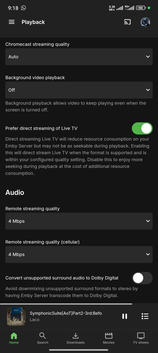

VaderMaul 0 Posted October 29, 2025 Posted October 29, 2025 Update – Temporary Solution Found I found a temporary fix for the issue with FLAC files crashing the Emby Android app when using mobile data. On the Android client side, under Settings → Playback, there are two options: Remote streaming quality Remote streaming quality (cellular) Both were previously set to Auto. After changing both settings to a fixed value — for example, 4 Mbps — the app no longer crashes when playing FLAC files over mobile data. After applying this change, I tested several FLAC tracks in two Android devices, and they played successfully without the app closing. It seems that when set to Auto, the Emby Android app may incorrectly handle bitrate negotiation or buffer management for FLAC streams under mobile data, causing the crash. Setting a fixed streaming bitrate stabilizes playback.
