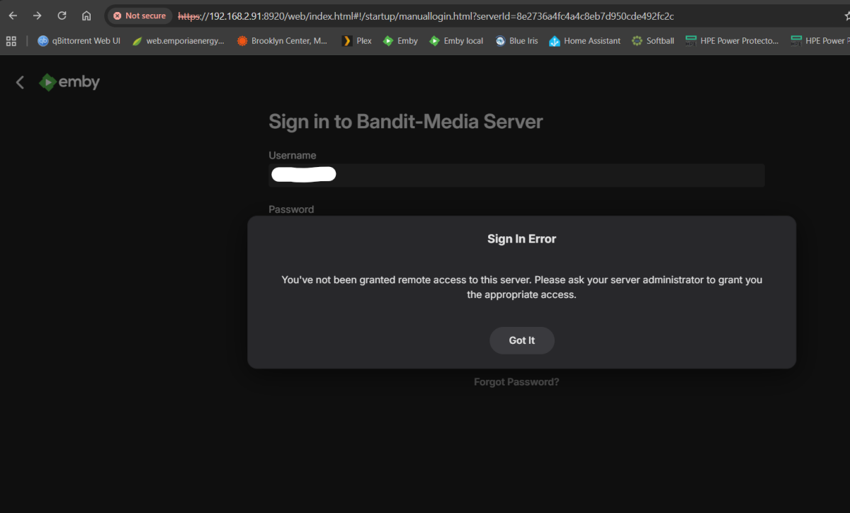

bandit8623 235 Posted October 15, 2025 Posted October 15, 2025 (edited) hello, connected via vpn and connecting via local ip address. getting this error. pretty annoyed as im out of town and cant manage my server when i want too. when actually local and using same local ip i have no problems. this is an admin account that does not have renote access, but should be able to connect locally Edited October 15, 2025 by bandit8623
Luke 42289 Posted October 15, 2025 Posted October 15, 2025 Right the VPN is likely causing it to appear as a remote connection. You should be able to see the remote ip address in the server log, which may help you correct the problem.

yocker 1431 Posted October 15, 2025 Posted October 15, 2025 1 hour ago, bandit8623 said: hello, connected via vpn and connecting via local ip address. getting this error. pretty annoyed as im out of town and cant manage my server when i want too. when actually local and using same local ip i have no problems. this is an admin account that does not have renote access, but should be able to connect locally VPN connections tend to get their own unique IP address range, you need to set it up in Emby to be seen as a local address. This is for my VPN, it makes the VPN IP range be seen as local. 1
Solution Neminem 1630 Posted October 15, 2025 Solution Posted October 15, 2025 (edited) @bandit8623have you added you vpn ip range to you lan networks in emby? I hade to do that, to get it to work. I also needed to include Emby App to my vpn app's include list, when testing from my phone. Edited October 15, 2025 by Neminem 1

bandit8623 235 Posted October 20, 2025 Author Posted October 20, 2025 On 10/15/2025 at 12:00 AM, Neminem said: @bandit8623have you added you vpn ip range to you lan networks in emby? I hade to do that, to get it to work. I also needed to include Emby App to my vpn app's include list, when testing from my phone. This fixed my problem. thanks 1
