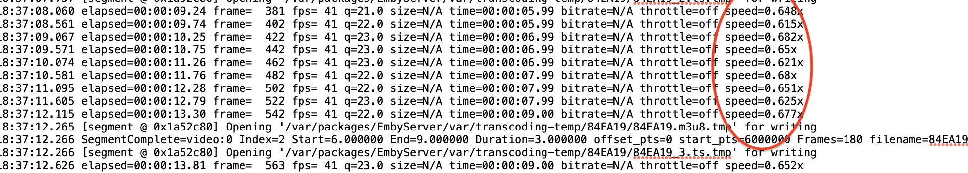

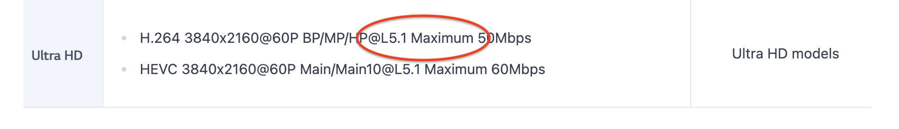

SamES 1084 Posted October 15, 2025 Posted October 15, 2025 (edited) 10 hours ago, GloverEggs said: So, I'm wondering if I have something set up incorrectly or if something else is going on. I'm on Emby 4.9.2.3. The videos were recorded on a cell phone and are in mp4 format. I'm just wondering why the files won't play on the TV. I know LG has issues with 4k videos at times, but these are in stereo only and don't have subtitles. I assume that the issue is with the transcoding which is why I assume I have something set incorrectly. Any help is appreciated. Thank you! ffmpeg-transcode-75204d90-0574-47b1-af86-5a06d19c4793_1.txt 36.06 kB · 1 download embyserver.txt 17.71 MB · 0 downloads Form the log file, the video level is not supported https://webostv.developer.lge.com/develop/specifications/video-audio-40 This is causing transcoding, but your server can't keep up. If the speed is less than 1.0x then it is transcoding at a rate that is too slow for playback. Edited October 15, 2025 by SamES 2
