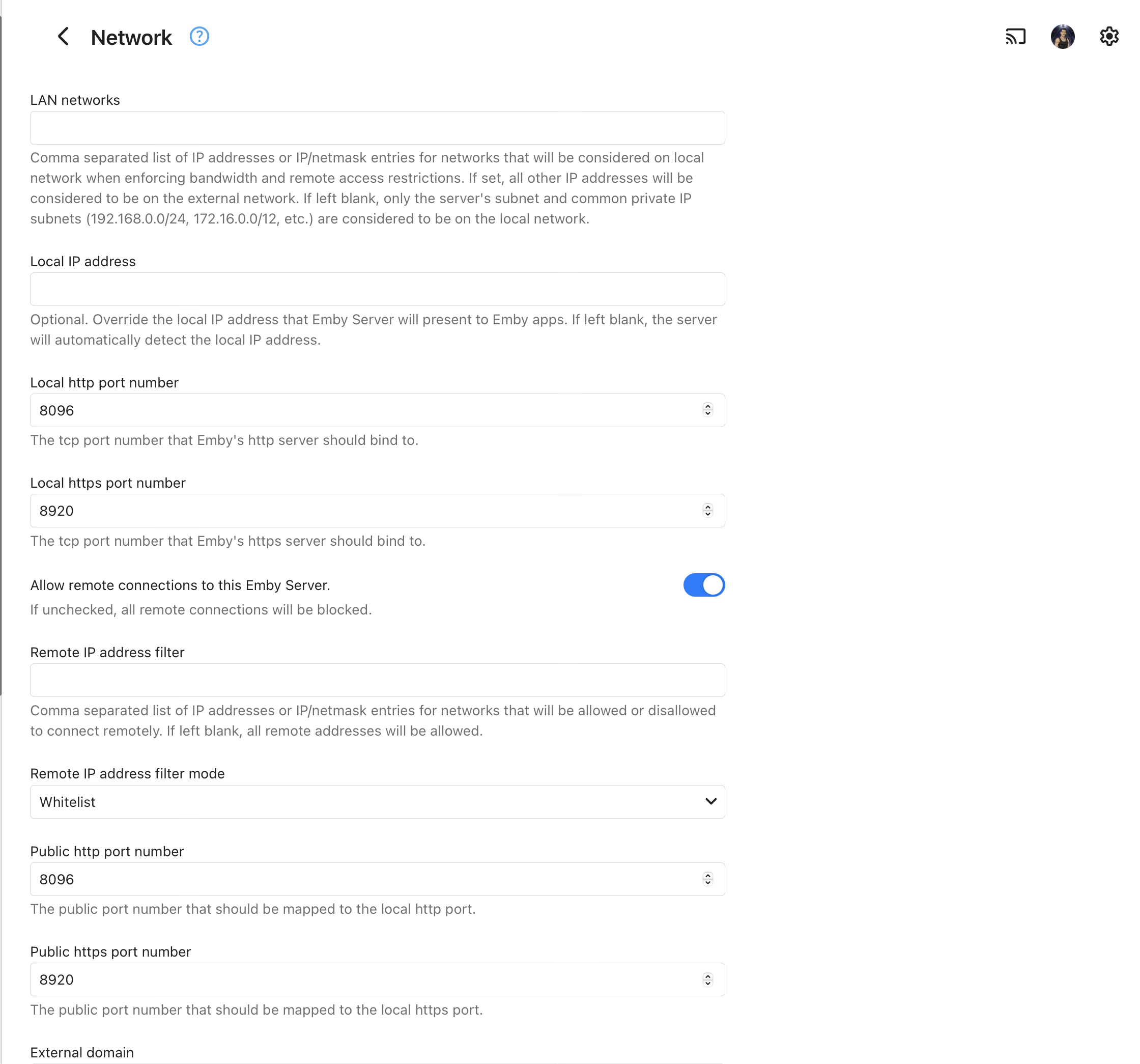

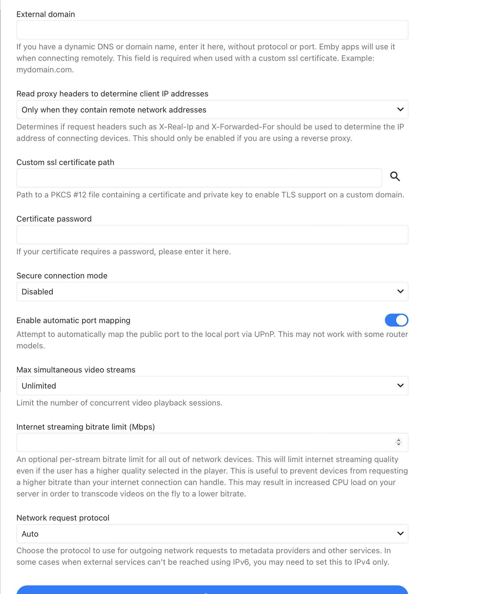

Luke 42237 Posted October 14, 2025 Posted October 14, 2025 Can you please show a screenshot of your network settings?
Ezamorano 3 Posted October 14, 2025 Author Posted October 14, 2025 When I get the chance. Would the update have caused anything on the settings to change? Everything was working just fine immediately before the update.
Luke 42237 Posted October 15, 2025 Posted October 15, 2025 7 hours ago, Ezamorano said: When I get the chance. Would the update have caused anything on the settings to change? Not that I can think of. Please provide that as well as the emby server log: How to Report a Problem Thanks !
GrimReaper 4893 Posted October 27, 2025 Posted October 27, 2025 (edited) On 10/19/2025 at 5:48 AM, Ezamorano said: With these settings, what does canyouseeme.org show you for port 8096? Edited October 27, 2025 by GrimReaper
Ezamorano 3 Posted October 28, 2025 Author Posted October 28, 2025 On 10/26/2025 at 6:58 PM, GrimReaper said: With these settings, what does canyouseeme.org show you for port 8096? Success: I can see your service on XXX.XX.XX.XX on port (8096) Your ISP is not blocking port 8096
