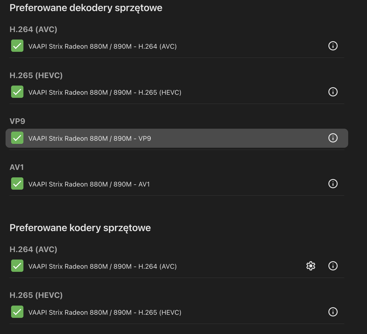

Smiehu 6 Posted October 14, 2025 Posted October 14, 2025 Hello, I have problem with HW transcoding with AMD AI 9 HX PRO 370 and Radeon™ 890M GPU. Transcoding seems to work but I have no video during playback (only audio). OS: Unraid 7.1.4 Emby: 4.9.1.80 (docker by linuxserver) GPU is recognized in Transcoding options (screen in attachment). During playback there is info that movie is transcoding by GPU (Vaapi) but no video during playback only audio and subtitles. A lot of errors in log. What can I do? ffmpeg-transcode-23429bfd-39d8-4f62-bcfe-ef7d3b1badc8_1.txt 1
