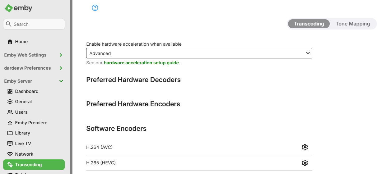

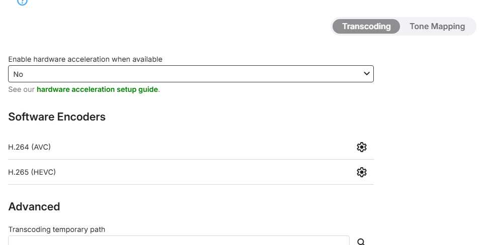

dardeaw 3 Posted October 14, 2025 Posted October 14, 2025 (edited) Hi Luke, I have purchased an Emby Premiere subscription. Everything works perfectly when running the Emby Server on Windows using an Alder Lake-N N97 system. Because of that positive experience, I recently bought a new QNAP model, the Qu405, which uses a similar architecture with the Intel N355 processor. However, whether I use the official QPKG package or the Docker version on this QNAP, I am unable to see the hardware transcoding option in Emby (as shown). Just to verify that it’s not a hardware or driver issue, I installed Jellyfin using Docker on the same device, and it was able to enable Quick Sync Video (QSV) and perform hardware transcoding smoothly (see Screenshot 2). Also, I have activated the Emby hardware transcoding feature by enabling the proper driver and confirming that the necessary device nodes (/dev/dri) are accessible inside the container. So licensing or permissions should not be the issue here. I’ve attached my Emby log file for your reference, and below is the Docker Compose YAML file I used to deploy Emby: version: '3.6' services: emby: container_name: emby image: 'emby/embyserver:latest' environment: - PUID=1000 - PGID=44 - TZ=Asia/Taipei volumes: - /share/CACHEDEV1_DATA/Container/Emby_Config:/config - /share/CACHEDEV1_DATA/Multimedia/Movies:/media - type: tmpfs target: /scratch tmpfs: size: 10000000000 devices: - /dev/dri/renderD128:/dev/dri/renderD128 - /dev/dri/card0:/dev/dri/card0 - /dev/dri:/dev/dri ports: - '8096:8096' - '8920:8920' restart: unless-stopped Could you please help me identify what might be causing Emby to not detect the hardware transcoding capability on this system, while Jellyfin works fine? Thank you for your time and support! embyserver.txt hardware_detection-63896080757.txt Edited October 14, 2025 by dardeaw

TMCsw 259 Posted October 17, 2025 Posted October 17, 2025 On 10/14/2025 at 11:09 AM, dardeaw said: Intel N355 processor. This (and other newer CPU/GPU) requires updated drivers (as you have installed), but that won't work with any current stable version of Emby on a Linux system. You need to wait for Emby to update the stable release (they have said it will happen sometime...) or use the current beta (9.4.1.2-beta or newer). PLEASE NOTE: Once you go to the beta, you may not be able to return to the stable version without a clean install!
