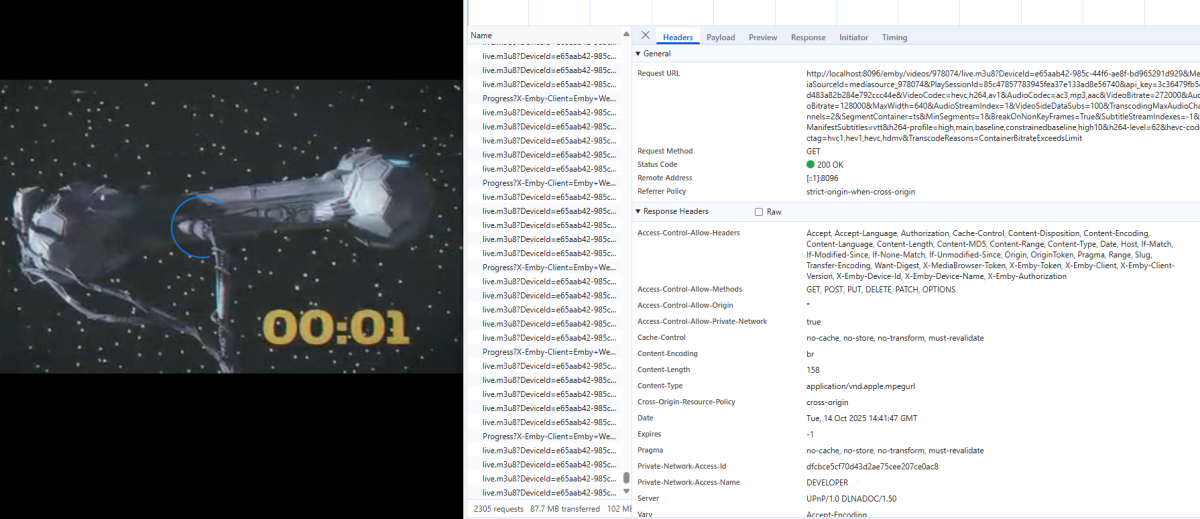

VicMoore 755 Posted October 16, 2025 Author Posted October 16, 2025 @LukeAs you know, Emby clients use HLS to play IPTV streams. A widely reported problem is the "Stalled Buffer" fatal error. HLS cannot mitigate this problem. It occurs when the stream goes through a change like Frame rate or resolution. The Emby web client post an error to the browser console log when it experiences this problem but sends no report back to the server. I propose that you send this error back to the server so developers can resolve the problem. A resolution is possible by sending a command to the client instructing it to play the media again at the current tick position. Remember we do this same step in both myTV and virtualTV. This simple step provides a solution to a major IPTV problem without any changes to the Emby server. I have tried to find in the session manager some means to determine when a buffer stall happens. I have found none. However, I did find it interesting that the Web Client continues sending "Progress" messages even when the client is hung by the buffer stall and displaying nothing. Do you know if the buffer stalled error is reported in any way back to the server? Vic

VicMoore 755 Posted October 17, 2025 Author Posted October 17, 2025 I am excited..... about the code Do you know if anyone has a fix for the Emby clients? I wrote a web client last year and solved the hls problem by removing hls and then starting it again. Vic
