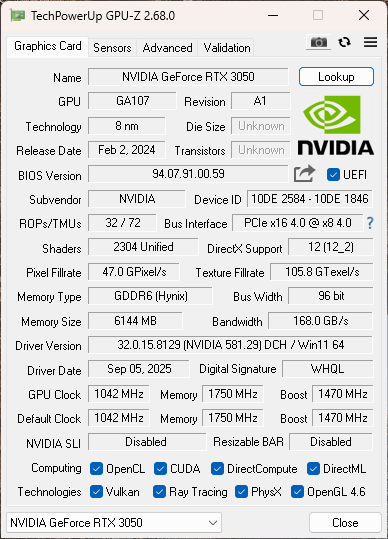

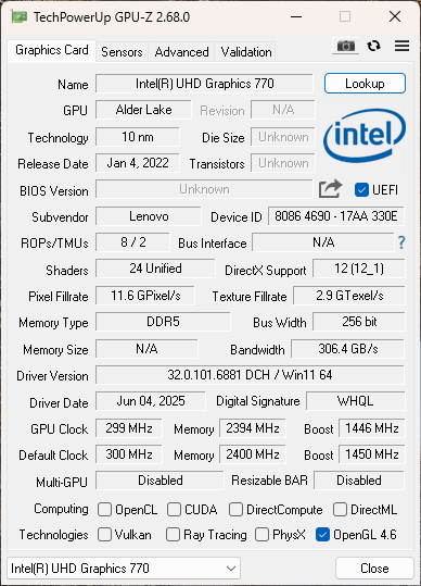

evanover 2 Posted October 14, 2025 Posted October 14, 2025 About a week ago at random times while playing a movie emby would lock the windows machine up and require a hard reset.No problems with machine except when using Emby. It's not any movie in particular or any Roku in particular.Never in the same place . I'm sure it has to do with the transcoding setting or the video driver. Device name MediaServer Processor 12th Gen Intel(R) Core(TM) i5-12500 (3.00 GHz) Installed RAM 64.0 GB (63.7 GB usable) System type 64-bit operating system, x64-based processor Edition Windows 11 Pro Version 24H2 OS build 26100.6725 embyserver-63895987285.txt ffmpeg-transcode-c7d3290f-186d-4ce8-becc-404bb93309e5_1 (1).txt ffmpeg-transcode-c7d3290f-186d-4ce8-becc-404bb93309e5_1.txt hardware_detection-63895987297.txt

evanover 2 Posted October 26, 2025 Author Posted October 26, 2025 Removed both video cards drivers from system and reinstalled. Lock up have stopped but even with playing only one stream on local hardwired network the system still has strutting during playback. 1
