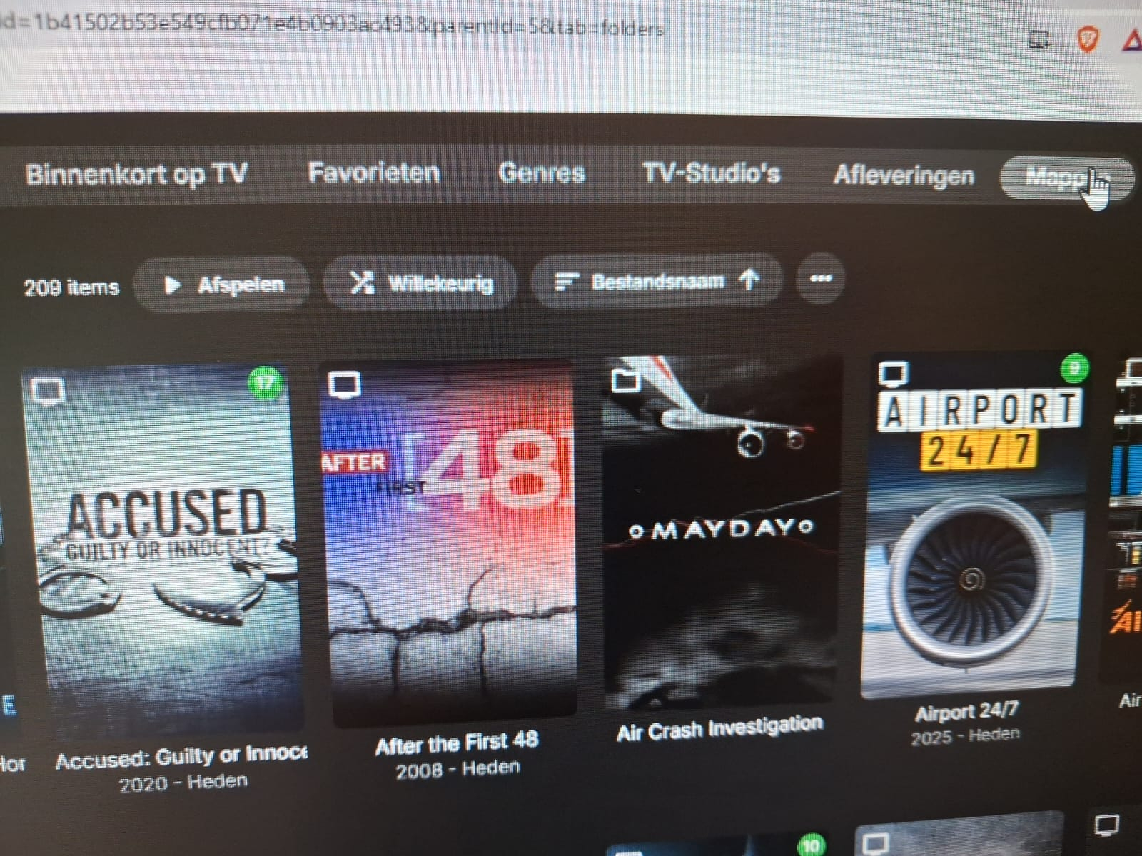

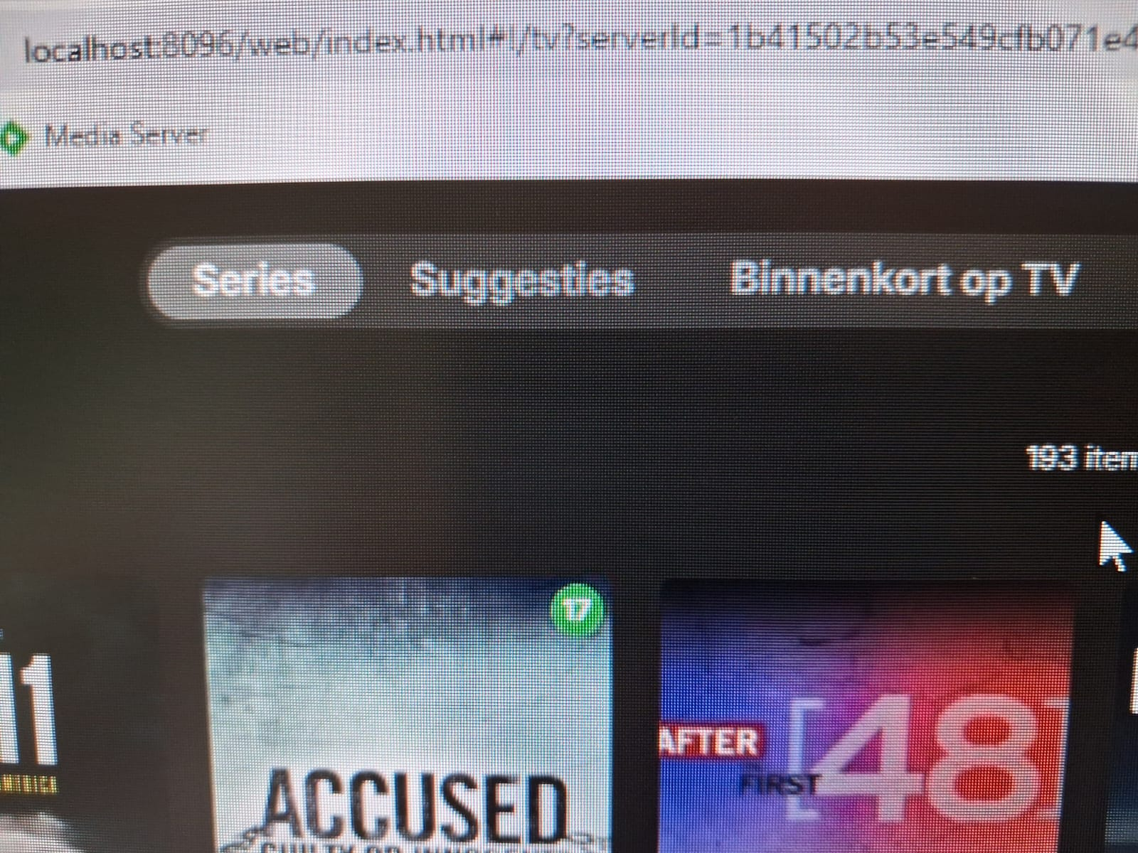

Dickslinger 0 Posted October 14, 2025 Posted October 14, 2025 (edited) When i use the tab series i count 193 Series, When i use the tab folder i count 209 should this be the same ? i'm using the server version 4.9.1.80, i already renewed my meta data Edited October 14, 2025 by Dickslinger

GrimReaper 4926 Posted October 14, 2025 Posted October 14, 2025 2 minutes ago, Dickslinger said: When i use the tab folder i count 209 should this be the same ? Not necessarily. Maybe you have series spread across multiple folders. Maybe some series were incorrectly merged. Maybe you have some series with no episodes. Folders tab tries to mimic your OS structure. Series tab displays what Emby "thinks" you have. They can match - but don't need to, depends on your filefolder structure/organization. 1
Dickslinger 0 Posted October 14, 2025 Author Posted October 14, 2025 Oke thnx my folder stucture is Tv-Shows / seriename /Season folder/ episode.mkv, i'm gonna check if there are empty folders
GrimReaper 4926 Posted October 14, 2025 Posted October 14, 2025 I would also check: 3 hours ago, GrimReaper said: Maybe some series were incorrectly merged Since it's one folder per TV Show, you should just compare what items are missing/not listed in Series tab (if any) that have their folder in Folders tab.
pgriffith 88 Posted October 14, 2025 Posted October 14, 2025 FYI, my folder contains 798 items and according to Emby I have 798 TV Shows. So, you probably do have some extra folders floating around.
Luke 42289 Posted October 14, 2025 Posted October 14, 2025 5 hours ago, GrimReaper said: I would also check: Since it's one folder per TV Show, you should just compare what items are missing/not listed in Series tab (if any) that have their folder in Folders tab. This would be the best thing to do.
