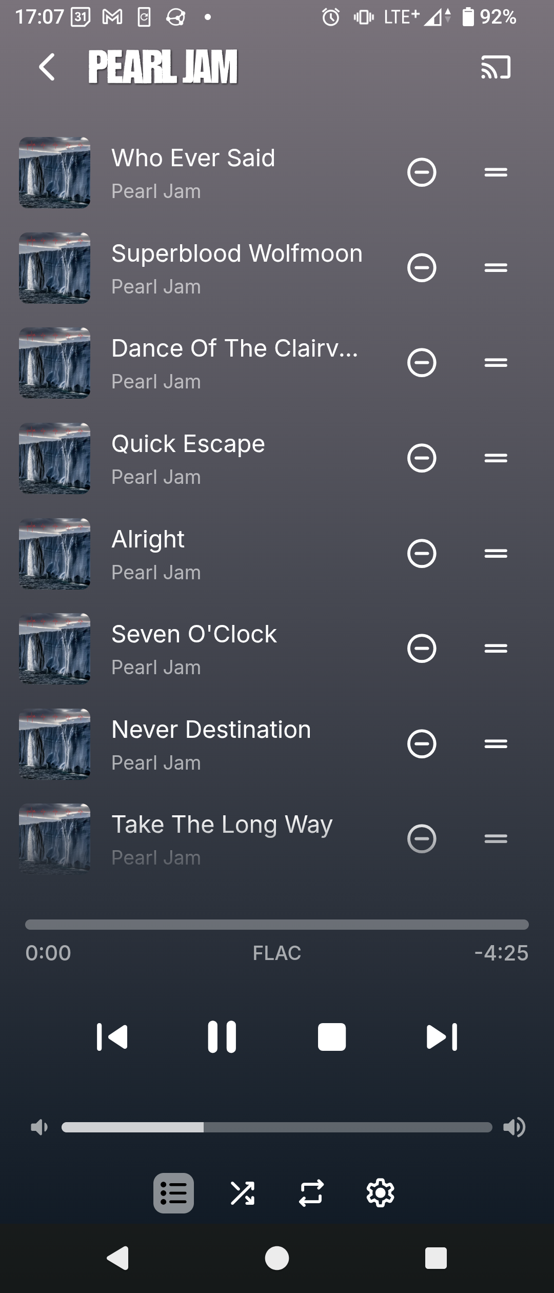

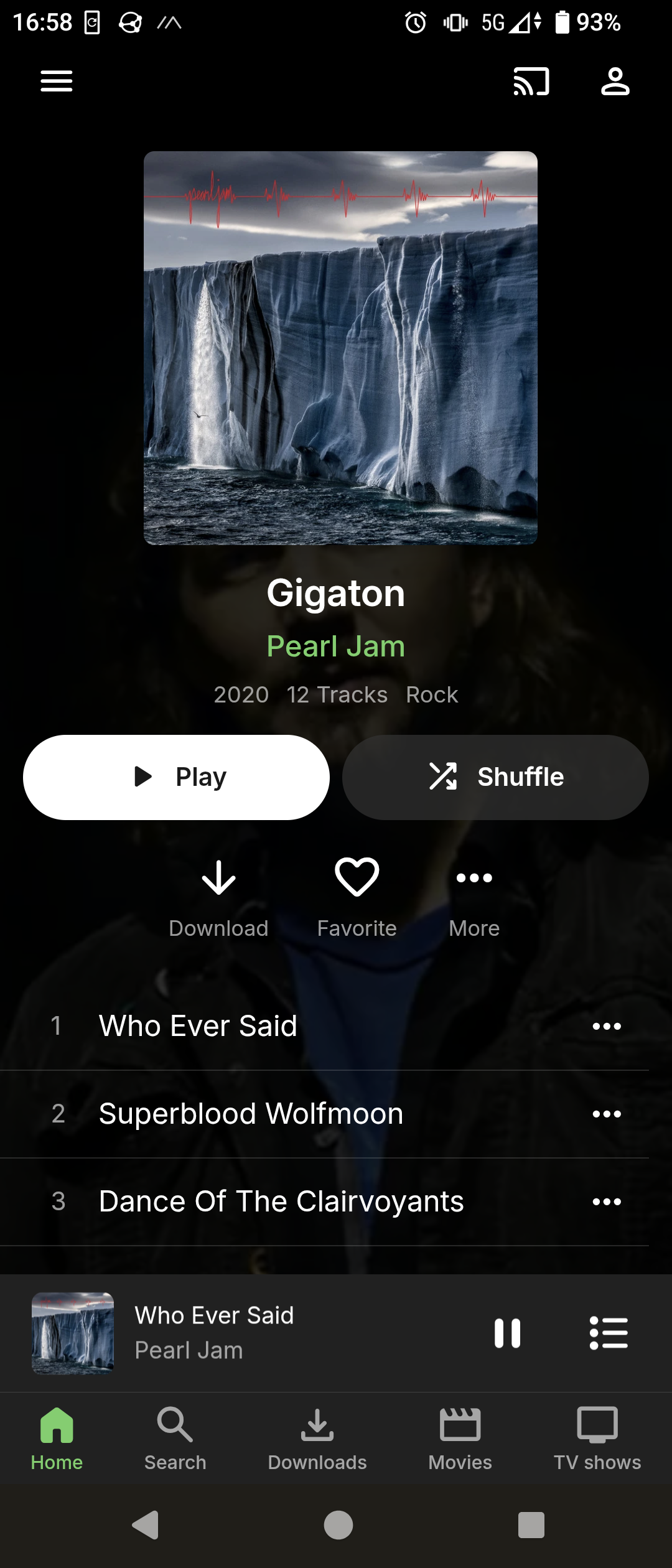

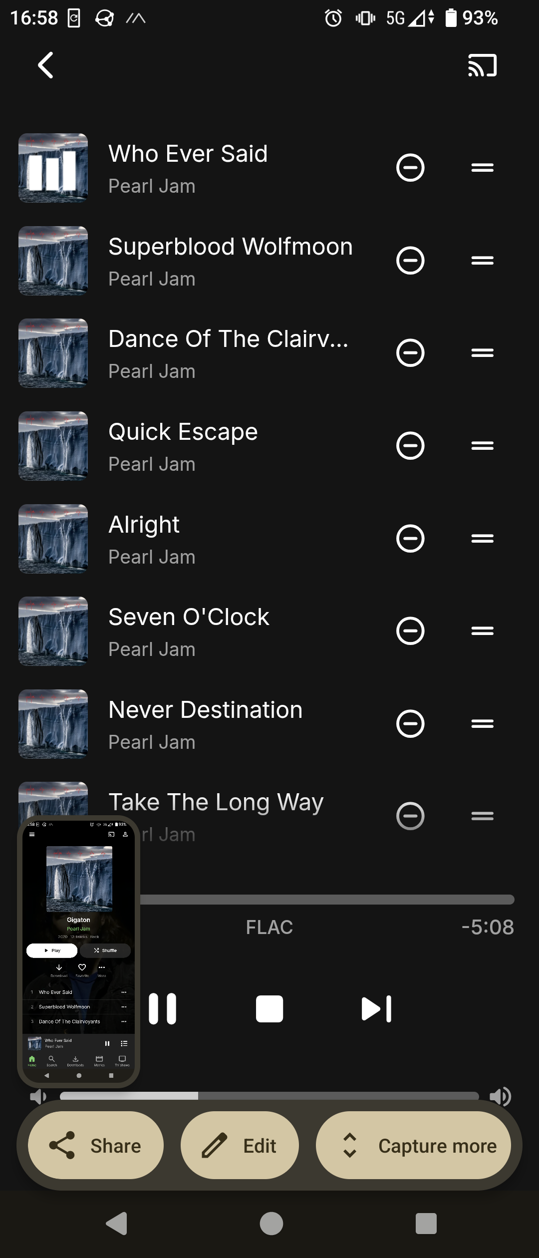

Smokeysevin 0 Posted May 11 Posted May 11 On 5/10/2026 at 1:14 PM, Luke said: @Smokeysevinwhere are you starting playback from? What does it show in the play queue? Emby app on Android, play queue shows the full album but the app closes or playback stops after 2 songs on mobile data. If I check back on it, it shows the current song is not playing and I can't manually play it. Images are start, queue, and when it stops. Sean
