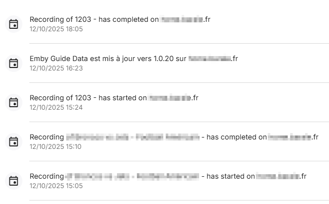

blap 3 Posted October 12, 2025 Posted October 12, 2025 Hello, I have a Windows server and I’m using an M3U TV playlist. Everything works perfectly except for the recordings, which randomly stop. I had a scheduled recording from 3:05 PM to 7:00 PM that stopped at 3:10 PM. I created another one that started at 3:23 PM and it stopped at 6:05 PM instead of 7:00 PM. The hard drive has plenty of space, and live playback works perfectly. Any idea what I could try?
Luke 42288 Posted October 12, 2025 Posted October 12, 2025 Hi there, please attach the Emby server log from when the problem occurred: How to Report a Problem Thanks!
blap 3 Posted October 12, 2025 Author Posted October 12, 2025 This is the server log embyserver (3).txt
Luke 42288 Posted October 14, 2025 Posted October 14, 2025 hi, your stream url started sending back a 401 unauthorized response. could you have hit some kind of limit with them?
