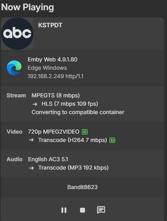

bandit8623 235 Posted October 11, 2025 Posted October 11, 2025 (edited) @Lukehevc is not being used for me when playing live tv mpeg2 via browser. its always using h264. is this a bug or the way it should be? arguably this is the largest file that should be transcoded smaller? Edited October 11, 2025 by bandit8623

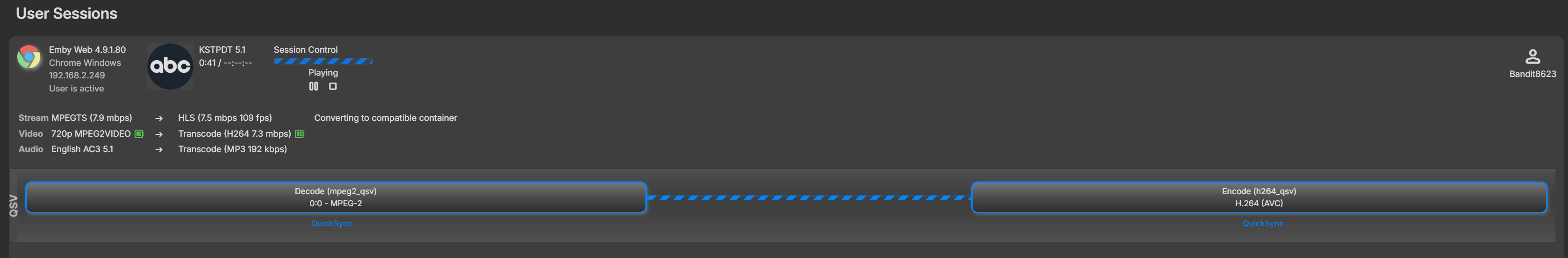

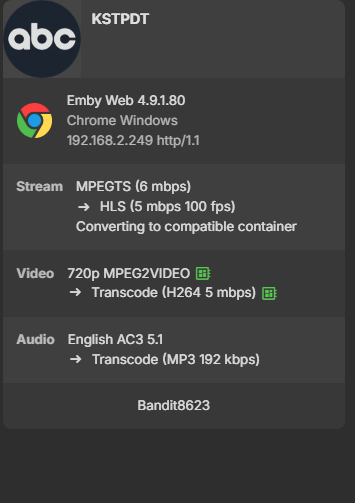

bandit8623 235 Posted October 11, 2025 Author Posted October 11, 2025 (edited) Per @Lukerequest for logs and such. here they are. live tv hdhomerun mpeg2 will not use the new hevc transcode. tried multiple browsers. ffmpeg-transcode-c560d794-f1ed-4100-9264-a8f2259071cd_1.txt embyserver (16).txt hardware_detection-63895519094 (1).txt Edited October 11, 2025 by bandit8623
bandit8623 235 Posted October 12, 2025 Author Posted October 12, 2025 edge as well ffmpeg-transcode-a842dc34-2e23-4d3a-9997-1a222e239be4_1.txt

bandit8623 235 Posted October 12, 2025 Author Posted October 12, 2025 (edited) 2 minutes ago, js28194 said: Looks to be on the local network. Can you confirm. My local network does not transcode, on reason to, but then again I don't use the web browser much so.... Also, the HDHomerun 4k does transcoding on the device itself I believe. this instance ive shown is local(it shouldnt matter local or not). i have all on device transcoding off(hdhomerun). Remote users also using browsers transcodes h264 as well for antenna tv. Edited October 12, 2025 by bandit8623

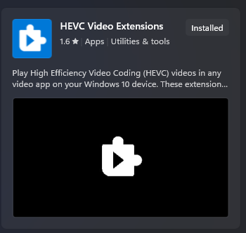

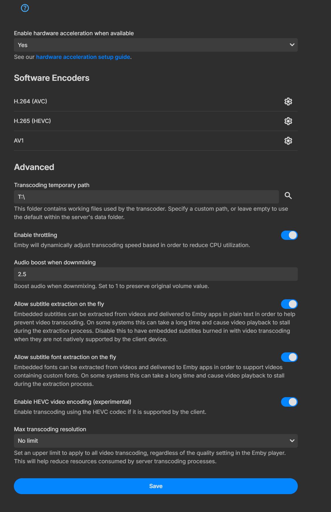

bandit8623 235 Posted October 12, 2025 Author Posted October 12, 2025 Just now, js28194 said: HEVC = h265, you playing h264... its a mpeg 2 stream. and getting transcoded to h264. this is the issue its not transcoding to hevc. the latest server release is supposed to be using hevc on browser and some new android apps. this bug report is for mainly the browser as that was hevc supported 1
