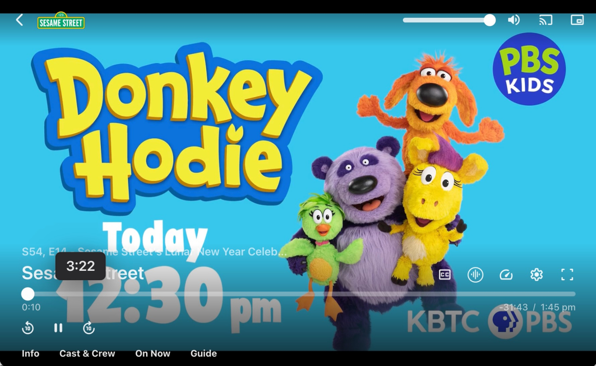

MediaFish 1 Posted October 11, 2025 Author Posted October 11, 2025 Thanks for responding. On my old server, when a video is playing and you move the mouse along the timeline, you see a small thumbnail of that part of the video. On the new server, you only see the time marking (please see that attached photos). Thanks again!

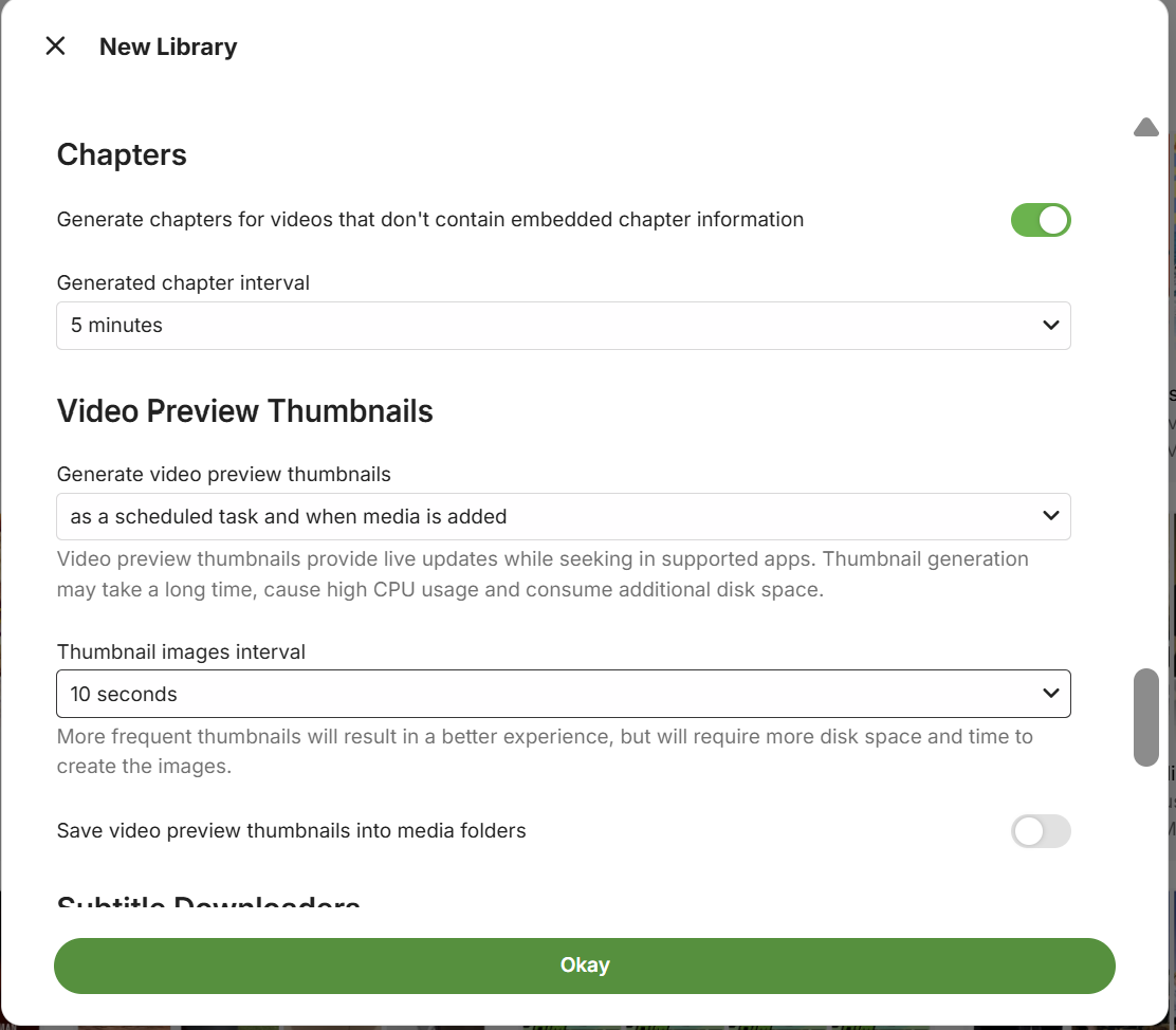

sa2000 703 Posted November 3, 2025 Posted November 3, 2025 (edited) On 29/10/2025 at 04:03, MediaFish said: It does happen on mkv files as well but the primary scenario i care about is recorded tv. I just added an mkv movie and the thumbnails weren't generated. Attached are the log files. Appreciate any pointers as to what I'm doing wrong here. thanks for the help! Was this test for new test library named "Movies" with this media file ? "C:\Media\Movies\Blade Runner (1982).mkv" ? I cannot see any attempt to create thumbs What did you have configured for this test library in the following options? There are 3 different settings here to configure Could you repeat this test but get me screenshot of this So suggest you delete the test library. keep debug logging enabled restart the server and then recreate the test library with the 10 second option for thumbnails and have the library created for this test movie and then capture the logs and attach together with the screenshot to show the library settings that you use for this Edited November 3, 2025 by sa2000

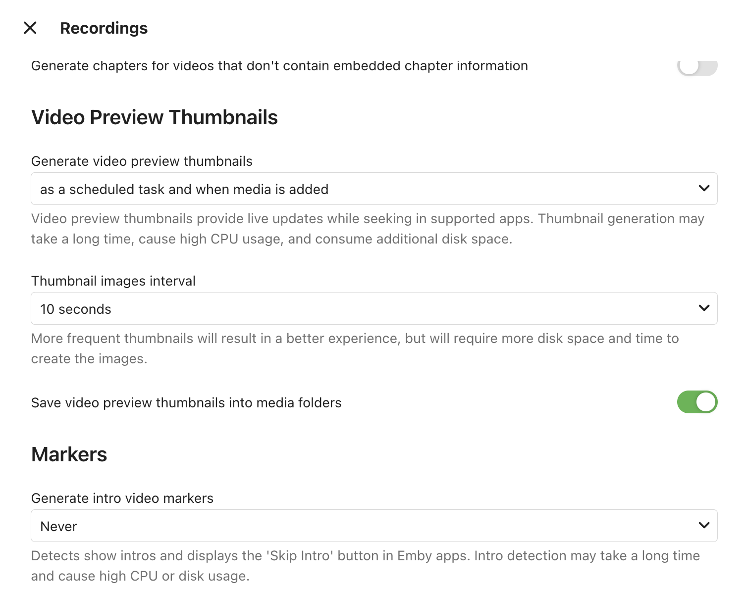

MediaFish 1 Posted November 3, 2025 Author Posted November 3, 2025 Thanks for the reply. You are right! when I set up the new library to test MKC files, I didn't set the options correctly. But still having this issue for TS files coming from an HD Homerun recording live tv. Double checked the library settings there... any clue what might be going on?
sa2000 703 Posted November 3, 2025 Posted November 3, 2025 (edited) 58 minutes ago, MediaFish said: ut still having this issue for TS files coming from an HD Homerun recording live tv. Double checked the library settings there... any clue what might be going on? well ... I do not have an embyserver and quick-extract-imageseries log files from you covering the time of a recording ending and stored into a library that has 10-second thumbnails enabled and created when added to library The earlier log file you provided does not have any recording completing I have just run a test and a .bif file was created for a recording .ts file and placed in a folder under programdata\metadata\library\ Does check that you have the library options correct and that recordings are going into that library, then do a short test recording and get the logs - both the embyserver and quick-extract- log files and you can also view the folders in "C:\Users\Neil\AppData\Roaming\Emby-Server\programdata\metadata" . Sort the explorer view by date and look at most recent and one that coincides with time of recording finishing and then open that folder and again do the same at the level below and sort by date and look at most recent and see if there is a .bif filename for the recording and provide logs and screenshot of the library options for chapters/thumbnails My test was on beta 4.9.2.6 but i do not believe there were any changes in this area after 4.9.1.80 - the one your server is running on Please wait a couple of minutes after recording ends before you check Edited November 3, 2025 by sa2000
MediaFish 1 Posted November 3, 2025 Author Posted November 3, 2025 Great. thank you so much. will do that now and post when i have the logs. 1
MediaFish 1 Posted November 3, 2025 Author Posted November 3, 2025 Here you go... Recorded the news to Recordings library. The library is set for thumbnails. Log files attached. Really appreciate the help with this! embyserver.txt ffmpeg-transcode-e999eab3-3c6d-4f88-a0b2-e165881e8364_1.txt quick-extract-imageseries-83275D406C01_1.txt

MediaFish 1 Posted November 4, 2025 Author Posted November 4, 2025 thank you. but they're not being displayed in the UI (same as initial images). I'm just seeing the time stamp, not the thumbnail
Luke 42288 Posted November 4, 2025 Posted November 4, 2025 46 minutes ago, MediaFish said: thank you. but they're not being displayed in the UI (same as initial images). I'm just seeing the time stamp, not the thumbnail Hi, where are you looking for it?
