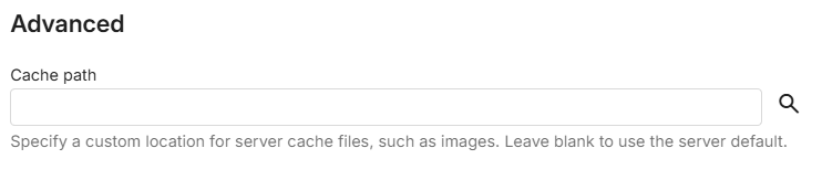

mrmixed 79 Posted October 12, 2025 Author Posted October 12, 2025 Is it necessary to restart the server immediately upon updating the cache path to get it to stick? Or do I need to copy the contents of the original cache location over to the new one every time it is changed? ("Cache" to me sounds as though it is a volatile type of storage that would be capable of rebuilding, but perhaps it's not meant this way in Emby.) I had set it to a local folder: And checking a few hours later, the path I set no longer displays under Server Settings: I made a few changes to poster images just now and I don't see any updated timestamps in my local cache folder, so I assume the setting has reverted. And I guess this is what happened to me a few months ago, too, because I was sure I had set it at one point. In any case I don't want to get into troubleshooting on a feature request post. I was only messing with the settings to try and understand how I might be able to retain an image backup outside of the media folders per my other post. But ultimately my point here is that there are a lot of things that can whack metadata and images in unexpected ways (the 4.9 update alone was a doozy based on single-title-folder metadata changes), and having a bulk "save-everything-exactly-as-it-is-right-now" option to preserve a known good configuration would be quite useful. And hopefully in tandem with choosing a custom path where that file dump can reside.
Luke 42243 Posted October 12, 2025 Posted October 12, 2025 No you don’t have to restart. You don’t have to copy the contents either although you can if you want. 1
