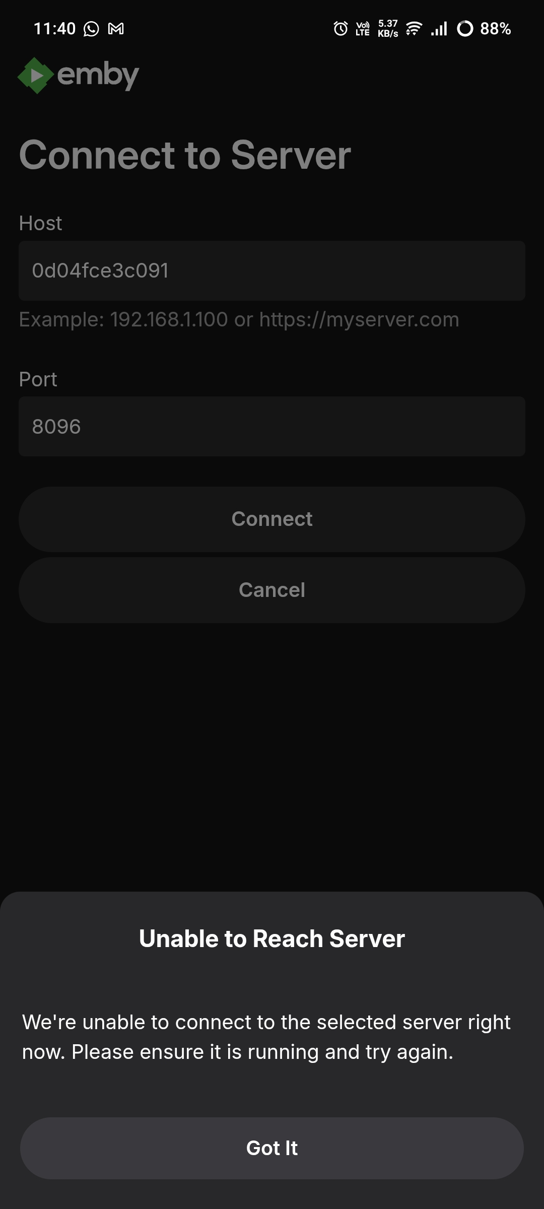

prince740 1 Posted November 15, 2025 Author Posted November 15, 2025 See sir When I try to login it shows server not found How to login that thing only I don't know
pwhodges 2039 Posted November 15, 2025 Posted November 15, 2025 (edited) Have you set up your Emby server on AppBpx yet? EDIT: I guess you have from your first message. Bu when you try to connect, according to your screenshot you have not specified the server's IP address or name, just some code number (presumably an AppBox code) which is not what's needed here. Paul Edited November 15, 2025 by pwhodges

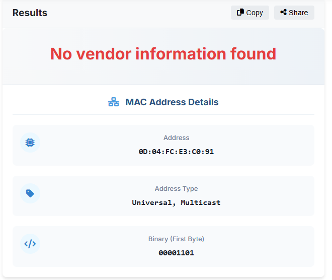

Lessaj 486 Posted November 15, 2025 Posted November 15, 2025 It looks like a MAC address instead of an IP. 1
Neminem 1630 Posted November 15, 2025 Posted November 15, 2025 Jep and I guess its a virtuel mac address, I can't finde the vendor, but that would make sense since its a hosting service.

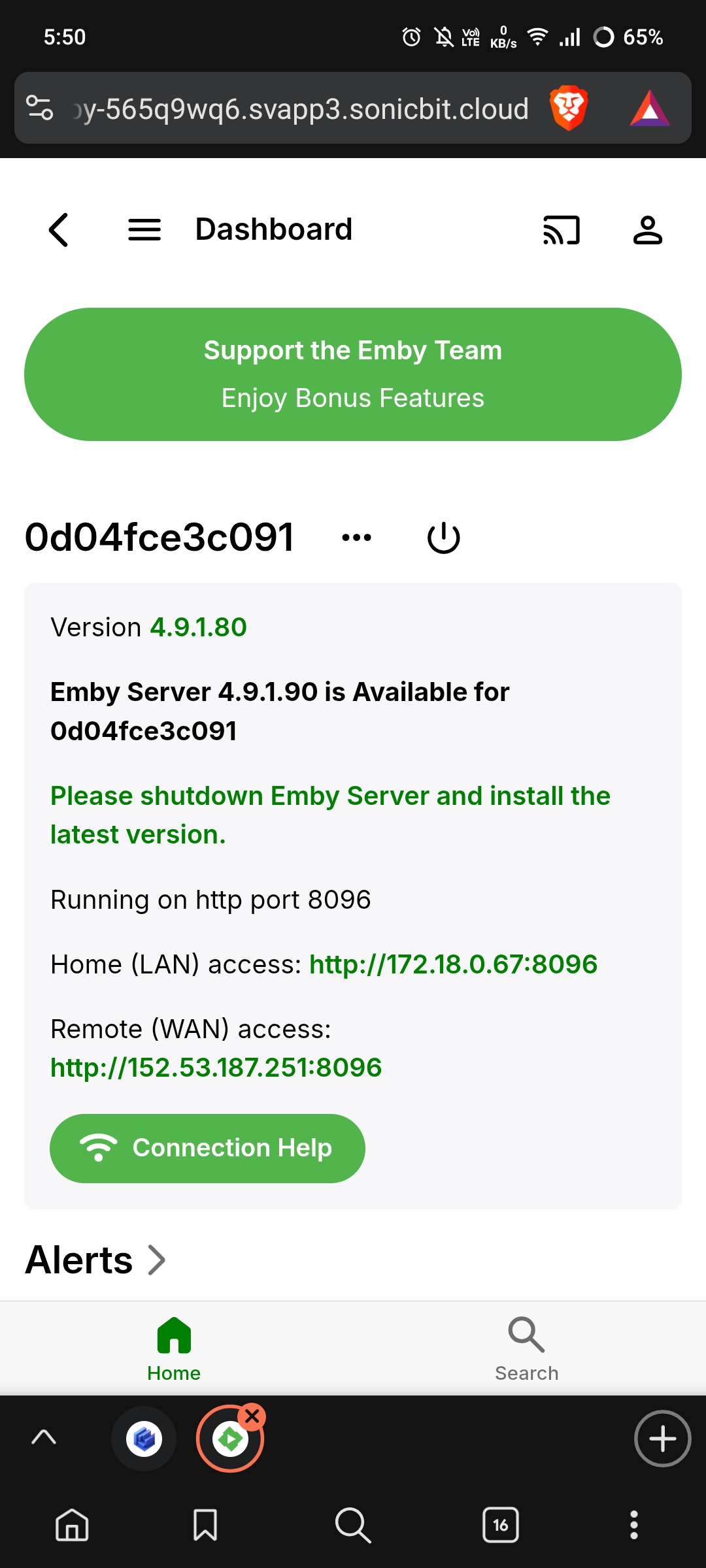

prince740 1 Posted November 16, 2025 Author Posted November 16, 2025 Hi sir Right now I am using other client that is sonicbit Here is the ip address but still when I try to login it doesn't can I dm u?
