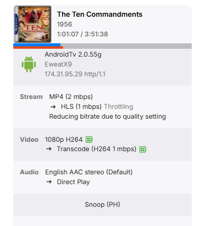

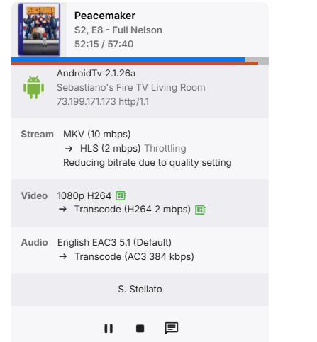

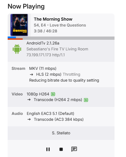

The Mad Titan 6 Posted October 10, 2025 Author Posted October 10, 2025 here is and example... really? Quality setting? this person has an 1200 mbit connection

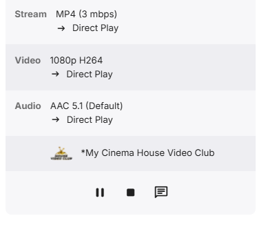

The Mad Titan 6 Posted October 10, 2025 Author Posted October 10, 2025 This one is direct play and it constantly stops and freezes...

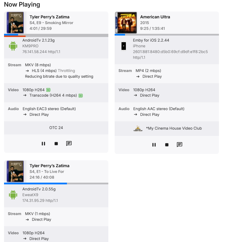

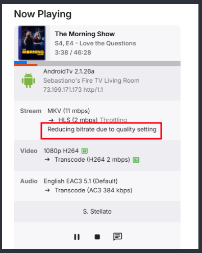

The Mad Titan 6 Posted October 11, 2025 Author Posted October 11, 2025 Even afeter by passing the gateway and going straight to internet (even changing ports and aquiring new ip address), still the same thing. Now here is the weirdness, even after checking all and emby settings. Everything automatically transcode to 2mbit bit rates. It says quality settings (Auto), but when a changed to 20 or 30 mbit it will direct play but with major freezing on my devicce and clients across the board. It's just freaking weird that it is bottlenecked into this 2mbit only transcode to play anything.

The Mad Titan 6 Posted October 11, 2025 Author Posted October 11, 2025 Okay here i another example.. Anything under 3mbit direct plays, but for some reason or another anything over the server wants to transcode, even if bandwith and compatibility is there. I am so sorry to burden the techs. I am just not under standing.
Neminem 1630 Posted October 11, 2025 Posted October 11, 2025 (edited) Auto is ( FUBAR ). This setting is client side, raise it to fit your needs (Client side ) Edited October 11, 2025 by Neminem
