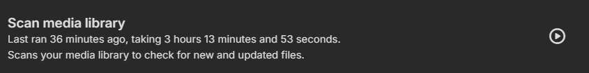

Teddy 100 Posted October 9, 2025 Posted October 9, 2025 I updated to version 4.9.1.80 and for the first scan took 7:29 hours. Subsequent scans after a windows reboot, take around 3 hours, but if I run another scan, they take around 3 minutes. If I don't reboot Windows, the scans last 3 minutes, but after thewindows reboot n, the first scan always takes 3 hours or more. I imagine there's some kind of cache that disappears when Windows restarts, and my question is whether it's possible to keep that cache active so the first scan doesn't take so long after the reboot. (Even if I restart Emby Server, the scan still takes 3 minutes during that Windows session.)

Teddy 100 Posted October 11, 2025 Author Posted October 11, 2025 So, there's no problem either. After restoring Emby Server, the scan only took a little over 3 minutes. That's why I was wondering if Emby Server has some kind of cache for the last scan that can disappear when Windows reboots. I'm also trying to check, since access to the NAS is via WebDAV, if that could be the problem.
Solution Luke 42289 Posted October 11, 2025 Solution Posted October 11, 2025 If you restarted Emby Server then it sounds more like operating system level hard disk caches.
Teddy 100 Posted October 11, 2025 Author Posted October 11, 2025 You're right, Luke. I'll try to investigate whether the problem is with Raidrive (WebDAV) or something else. Thanks so much for your help. 1
