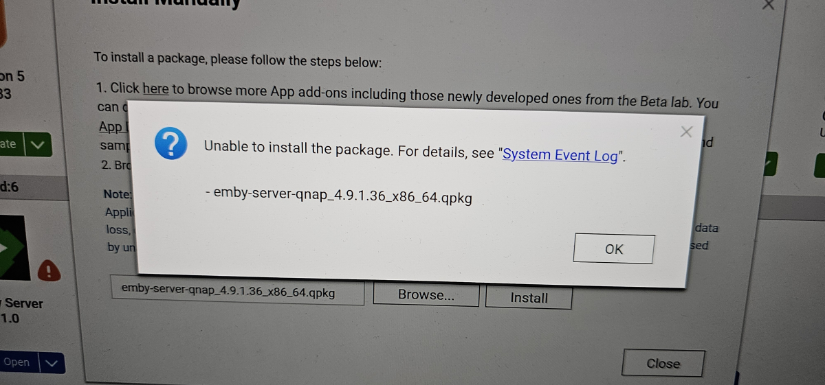

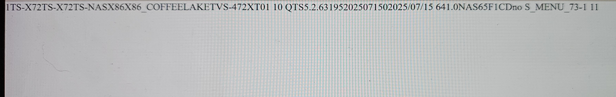

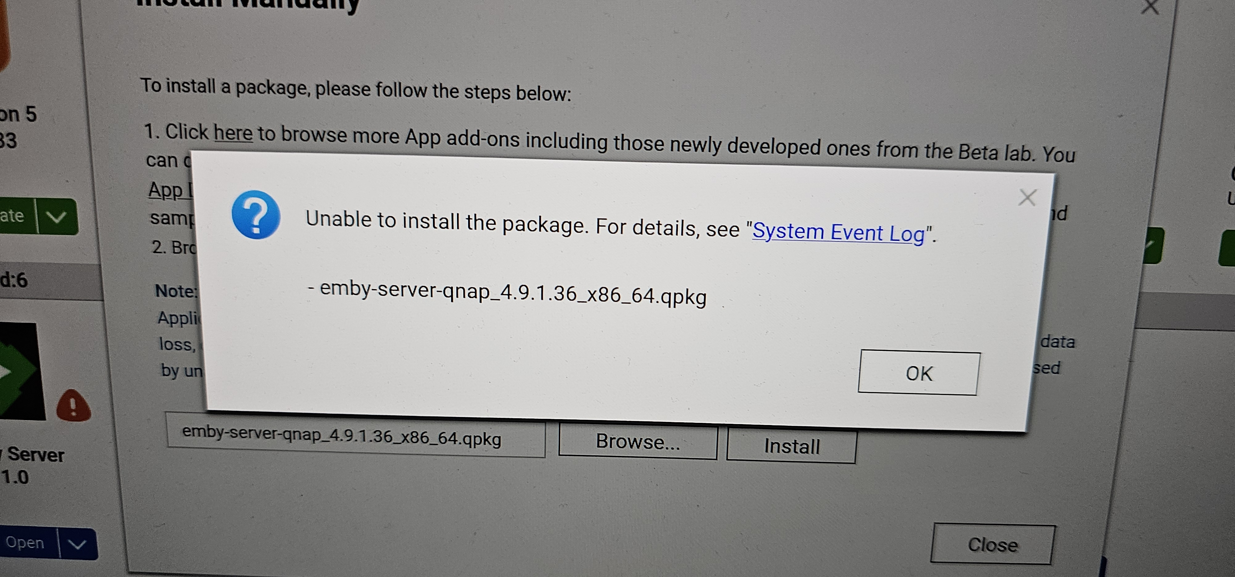

Ford Fairlane 17 Posted October 9, 2025 Posted October 9, 2025 hi just tried to install the latest update on to qnap nas and it fails. just like the way it failed on a previous update. error code appears on web browser page 1TS-X72TS-X72TS-NASX86X86_COFFEELAKETVS-472XT01 10 QTS5.2.631952025071502025/07/15 641.0NAS65F1CDno S_MENU_73-1 11 thanks

fordfairlane 2 Posted October 9, 2025 Posted October 9, 2025 Hi It was as soon as I hit install. Thanks

Ford Fairlane 17 Posted October 9, 2025 Author Posted October 9, 2025 (edited) no fails just like latest update same error on webpage as image two on previous post. this did happen before. but cant recall the build found it Edited October 9, 2025 by Ford Fairlane

Ford Fairlane 17 Posted November 14, 2025 Author Posted November 14, 2025 Hi still the same issue 1TS-X72TS-X72TS-NASX86X86_COFFEELAKETVS-472XT01 10 QTS5.2.732562025091302025/09/13 641.0NAS65F1CDno S_MENU_73-1 11
Ford Fairlane 17 Posted November 14, 2025 Author Posted November 14, 2025 2 hours ago, Ford Fairlane said: Hi still the same issue 1TS-X72TS-X72TS-NASX86X86_COFFEELAKETVS-472XT01 10 QTS5.2.732562025091302025/09/13 641.0NAS65F1CDno S_MENU_73-1 11 uninstalled emby, now i cant reinstall any version tried installing the github repo and still nothing turned off all firewall and security and still fails
Ford Fairlane 17 Posted November 14, 2025 Author Posted November 14, 2025 1 hour ago, Ford Fairlane said: uninstalled emby, now i cant reinstall any version tried installing the github repo and still nothing turned off all firewall and security and still fails *final update* success, having spent the morning going through all different builds and different locations for installing i found the solution. firefox browser was somehow stopping anything from being installed and updated. i tried chrome just based on a guess and latest version installed first time. so back in business, but now have to rebuild all my libarys again. i still dont know why or how firefox was stopping these installs
