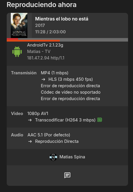

DarkStar1977 132 Posted October 9, 2025 Posted October 9, 2025 (edited) I've updated the server to latest version and this still happens even with Chrome browser. Any plans to solve it ? BTW, after showing the message "No compatible streams available" Emby Server frezes, but not only the app. the entire NAS WDPR4100 is frozen having to push the power button to force a shutdown. I don't know what have been done with this version but is mainly consuming entire CPU and Memory every time that a simple metadata refresh happens, it's not properly optimized fot WD NAS. I'm going to open this in WD forum. Edited October 9, 2025 by DarkStar1977

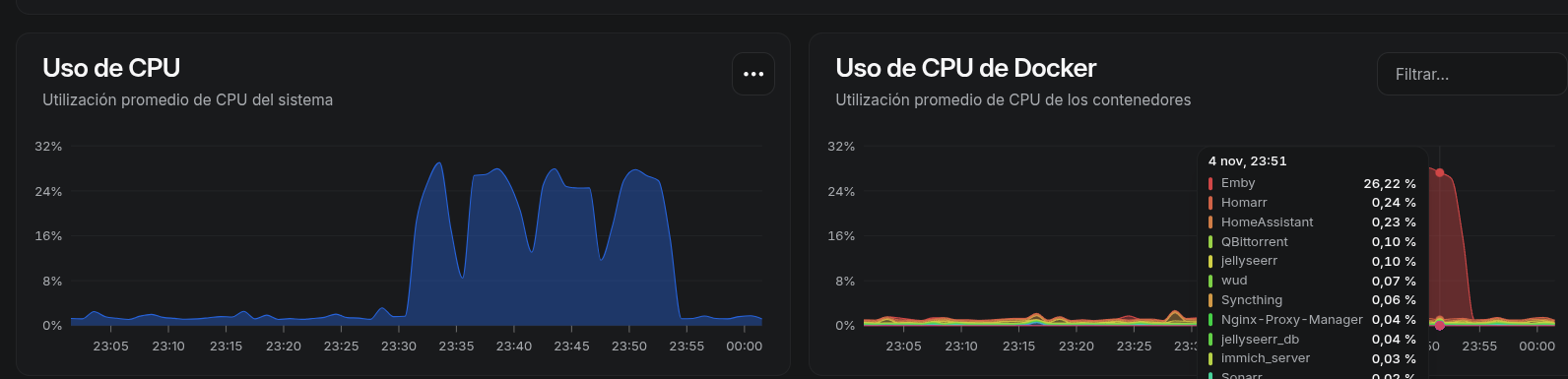

Abejo 15 Posted November 5, 2025 Posted November 5, 2025 I'm also experiencing high CPU usage. A few moments ago, I had a client connected with the Emby app on Android TV, and the CPU usage went above 20%. It was transcoding, but it had never exceeded 4% before. What I did notice is that, unlike before, the transcoding was much faster. I suppose that might be the reason.

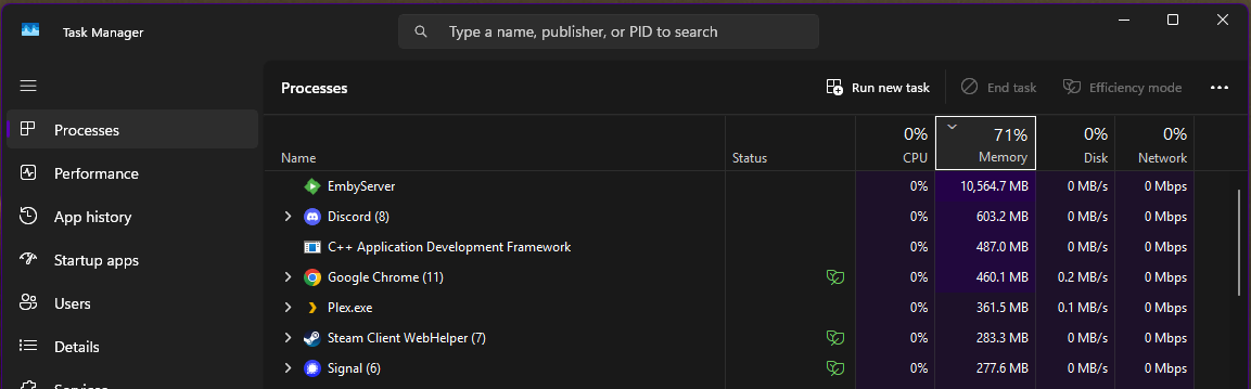

Rumzzz 75 Posted April 19 Posted April 19 (edited) I am also running into high RAM usage, running on version 4.10.0.8 Not sure if my scenario is the same issue, but on startup the Emby process will immediately take up 10GB of RAM and it will stay there regardless of activity. In the past I would typically only see this high of RAM usage during a vacuum, but it would usually return to normal once it was done. Edited April 19 by Rumzzz

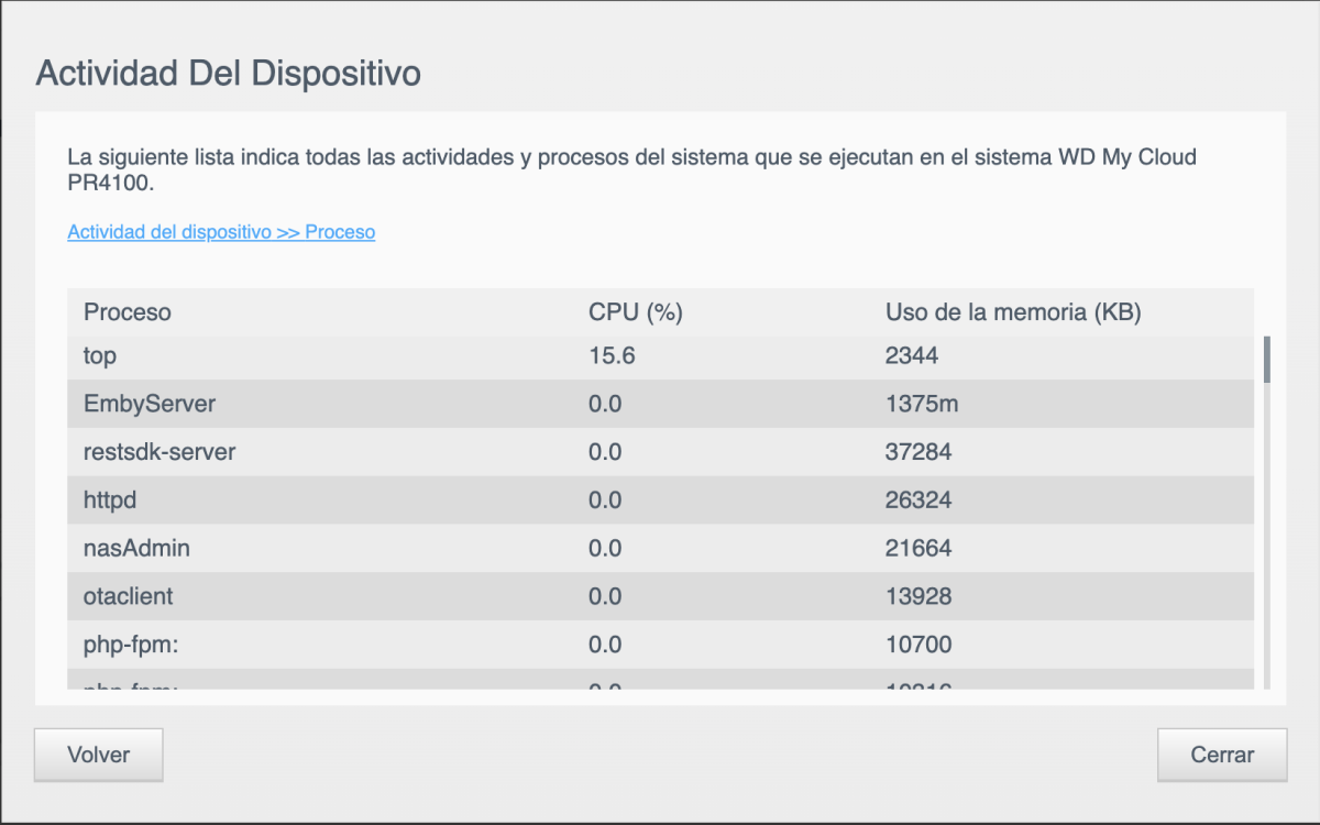

DarkStar1977 132 Posted April 19 Author Posted April 19 (edited) @Rumzzzforget it, the new version is a mess, completely overload a 3K Euro NAS in my case, causing even overheat alerts, not saying just editing any image on any movie or show makes the interface starts spinning and stucked for MINUTES just to add a new background or replace a poster. I had to restart emby service 3 times a day ... just to get back to a normal behaviour. They did not optimized this version for anything that is not Windows with tons of RAM: Below Emby server doing NOTHING and cosuming more RAM than installed, causing disks to not stop never and impossible to go to sleep: If I can rollback to previous version 4.8 I have done it. Not to say that Infuse client works better than AppleTV one ... but this is another discussion. Xing the fingers to get a native WD Jellyfin version soon. Edited April 19 by DarkStar1977

Rumzzz 75 Posted April 21 Posted April 21 Ok so I just realized my RAM usage is only related to when a vacuum is enabled (I forgot I had this setting enabled on every boot). Once disabled, RAM usage goes back to normal (booting/idle at 100MB). @Lukeis it normal for a vacuum boot to reach that high of RAM usage and remain there even at idle? I don't recall that happening in the past. Let me know if I should open a new thread for my issue and include logs.
Luke 43719 Posted April 25 Posted April 25 On 4/20/2026 at 9:55 PM, Rumzzz said: Ok so I just realized my RAM usage is only related to when a vacuum is enabled (I forgot I had this setting enabled on every boot). Once disabled, RAM usage goes back to normal (booting/idle at 100MB). @Lukeis it normal for a vacuum boot to reach that high of RAM usage and remain there even at idle? I don't recall that happening in the past. Let me know if I should open a new thread for my issue and include logs. I don't recall seeing it before, but I'm sure it's possible. The vacuum process has to move quite a bit of data around. It wouldn't surprise me if it puts it in memory temporarily.
Rumzzz 75 Posted May 6 Posted May 6 This happens on every vacuum boot. The ram usage remains this high even after hours of idling. Doing a regular reboot afterwards is the only fix I've found.
Luke 43719 Posted May 6 Posted May 6 1 hour ago, Rumzzz said: This happens on every vacuum boot. The ram usage remains this high even after hours of idling. Doing a regular reboot afterwards is the only fix I've found. How large is your library.db database file?
Rumzzz 75 Posted May 6 Posted May 6 (edited) My library.db file is 4.6Gb. The cache setting under the database section is set to 10000. Edited May 6 by Rumzzz 1
