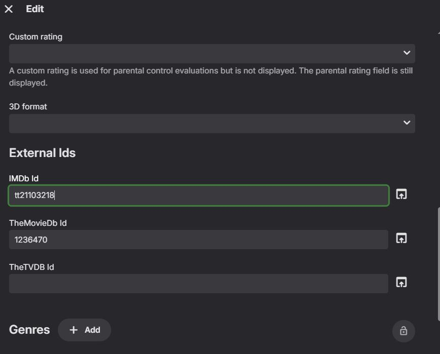

AmericanMike 18 Posted October 8, 2025 Posted October 8, 2025 I am having the same problem and have the same settings as above. I have been testing for a few days now but the problem seems to have appeared after September 26 when I last added a movie and only had to apply the IMDB number to have data and images download successfully. Now now downloads do not happen regardless of which identification number I put in.

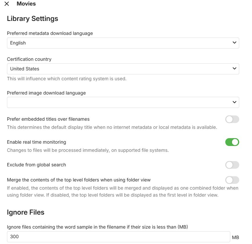

AmericanMike 18 Posted October 10, 2025 Author Posted October 10, 2025 nothing. No error displayed. Just unresponsive. Like I advised, I used to be able to edit the metadata, add the IMDB number, save the data, then refresh including replacing all images and data and that would be it, but the movies I have been adding lately will not update.
Happy2Play 9814 Posted October 10, 2025 Posted October 10, 2025 Have you verified library metadata settings? Have you tried toggling them off then back on? As I don't see any provider queries. All there is, is a bunch of HLS errors between the start and Complete item refresh. No provider info. Line 11333: 2025-10-09 07:55:05.475 Info ProviderManager: RefreshItem Start: 69642560 Movie F:\My Video\The Lost Bus.mp4 Line 11534: 2025-10-09 07:55:05.615 Info ProviderManager: RefreshItem Complete: 69642560 Movie F:\My Video\The Lost Bus.mp4

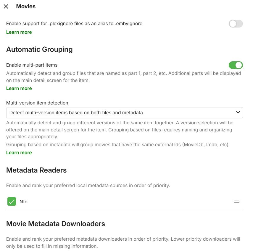

AmericanMike 18 Posted October 10, 2025 Author Posted October 10, 2025 (edited) I have tried logoffs, restarts of the app, reboots of the server, everything. this all started after this recent upgrade. I shared screen shots of my Metadata settings with Luke at the beginning of this thread. what is an HLS error? Edited October 10, 2025 by AmericanMike
Luke 42289 Posted October 10, 2025 Posted October 10, 2025 Actually, where are the screenshots of your metadata settings? I can't find them anymore.
AmericanMike 18 Posted October 10, 2025 Author Posted October 10, 2025 attached. The Library Settings are fresh as right now because I was turning things off and on and wanted to provide most current data.

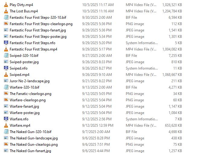

Luke 42289 Posted October 10, 2025 Posted October 10, 2025 What are the contents of the folder that the file is in?
AmericanMike 18 Posted October 10, 2025 Author Posted October 10, 2025 I am not clear on your question......hope this answers it.
Luke 42289 Posted October 10, 2025 Posted October 10, 2025 @AmericanMikeit appears you've added F:\My Video to two different libraries that use two different content types: Library: Movies, id: 1594, CollectionType: , CollapseSingleItemFolders: False Configured paths: Library Folder: My Video, id: 2839: path: F:\My Video Library: Movies, id: 2841, CollectionType: movies, CollapseSingleItemFolders: False Configured paths: F:\My Video Library Folder: My Video, id: 2839: path: F:\My Video This is really only supported when they all use the same content type, and even then, which library options get used? Which library options have you been showing us? So even then, it's really best to make sure the library options are exactly the same. So what I would suggest is picking one of those libraries to keep and then removing the other. Then run a full scan of all libraries. And then after that, then let's re-evaluate the metadata refreshes because then I think we'll see your library options getting utilized.
