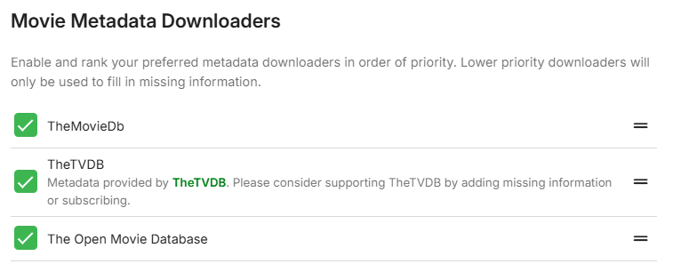

Luke 42288 Posted October 7, 2025 Posted October 7, 2025 Hi, what metadata fetchers are enabled on the library and in what order?

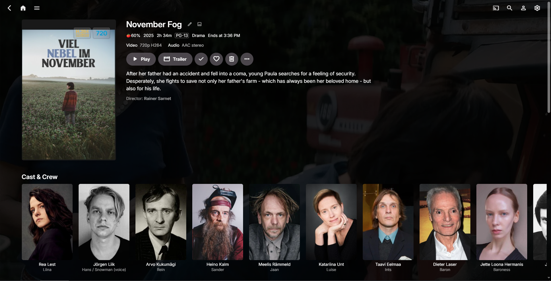

crusher11 1153 Posted October 10, 2025 Author Posted October 10, 2025 (edited) Hmm. Seems it has the correct director and cast, but the wrong artwork, title, overview and release date: It has IMDB ID tt29567915, which doesn't match either film, and its TMDB ID is for November Fog. Edited October 10, 2025 by crusher11
Luke 42288 Posted October 10, 2025 Posted October 10, 2025 OK I would try using the Identify feature and see if that helps. If it doesn't, then try putting Omdb in the middle ahead of tvdb and then try again.

Luke 42288 Posted October 10, 2025 Posted October 10, 2025 2 minutes ago, crusher11 said: That's what I've been doing! OK please attach the log from trying them in that order. thanks.
