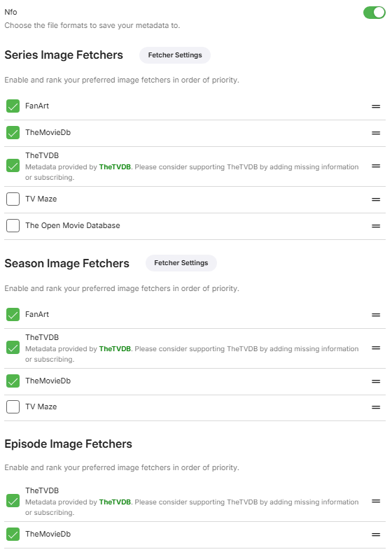

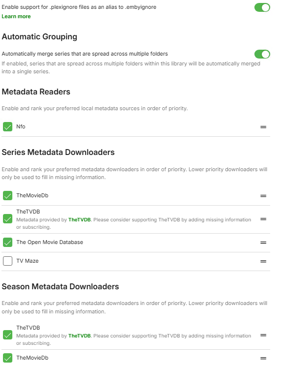

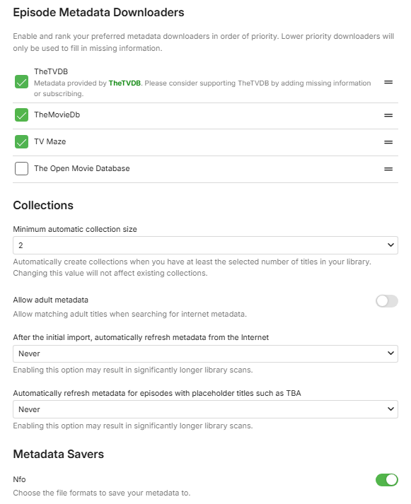

Luke 42289 Posted October 7, 2025 Posted October 7, 2025 HI, can you please show a screenshot of your library options?

Canaletto 3 Posted October 16, 2025 Author Posted October 16, 2025 On 10/9/2025 at 12:42 AM, Luke said: Also have you checked the metadata editor to make sure that metadata isn't locked? In fact, some series have been locked. Why only some, I don't know, and I haven't been able to find any logic behind it. And I'm not entirely sure that it's related to the latest update. embyserver.txt
Luke 42289 Posted October 16, 2025 Posted October 16, 2025 Hi, they are locked because you locked them and forgot that you did that, or something else wrote the nfo file with the lock option applied. Does that help?
