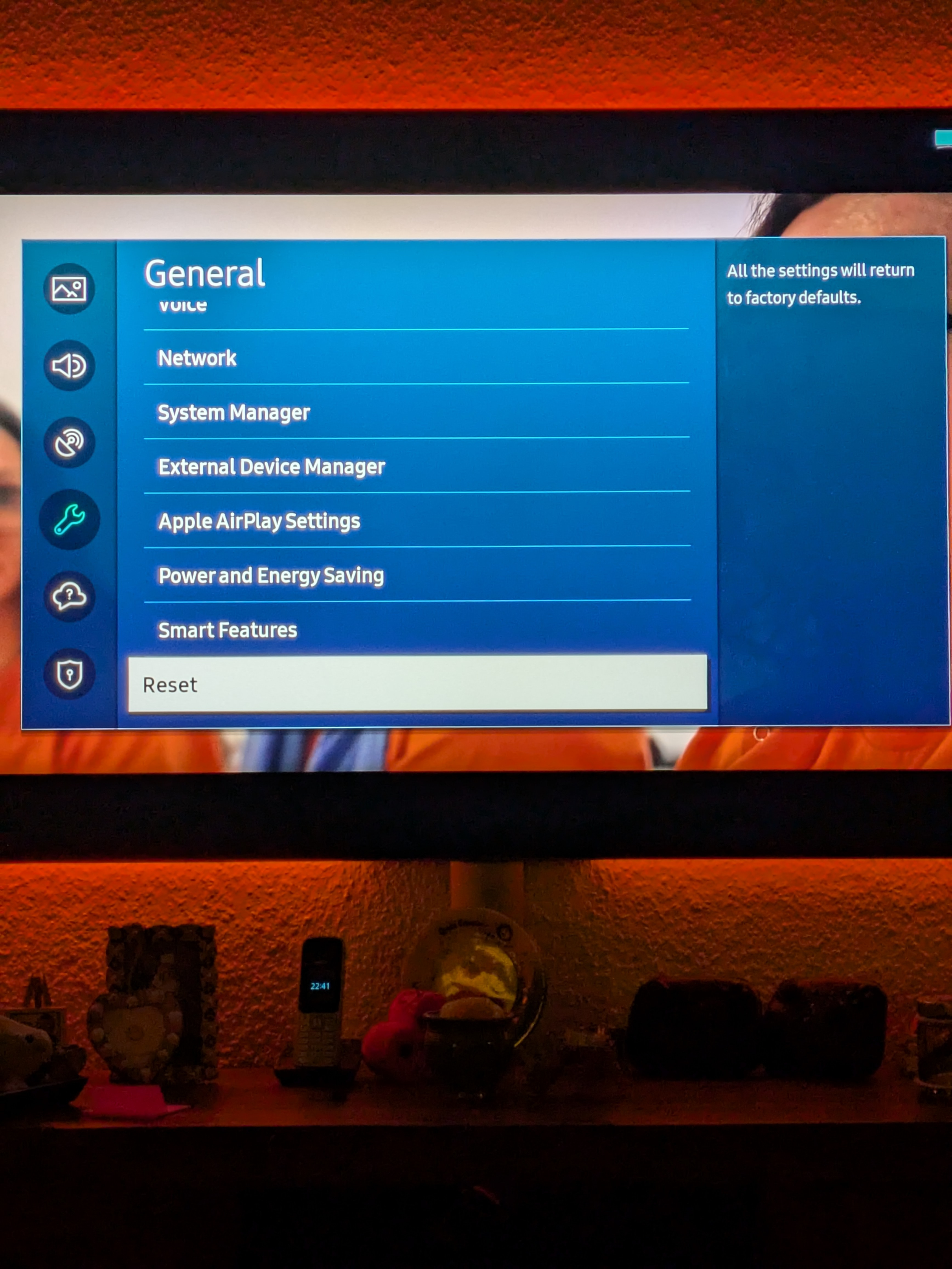

erzonk 21 Posted October 7, 2025 Author Posted October 7, 2025 There ist an Option in the TV menu that means "reset". After that all settings of the TV was Like i installed the First time. All Apps, channels settings and adjustments and so on. The TV startet with the First time Setup. So i thought everything was reset and erased.
SamES 1084 Posted October 8, 2025 Posted October 8, 2025 12 hours ago, erzonk said: There ist an Option in the TV menu that means "reset". After that all settings of the TV was Like i installed the First time. All Apps, channels settings and adjustments and so on. The TV startet with the First time Setup. So i thought everything was reset and erased. I'm surprised a full reset didn't resolve it, but it's possible that resetting to factory defaults doesn't properly uninstall apps and clear all of its settings. Glad the uninstall/reinstall fixed it. 1
erzonk 21 Posted October 8, 2025 Author Posted October 8, 2025 (edited) That surprises me too. What I noticed was that after unplugging the power plug for 15minutes, I had to agree to the cookie guidelines again on various television channels. That wasn't the case after the full reset. The next time I do a full reset, I also pull the power plug for a few minutes. It might be a good idea for all devices that can be reset. Edited October 8, 2025 by erzonk 1 1
