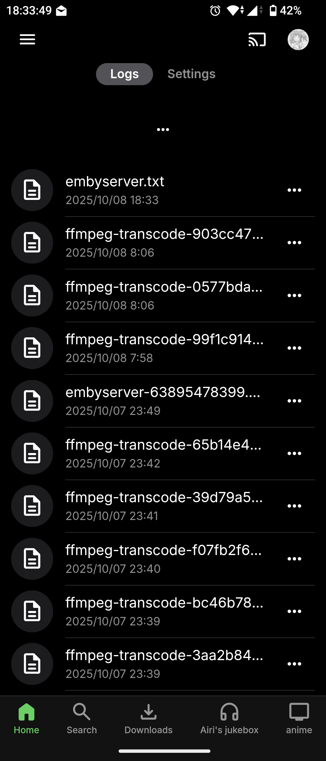

keinishi72 2 Posted October 8, 2025 Author Posted October 8, 2025 It appears that no logs were generated for the time of the crash.

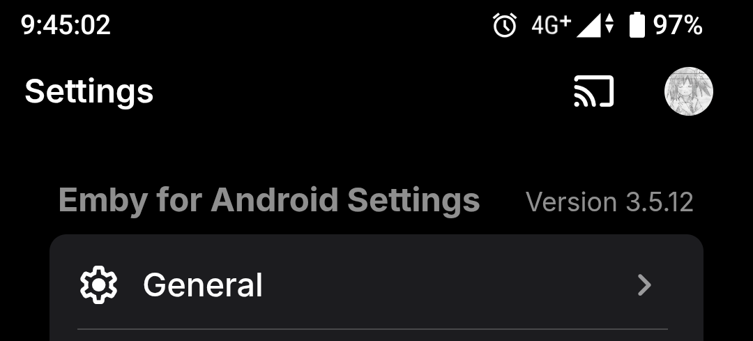

keinishi72 2 Posted October 9, 2025 Author Posted October 9, 2025 (edited) I installed it, but the issues not resolved. The ffmpeg logs are still not being output. Edited October 9, 2025 by keinishi72

keinishi72 2 Posted October 9, 2025 Author Posted October 9, 2025 Android client (ver.3.5.12) logs here. Thanks for investigating. emby_android_1759978453921.txt emby_android_1759978470730.txt
