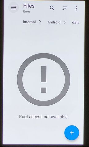

dmarshl 0 Posted October 14, 2025 Author Posted October 14, 2025 Thanks again, Luke. Unfortunately, Google Files was unable to grant permission. See attached screenshot. I've tried CxFile Explorer, TVBro, and Solid Explorer, all with the same result. Seems I'm stuck between a rock and a hard place. Are there any other suggestions for solving this?

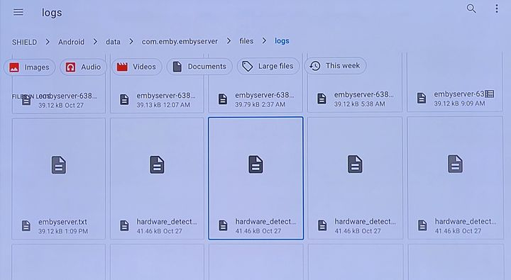

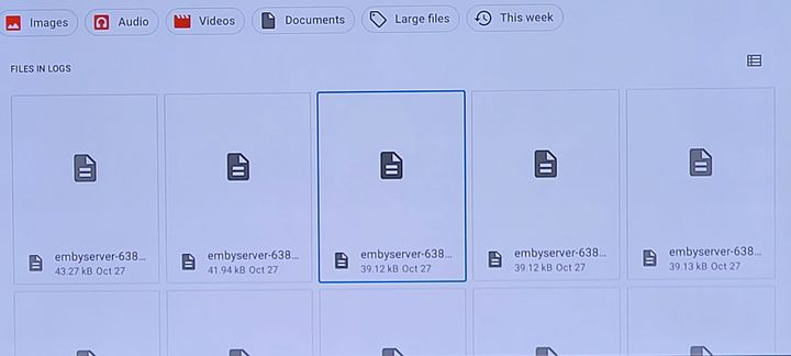

dmarshl 0 Posted October 28, 2025 Author Posted October 28, 2025 Hi Luke, thanks for following up. I've made some progress getting to the log files. I finally found a file manager that was able to access the shield/android/data folder (screen shots attached). Now I have to find a way to copy them out of that folder so I can send them to you, as I assume you need to read them.
