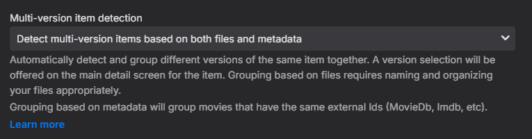

familiezufall 2 Posted October 6, 2025 Author Posted October 6, 2025 (edited) Ich habe den Fehler gefunden. Ich hatte den Film schon in der Bibliothek mit einer anderen Tonspur. Emby hat daraus einen Film gemacht, man muss direkt im Film zwischen den Versionen umschalten. Habe jetzt die alten Versionen gelöscht und von den neuen Versionen die nfo und habe neu gescrappt. Auf jeden Fall muss das seit der neuesten Version geändert worden sein, habe das sonst immer so gemacht. Habe jetzt geschaut bei meinen alten Filmen, alle Filme wurden zu einem Film gruppiert, kann man das wieder ändern? Edited October 6, 2025 by familiezufall
Happy2Play 9814 Posted October 6, 2025 Posted October 6, 2025 1 minute ago, familiezufall said: In any case, this must have been changed since the latest version, I always did it that way. Yes multi-version in different folder is in the server core now per library setting.

Happy2Play 9814 Posted October 6, 2025 Posted October 6, 2025 Just now, familiezufall said: ok, where can I undo this and use the previous state again? Go to each Movie Library and change the drop-down option to None.
familiezufall 2 Posted October 6, 2025 Author Posted October 6, 2025 ich habe das jetzt auf "keine" gestellt und den Server neu gestartet. Werden die Filme jetzt wieder in Einzelfilme angezeigt?
Happy2Play 9814 Posted October 6, 2025 Posted October 6, 2025 7 minutes ago, familiezufall said: I have now set this to "none" and restarted the server. Will the films now be displayed in single films again? Personally have not tested but don't believe disabling the option will change anything already merged. @Lukewhat would be the process unmerge content like this? Remove and readd / manually split apart / a library Refresh

Happy2Play 9814 Posted October 6, 2025 Posted October 6, 2025 A specific example may be needed as Emby will use the library setting on import. So with it set to none and media in different locations it will not merge them as only a plugin would do this previously. Dev will have to confirm but think one will have to manually split apart or remove and readd library if imported and merged already.
Luke 42289 Posted October 10, 2025 Posted October 10, 2025 On 10/6/2025 at 2:29 PM, Happy2Play said: Personally have not tested but don't believe disabling the option will change anything already merged. @Lukewhat would be the process unmerge content like this? Remove and readd / manually split apart / a library Refresh Most library options require a metadata refresh after changing, but this one actually should be OK with just a regular library scan.
Luke 42289 Posted October 10, 2025 Posted October 10, 2025 hi @family coincidencedid you run a library scan after changing the option?
