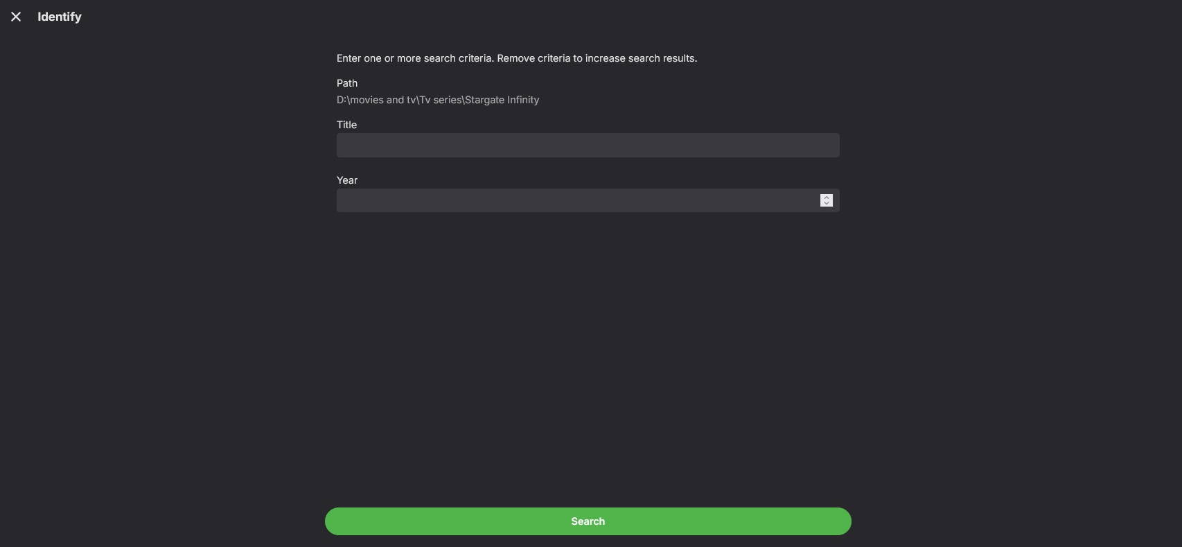

Rickradchak 1 Posted October 6, 2025 Posted October 6, 2025 So when I try to identify a tv show I don't get the same imdb, tvdb, themoviedb options as when I try to identify a movie. This just started last night/yesterday. No idea what's going on, or why this would be behaving this way. I'm using standard file structure TVSHOWS>name>season>episodes With standard file names and this has only been an issue for the past 11 shows I've since added.

Solution GrimReaper 4926 Posted October 6, 2025 Solution Posted October 6, 2025 3 hours ago, Rickradchak said: So when I try to identify a tv show I don't get the same imdb, tvdb, themoviedb options as when I try to identify a movie. This just started last night/yesterday. No idea what's going on, or why this would be behaving this way. I'm using standard file structure TVSHOWS>name>season>episodes With standard file names and this has only been an issue for the past 11 shows I've since added. Check that your TV shows library meta-providers did not get unticked/disabled; if they're still checked, try unticking/ticking them back again. 1
Rickradchak 1 Posted October 6, 2025 Author Posted October 6, 2025 What settings would I find that under?
GrimReaper 4926 Posted October 6, 2025 Posted October 6, 2025 Where you configured your library initially: Settings>Library tab in the sidebar>Edit desired library. 3

Happy2Play 9814 Posted October 6, 2025 Posted October 6, 2025 Primary give away was no providers listed in your identify image and there are a couple topics with this issue now. 1
