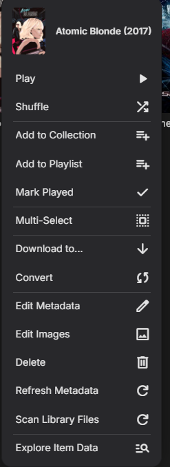

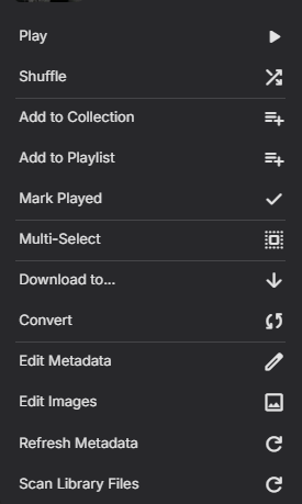

Ronstang 294 Posted October 6, 2025 Posted October 6, 2025 There is no longer an option to identify movies when you right click on a movie that is not identified correctly. No option at all. These are all the options that are available. It's just gone. 1
GrimReaper 4926 Posted October 6, 2025 Posted October 6, 2025 (edited) Just to get basics out of the way: which library meta-providers you have enabled? Are they ticked (maybe they got disabled on update)? If you untick/tick them again, does the same occur? Edited October 6, 2025 by GrimReaper

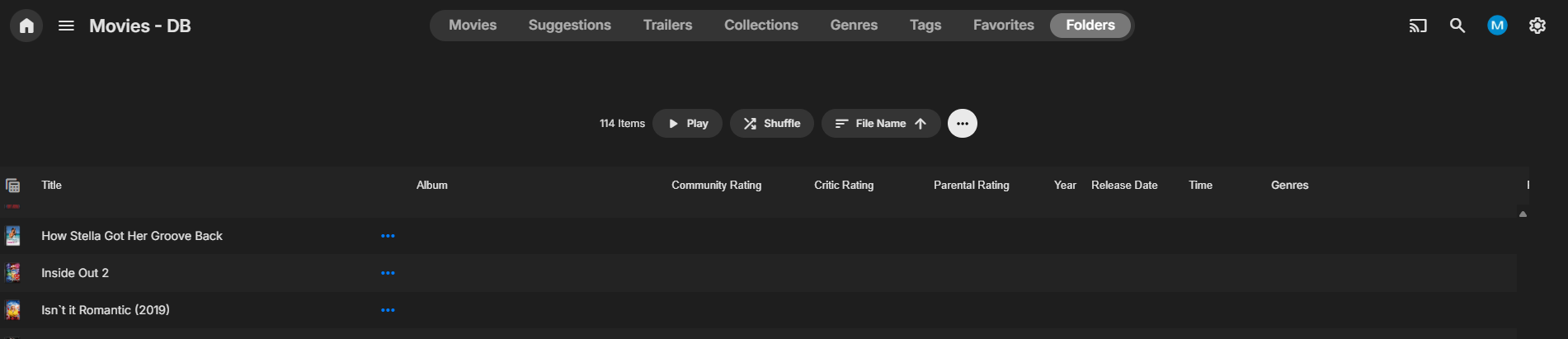

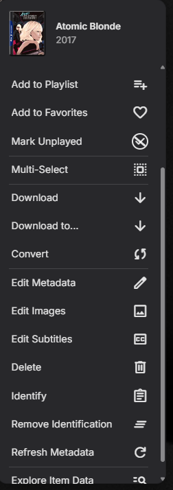

Happy2Play 9814 Posted October 6, 2025 Posted October 6, 2025 A wild guess is you cannot Identify a folder you can only identify actual media. So the question is in what view are in? Folder view Actual Media View after scrolling the context menu 2
Ronstang 294 Posted October 6, 2025 Author Posted October 6, 2025 Ok, what's this folder view BS and how do I turn it off? That seems to be the problem and I don't understand the purpose of "folder view" to begin with. 4
Happy2Play 9814 Posted October 6, 2025 Posted October 6, 2025 You can't as it is a change to how folders view is presented. 2
Ronstang 294 Posted October 6, 2025 Author Posted October 6, 2025 2 minutes ago, Happy2Play said: You can't as it is a change to how folders view is presented. What? Why on earth would you add another layer I have to click through for no reason? What is it's purpose other than to be annoying? 3
Happy2Play 9814 Posted October 6, 2025 Posted October 6, 2025 It is to try and better represent actual folder structure as it really was never supposed to be the same as the movies tab collapsed view. 2
Happy2Play 9814 Posted October 6, 2025 Posted October 6, 2025 (edited) But in the end a lot of users are not liking but not much was ever really said in the almost 7 months in beta. Really it should be designed only affect nested items as all single item folder should be presented collapsed. The user display option sort of does that but as you mentioned options are not present for the folder layer along with all the other "Show Fields" options as you are currently looking at a folder so Folder View sort of loses most metadata functionality to a point. example since they are folders no metadata It has a lot to do with the somewhat elimination of CollapseVideoFolders/CollapseSingleItemFolders settings and why lots of user libraries are getting reset/rebuilt. Edited October 6, 2025 by Happy2Play
