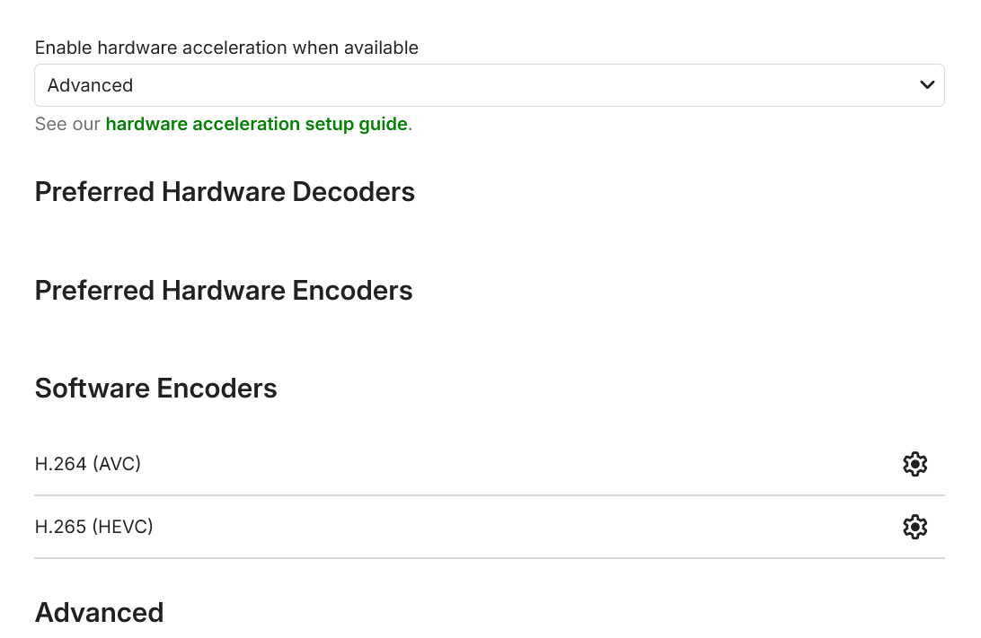

mrjay42 5 Posted October 5, 2025 Author Posted October 5, 2025 Oh actually, I opened the "advanced" option in the select menu in the "transcoding" menu in the settings of Emby and I have this: I'm relatively confident that it means that no hardware option is available

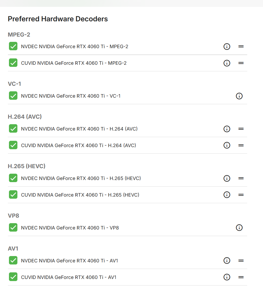

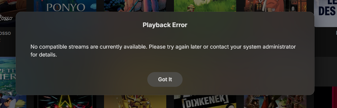

mrjay42 5 Posted October 6, 2025 Author Posted October 6, 2025 (edited) UPDATE I managed to have the transcoding options visible as in the screenshot below (I clicked all the options available, not knowing what's best) And the GPU 'seems' to be used by Emby for transcoding. BUUUUUUUUUUUUUUUUUUUUUUUUUUUUT -> now all my media crash when I try to play them with transcoding They crash like this: I have included the logs from Emby and ffmpeg, corresponding to the time/date of when I'm doing my tests. ...help? EDIT: I forgot to say that I managed to have the transcoding options and the GPU to be "hit" by Emby by adding the following to my docker compose yml in Portainer : deploy: resources: reservations: devices: - driver: nvidia count: all capabilities: [gpu] So the complete file looks like this: version: "3.9" # must be 3.x, deploy is ignored in 2.x services: emby: image: emby/embyserver container_name: embyserver2 networks: - private_secured_network environment: - UID=1000 - GID=1000 - GIDLIST=1000 - NVIDIA_VISIBLE_DEVICES=all - NVIDIA_DRIVER_CAPABILITIES=compute,utility,video volumes: - /home/mrjay/Desktop/apps/emby2:/config - /home/mrjay/Desktop/data/Downloads/transmission/completed:/mnt/share1 ports: - "8097:8096" - "8921:8920" deploy: resources: reservations: devices: - driver: nvidia count: all capabilities: [gpu] restart: on-failure networks: private_secured_network: external: true ffmpeg-transcode-05fc98cf-be40-45af-adc2-62c8cc591d21_1.txt ffmpeg-transcode-5d98f451-f201-4394-a061-b179ce92a540_1.txt ffmpeg-transcode-38db3eb0-fc78-4279-bea5-c69ea3a50127_1.txt ffmpeg-transcode-41010e05-a14b-4d2e-9efc-0ba0c67a1306_1.txt ffmpeg-transcode-aea280da-cea3-42d6-a715-8348787d1fee_1.txt ffmpeg-transcode-b56efd52-83a5-4711-b608-28d716a19663_1.txt embyserver.txt Edited October 6, 2025 by mrjay42 adding yml docker compose info

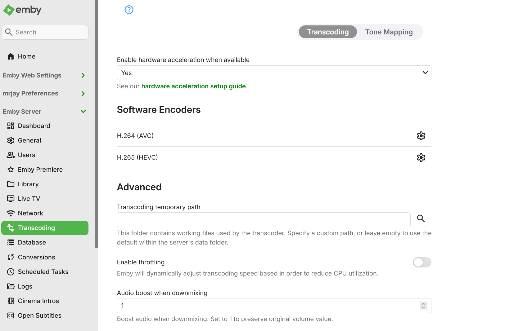

Solution mrjay42 5 Posted October 6, 2025 Author Solution Posted October 6, 2025 (edited) Oh well, after a reboot. I discovered that my nvidia drivers had been disabled Probably because I'm running a Debian testing on my server and the headers were not 'easily' available with that newest Kernel, and as a consequence NVidia drivers had trouble being installed/enabled. So this is what I did Fix “NVIDIA-SMI has failed because it couldn’t communicate with the NVIDIA driver” on Debian (kernel 6.16+) Problem After a reboot, you run: nvidia-smi and get: NVIDIA-SMI has failed because it couldn't communicate with the NVIDIA driver. Make sure that the latest NVIDIA driver is installed and running. This usually happens right after a kernel update, when the NVIDIA kernel module wasn’t rebuilt for the new kernel. Step-by-step fix Check if the NVIDIA module is loaded lsmod | grep nvidia If there’s no output, try loading it: sudo modprobe nvidia If you get: modprobe: FATAL: Module nvidia-current not found in directory /lib/modules/6.x.x → it means the kernel module isn’t built for your new kernel. Check your NVIDIA driver installation dpkg -l | grep nvidia-driver You should see something like: ii nvidia-driver 550.163.01-3 amd64 NVIDIA metapackage If it’s missing, install or update it: sudo apt install nvidia-driver Identify your current kernel uname -r Example: 6.16.9+deb14-amd64 Install the matching kernel headers Without headers, DKMS (which builds the NVIDIA module) can’t compile anything. sudo apt install linux-headers-$(uname -r) If that fails with “Unable to locate package”, update your sources and retry: sudo apt update sudo apt install linux-headers-$(uname -r) should see packages like: linux-headers-6.16.9+deb14-amd64 linux-headers-6.16.9+deb14-common linux-kbuild-6.16.9+deb14 Rebuild the NVIDIA DKMS module Once headers are installed: sudo dkms autoinstall You should see: Building for 6.16.9+deb14-amd64 DKMS: install completed. This compiles and installs: /lib/modules/$(uname -r)/updates/dkms/nvidia-current.ko.xz Load the driver manually (to test) sudo modprobe nvidia nvidia-smi If you see your GPU table — success! Reboot and verify Finally, reboot once: sudo reboot After booting: nvidia-smi If it still works right away, your system is fully fixed — DKMS will automatically rebuild the module on future kernel updates. Quick Recap Command Purpose `lsmod grep nvidia` sudo modprobe nvidia Try to load module manually sudo apt install linux-headers-$(uname -r) Install kernel headers sudo dkms autoinstall Rebuild NVIDIA kernel module sudo modprobe nvidia && nvidia-smi Test driver sudo reboot Verify persistence after restart Tested environment Debian Trixie/Sid Kernel: 6.16.9+deb14-amd64 Driver: nvidia-driver 550.163.01-3 GPU: NVIDIA GeForce RTX 4060 Ti Now, with this correction and the aforementioned (in the first post on this topic) packages and the correct docker compose yml code (in the previous post just before this one) -> everything works Edited October 6, 2025 by mrjay42 small correction 1
