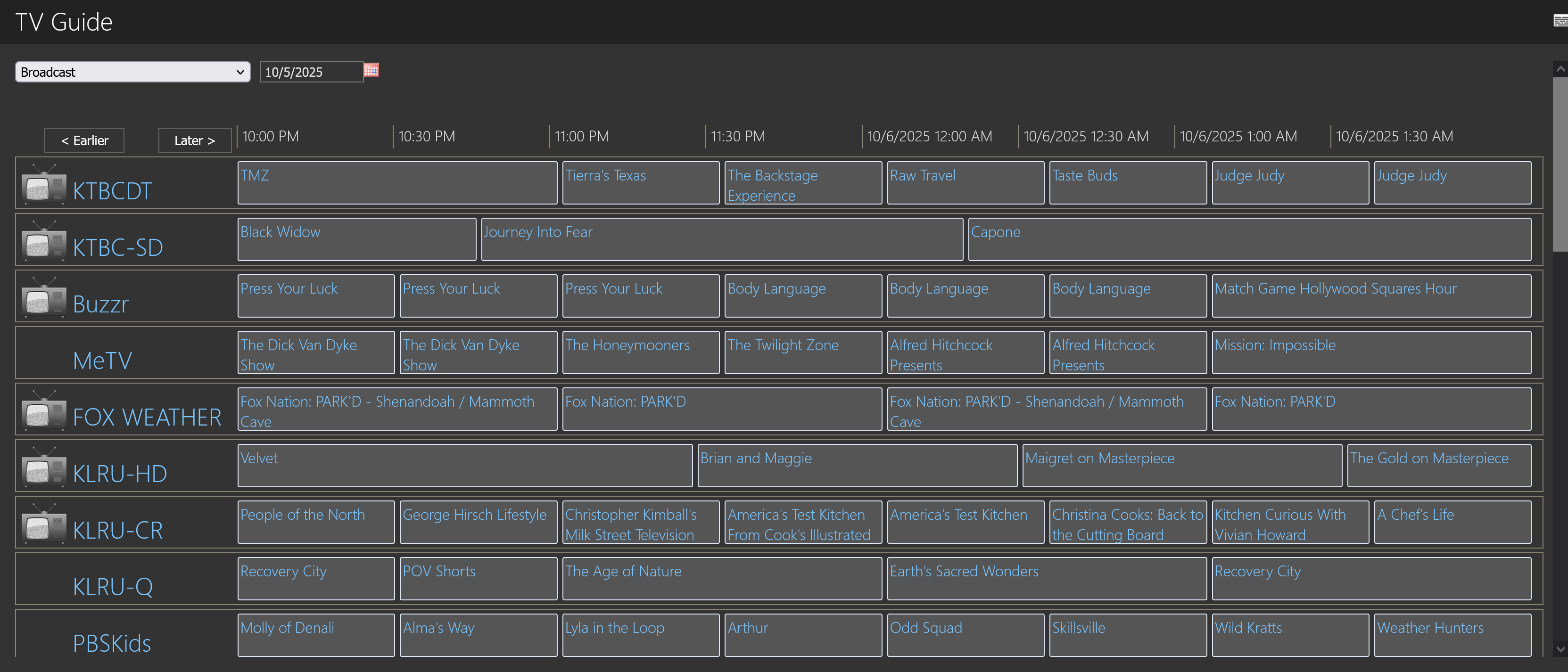

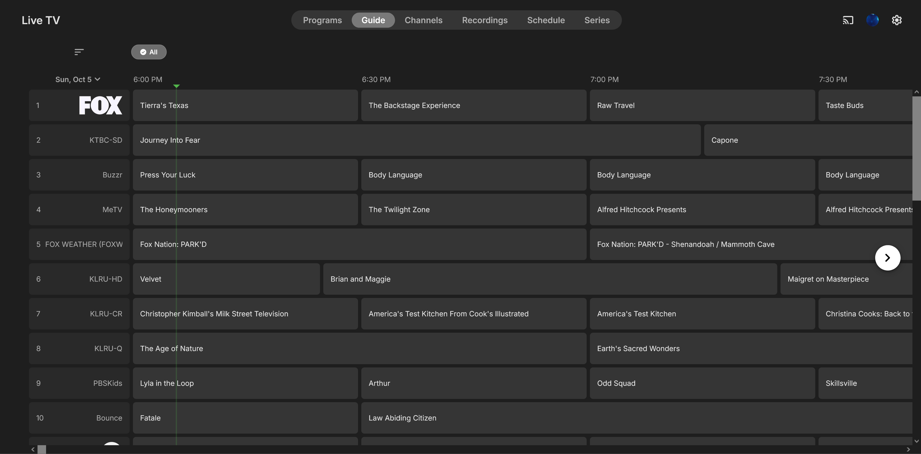

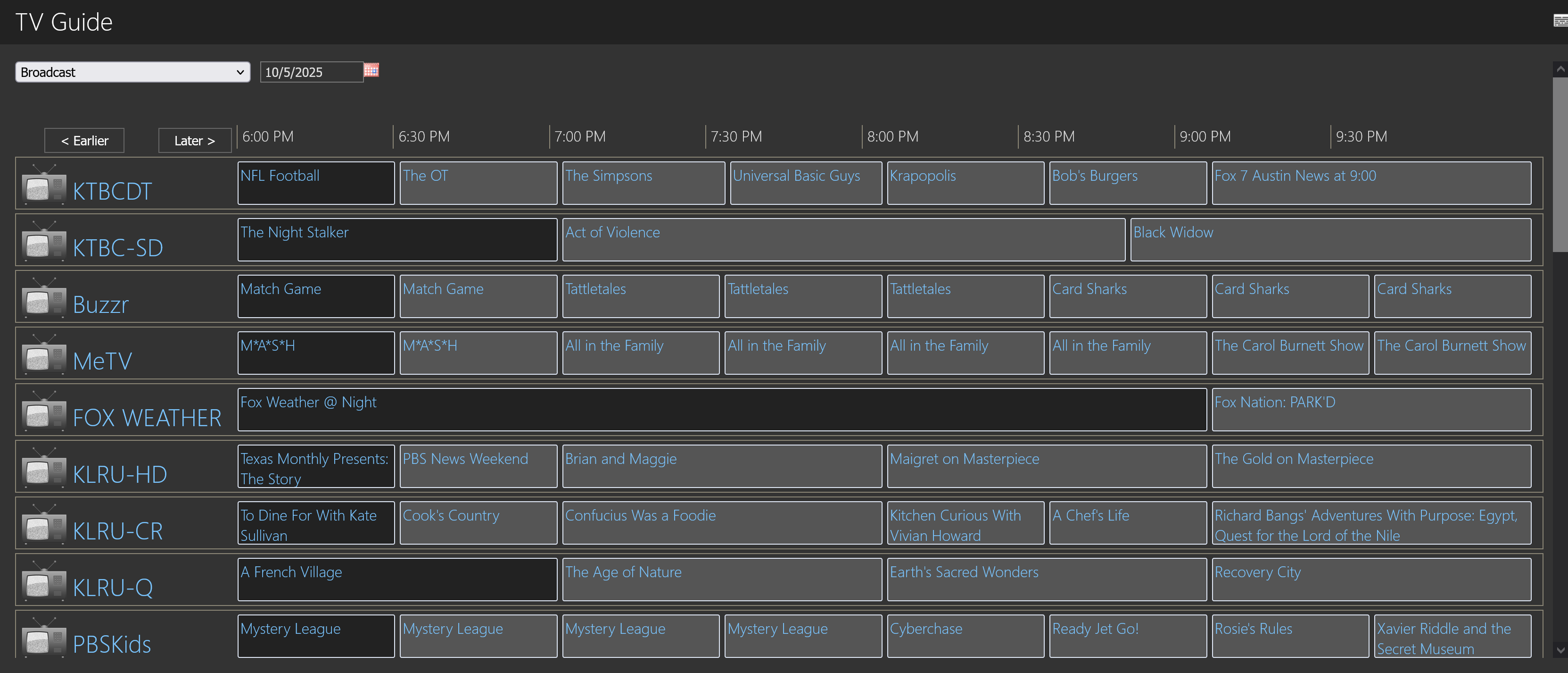

leetxjd 5 Posted October 5, 2025 Posted October 5, 2025 I uninstalled my Mediaportal LiveTV plugin for Emby attempting to successfully stream LiveTV to my Emby AppleTV (It only plays in 3 second intervals). It works on my android device - so I have given up on Apple LiveTV. I have now caused a different problem. My Emby guide - through the Media LiveTV plug-in - after re-installation is now 4 hours off. In other words, shows that will be on 4 hours from now are presented as currently available. The mediaportal guide and webmediaportal guide are correct. So, somehow the Emby guide or the Mediaportal plugin for Emby has the wrong time. The machine the server is on has the correct time AND the EMBY logs are all reporting the correct time. It is just that the guide data is not being presented correctly. Any ideas? -LeeTXJD
Luke 42234 Posted October 5, 2025 Posted October 5, 2025 Hi, have you checked the time zone settings of the client devices to ensure they are correct?
leetxjd 5 Posted October 5, 2025 Author Posted October 5, 2025 (edited) Yes - on three devices. All of those devices are the right time and time zone (On the iPad and PC, I even set the timezone manually). The guide is displayed inaccurately on each. -LeeTXJD Edited October 5, 2025 by leetxjd
Luke 42234 Posted October 5, 2025 Posted October 5, 2025 HI there, can you please provide a specific example? How to Report a Problem Thanks !
leetxjd 5 Posted October 5, 2025 Author Posted October 5, 2025 I have attached my serverlog and three snapshots demonstrating that Mediaportal has the correct guide, but the Emby guide is time shifted. If you need another log for the Mediaportal plugin (which I don't know about) let me know. And again - this started when I uninstalled my Mediaportal LiveTV plugin and then re-installed it. -LeeTXJD embyserverlog.txt
