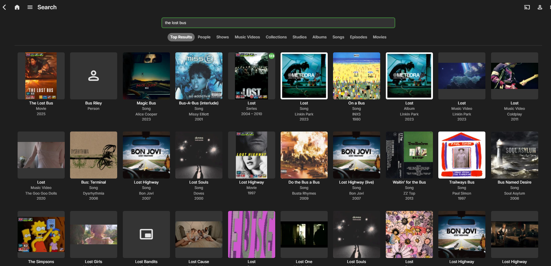

Painkiller88 250 Posted October 3, 2025 Posted October 3, 2025 (edited) I checked the above Points on my Server with win 11 and this is my conclusion: 1. Identify on the context menu.... Where is the search by IMDB ID # or TMDB ID#????.... Unable to reproduce 2. Search is a little bit better. But wow. I used to search for a full name and get maybe 1 or 2 results. ... Yes, the "improved" multi word search is not workin for me, i searched for "the lost bus" and i got all results with just the word "lost" so this is no improvement to me and not taking the full phrase to search. In this point kbeck is right. 3. The link to the Emby Premiere icon is broken when you view the Dashboard from a networked computer. Pic below. Unable to reproduce So the only point i can confirm is the multi word search is not what i expected and i would say it is worser than it was on the old version BTW: no tags disappeared for me, but i got one more because some "theme song" i download using the theme song plugin had a tag or an entry on "grouping" but i removed this and everything is fine, all my tags are still here, but i recorgnized, that the item number on the Tag Items are no longer there. So E.G i have a TAG 4K on all my 4k movies, and i can now no longer see how many 4k movies i have with this tag, this is something i saw before. Edited October 3, 2025 by Painkiller8818
crusher11 1153 Posted October 3, 2025 Posted October 3, 2025 On 10/2/2025 at 7:43 AM, kbeck said: 2. Search is a little bit better. But wow. I used to search for a full name and get maybe 1 or 2 results. I tried Herschell Gordon Lewis.....There's maybe 1 guy in all of history named that. What did I get??? 977 results in just People. Nine hundred and seventy seven results. Luckily the correct search was listed first but the visual garbage..... is stunning. I thought the idea I search was the more you put in the narrower the results became. I tried just Herschell and got 5 results total. I guess less is more. Yeah, it's now returning all results that include any of the words you search for, instead of all of them. It makes search utterly useless in many situations.

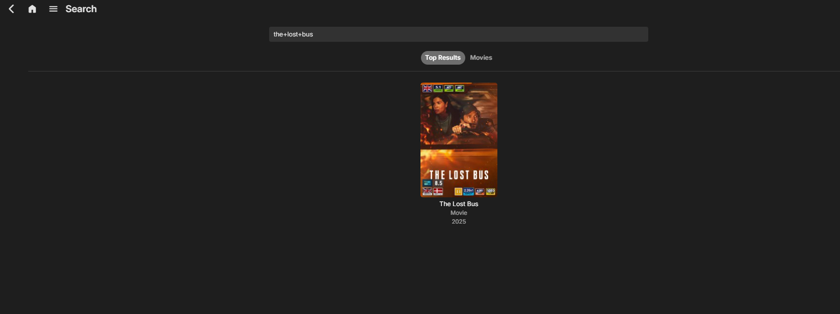

Neminem 1630 Posted October 3, 2025 Posted October 3, 2025 @Painkiller8818 @crusher11try this search term. the+lost+bus With this "the lost bus" I see this
Painkiller88 250 Posted October 3, 2025 Author Posted October 3, 2025 3 hours ago, Neminem said: @Painkiller8818 @crusher11try this search term. the+lost+bus With this "the lost bus" I see this Ok interesting, but this is not how i want to search in Future so this should definitely get fixed in the upcomming version 1
Neminem 1630 Posted October 3, 2025 Posted October 3, 2025 1 minute ago, Painkiller8818 said: Ok interesting, but this is not how i want to search in Future so this should definitely get fixed in the upcomming version But that how search engines work (+) = added to search / only search for this term.
Painkiller88 250 Posted October 3, 2025 Author Posted October 3, 2025 53 minutes ago, Neminem said: But that how search engines work (+) = added to search / only search for this term. no, this depends how it is programmed, if you say full term search it will search for the full string you enter without the need of + like it did till now in emby.

Painkiller88 250 Posted October 5, 2025 Author Posted October 5, 2025 8 hours ago, Luke said: What are you saying in voice search? I have the Nvidia Shield, so i just go on the Search icon and say the name of the movie, it recorgnizes what i say so for example i say "der herr der Ringe" (lord of the rings) and instead of showing just items matching the whole search phrase it shows everything emby can find for all of the words I never changed how i searched so with the updates and i saw the "improved for multi word searches" i must say this got worser than it was

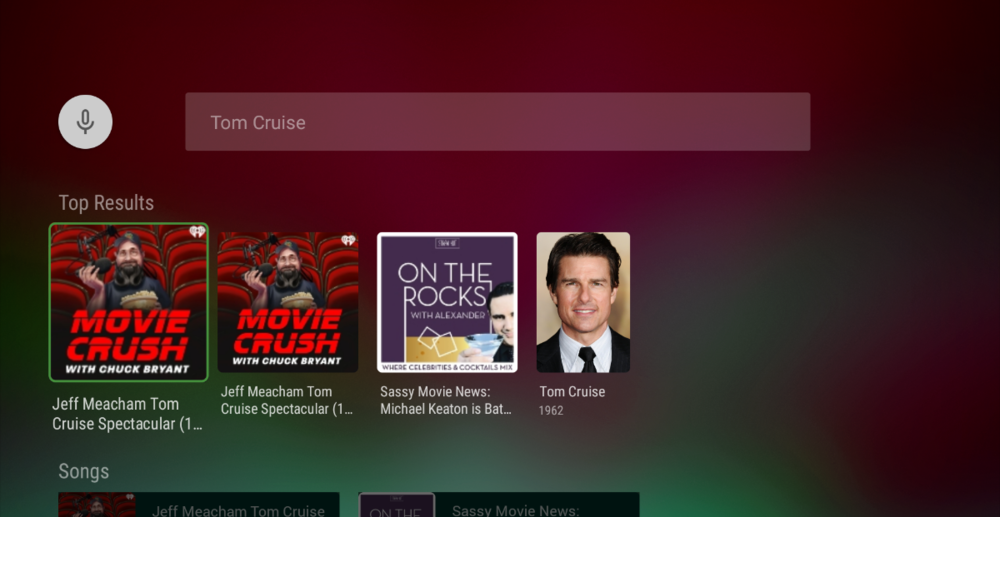

Painkiller88 250 Posted October 7, 2025 Author Posted October 7, 2025 (edited) On 10/5/2025 at 11:25 PM, Luke said: Hi, exactly what search icon are you using? On my nvidia Shield inside the emby app, there is the search bar and beside is the voice icon, i click on it and talk what i need to search Here is an example as i am not at home and can't make a picture of my own icon so i used the one from ebr in another thread: Edited October 7, 2025 by Painkiller8818

Luke 42288 Posted October 7, 2025 Posted October 7, 2025 2 hours ago, Painkiller8818 said: On my nvidia Shield inside the emby app, there is the search bar and beside is the voice icon, i click on it and talk what i need to search Here is an example as i am not at home and can't make a picture of my own icon so i used the one from ebr in another thread: Those first two things both have Tom Cruise in them, so this is nothing new. They would have always come back in search results.

Painkiller88 250 Posted October 8, 2025 Author Posted October 8, 2025 13 hours ago, Luke said: Those first two things both have Tom Cruise in them, so this is nothing new. They would have always come back in search results. You saw that i wrote i took an example picture from ebr? This is not an actual picture, this is just the answer to "Hi, exactly what search icon are you using?" This picture is about the icon, not the search results
