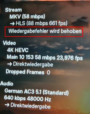

nanuk 36 Posted October 4, 2025 Posted October 4, 2025 (edited) Hi, i've a question... When turning on the "stats for nerds" I see a message "Wiedergabefehler wird behoben" -> something like Playback error is being fixed. The Video and Audio streams are played "direct" and no Subs are selected. Can you explain why emby is converting something? I'll attach the server log (start playing the file at line 596) and a screenshot from the stats to this. Maybe you can explain whats "wrong" with the file and why emby has to do something during playback. Thanx embyserver.txt Edited October 4, 2025 by nanuk
SamES 1084 Posted October 4, 2025 Posted October 4, 2025 Is suspect the LG player threw an error, so the same streams are being delivered without conversion in a new container. What is the full media info for this file?

Luke 42233 Posted October 4, 2025 Posted October 4, 2025 Quote Can you explain why emby is converting something? OK so now we know the reason why. It is recovery from an error thrown by the LG player.

nanuk 36 Posted October 5, 2025 Author Posted October 5, 2025 19 hours ago, Luke said: Unfortunately all we get is an error code of mediadecodeerror. LG does not provide a way to get more detailed error info than that. Maybe try reencoding the file if you want to avoid this? You just have to keep in mind that the LG video player is not going to be as robust as something like VLC. It will require more cleanly encoded files. ok... here is what i found out WebOS 25 supports DV in mkv files.. BUT... only Dolby Vision Profile 8... all mkv files having DV Profile 7 are not played in Dolby Vision but get an error (see initial post) and are played in HDR.
