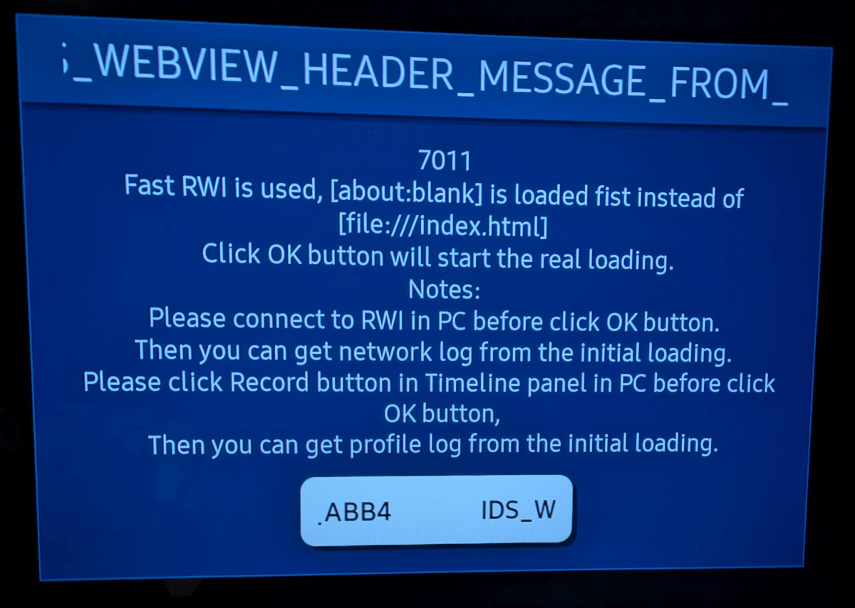

erzonk 21 Posted October 4, 2025 Posted October 4, 2025 Hi, i sideloaded the last Emby Version 2.2.5 on my QN85A Samsung TV. I have to used sideload because in the samsung appstore the last version is 2.1. This 2.1 Version i uninstalled. After starting 2.2.5 this Message apears: Did anybody knows what this means and how i fixe it? BTW: After klick ok emby works fine!. THx a lot

FrostByte 5453 Posted October 4, 2025 Posted October 4, 2025 Maybe SamES can make something of this Quote "7011 fast rwi is used" is a message displayed on older Samsung Tizen TVs when a developer is trying to launch an app in developer mode, indicating that the Remote Web Inspector (RWI) feature is active and bypassing the standard app loading process to load a local HTML file for debugging. To proceed, the developer should click "OK," connect the TV to a PC, and use the "Record" button in the Timeline panel of the debugging tool to capture logs for analysis, as this is a standard part of the Tizen web app development workflow for older models. What this message means: Fast RWI: This refers to a feature for developers on older Tizen TVs that speeds up the web app loading process by directly loading the app's HTML content instead of the full app package. 7011 (RWI): This specific number might refer to a particular app identifier or a build version used in the debugging process. [about:blank] is loaded first: When Fast RWI is active, a blank page loads initially, and then the developer must click "OK" to start loading their actual app content. How to proceed: Connect to RWI: Ensure your TV is connected to the same network as your development PC where you are running the Tizen Studio debugging tools. Click "OK": Click the "OK" button on the modal to start the app loading process. Record Logs: Before clicking "OK," open the Timeline panel in your Tizen Studio or other debugging tools and click the Record button. Analyze Logs: After your app loads, you can then analyze the captured network and profiling logs to understand and debug any issues with your app's initial loading or performance on the Tizen TV.
FrostByte 5453 Posted October 4, 2025 Posted October 4, 2025 (edited) I assume your TV isn't in developer mode. Access the Developer Mode menu: Using your remote control, move the focus to any app and press the 1-2-3-4-5 number sequence. Edited October 4, 2025 by FrostByte
erzonk 21 Posted October 4, 2025 Author Posted October 4, 2025 My TV is not in developer mode, correct. Is this necessary to use Emby? At what stage should I switch to developer mode to do something? BTW: My tv remote control has no numpad.
FrostByte 5453 Posted October 4, 2025 Posted October 4, 2025 No, it should not be in developers' mode. Just that the message according to that is trying to reach back to the RWI SDK on your PC. Which most people aren't going to have of course. Shoot, @SamES is down under and hopefully will see this soon.

SamES 1084 Posted October 5, 2025 Posted October 5, 2025 8 hours ago, FrostByte said: Shoot, @SamES is down under and hopefully will see this soon. Ha, good call! No, I’ve not seen this message before and from what I can find in the Tizen forums, this type of debugging shouldn’t even be possible if the TV does not have developer mode enabled. Just go to the app screen, if developer mode is enabled you should see a banner at the top of the page telling you it’s enabled. Alternatively, I would have also suggested that you check the firmware but it does look like what you have is the latest. Have you had this issue before with the USB version or is this the first time you have tried USB loading? BTW, I wouldn’t be too concerned of the different version number between the store and USB versions. We have to increment the version number every month to update the USB version so it goes up quite quickly but there usually aren’t any significant functional differences between them. The store version gets updated often enough that you shouldn’t really see much of a difference and it’s not worth the hassle of uninstalling/reinstalling every month 1
erzonk 21 Posted October 5, 2025 Author Posted October 5, 2025 Okay, thx for that info, @SamES For testing i uninstalled the USB Version 2.2.5 and installed the 2.1 from the Samsung AppStore. Same message appears now there too. When my child stops playing Games on the TV in choose a factory reset of the TV. Thats the First factory reset i ever do on this TV. That cant hurt. I report later. 1 1
erzonk 21 Posted October 5, 2025 Author Posted October 5, 2025 So, after full factoryreset of the TV and installing the emby usb version 2.2.5 all works fine without errormessage at startup, except trailers. Trailers works on windows App and android app, but not on Samsung App. Its ok for me. I'll wait and see if something changes with future releases. thx for all helpers 1

SamES 1084 Posted October 9, 2025 Posted October 9, 2025 On 06/10/2025 at 01:32, erzonk said: So, after full factoryreset of the TV and installing the emby usb version 2.2.5 all works fine without errormessage at startup, except trailers. Trailers works on windows App and android app, but not on Samsung App. Its ok for me. I'll wait and see if something changes with future releases. thx for all helpers Can you please try uninstalling any emby apps (make sure they are uninstalled, not just removed from the home screen) then remove power from the tv for a few minutes, then reinstall whichever Emby app you prefer, although i would recommend the app store version. Then please try trailers again after that 1

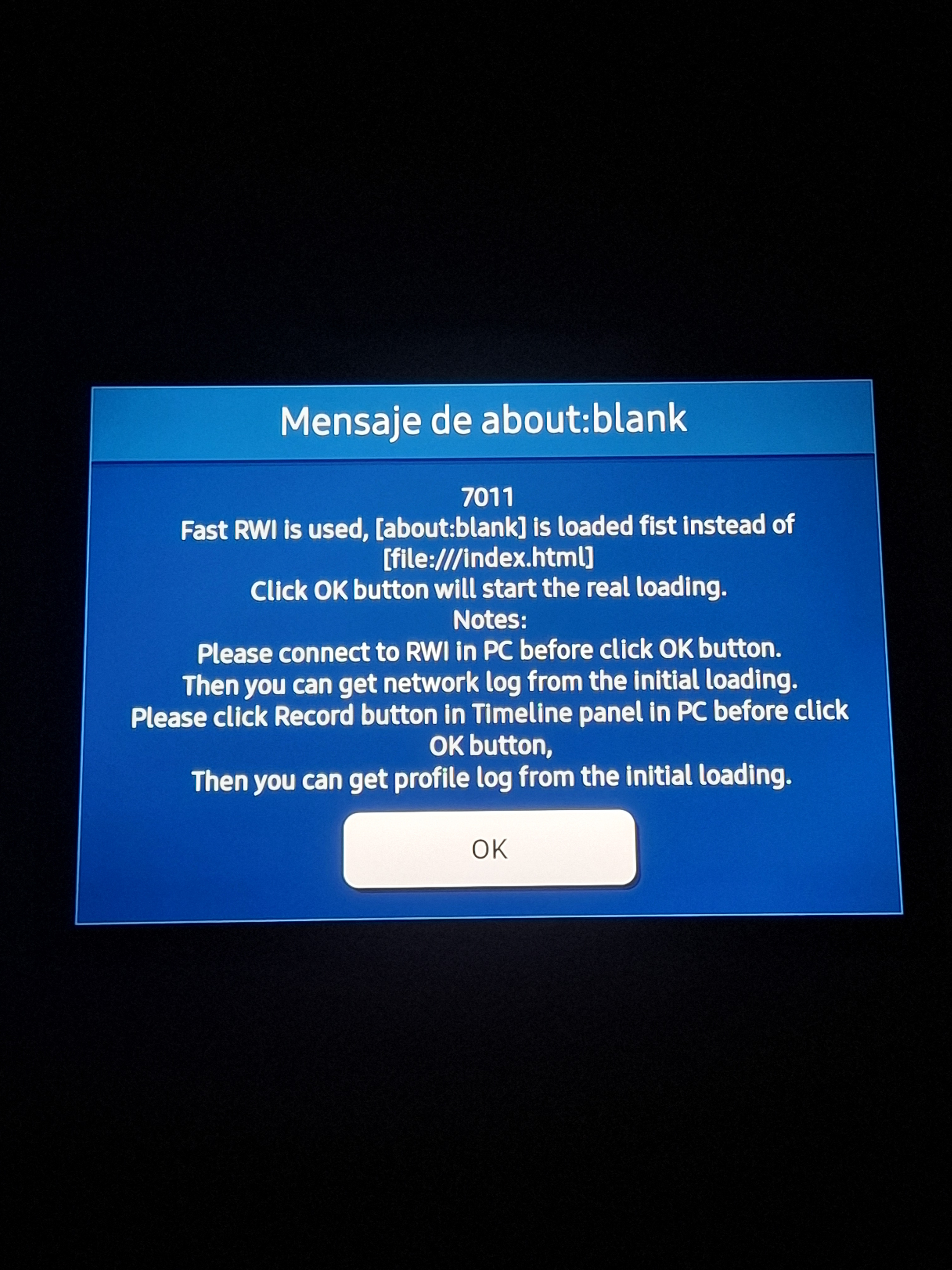

coyotecabreado 4 Posted January 20 Posted January 20 (edited) Hola, tengo este mismo fallo y siguiendo los pasos que se dicen no consigo quitar este pantallazo cada vez que inicio Emby Tyzen en mi QN95. El firmware es el ultimo publicado y la aplicación Emby Tyzen es la version 2.3.0, al igual que la version de servidor también es la ultima 4.9.3.0. No molesta mucho pero es raro que de repente salga este error. Un saludo y gracias por leer esto. ------‐--------------------- Google translator ---‐------------------------ Hi, I'm having the same problem, and following the suggested steps, I can't get rid of this blue screen every time I start Emby Tyzen on my QN95. The firmware is the latest version, and the Emby Tyzen application is version 2.3.0, as is the server version, 4.9.3.0. It's not a major issue, but it's strange that this error suddenly appears. Thanks for reading. Edited January 20 by coyotecabreado
SamES 1084 Posted January 20 Posted January 20 You can try fully uninstalling the app (don't just remove it from the Home app shortcuts), the remove power from the TV for several minutes, then try reinstalling. This might fix it, otherwise the only other guaranteed fix that I'm aware of is a factory reset for the TV which means you will need to enter all your TV settings again and reinstall all your apps which is a bit of a pain. 1
coyotecabreado 4 Posted January 20 Posted January 20 (edited) 5 hours ago, SamES said: Puede intentar desinstalar completamente la aplicación (no solo la elimine de los accesos directos de la aplicación Home), la alimentación de eliminación del televisor durante varios minutos y, a continuación, intente volver a instalar. Esto podría arreglarlo, de lo contrario, la única otra solución garantizada que conozco es un restablecimiento de fábrica para el televisor, lo que significa que tendrá que volver a ingresar todas sus configuraciones de TV y volver a instalar todas sus aplicaciones, lo que es un poco doloroso. Hola @SamES , hice todo lo que usted dice en la primera parte, y despues de una hora pense en restablecer de fabrica el televisior, pero me dije "a lo mejor hay otra opcion". Solo me queda instalar una/dos versiones anteriores y cruzar los dedos, si esto ultima funciona (cosa que dudo), lo comentare por aqui. Sin mas, un saludo y gracias por responder Edited January 20 by coyotecabreado 1
