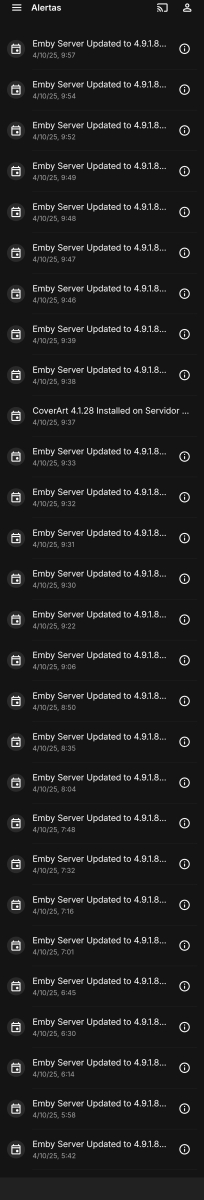

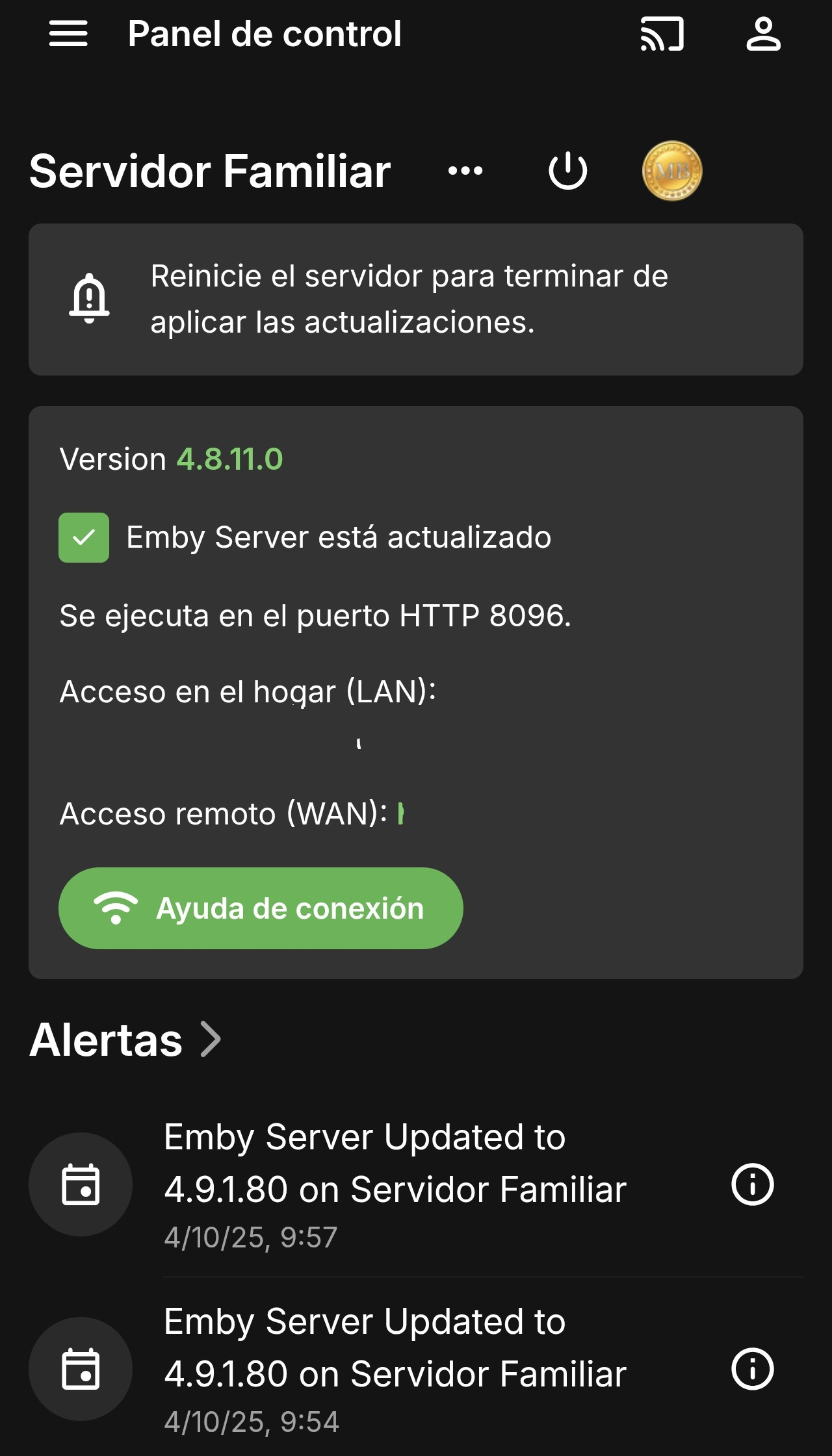

juandiego79 4 Posted October 4, 2025 Posted October 4, 2025 He reiniciado el servidor en varias ocasiones y no es posible actualizar a la nueva versión. ¿Cómo debo proceder?
GrimReaper 4895 Posted October 4, 2025 Posted October 4, 2025 That usually indicates that something is keeping server folder locked (browser are notorious for it, Firefox in particular). Try rebooting server machine.
juandiego79 4 Posted October 4, 2025 Author Posted October 4, 2025 I've restarted about 10 times and always the same result, it gets stuck on version 4.8
GrimReaper 4895 Posted October 4, 2025 Posted October 4, 2025 You could try downloading some unlocking software (like this one or this one or any other of your preference) and check are there any open handles on server folder.
Luke 42239 Posted October 6, 2025 Posted October 6, 2025 @juandiego79are you still having an issue with this? Try shutting down Emby Server, and then running the installer from our website to install on top of your existing version. Please let us know if this helps. Thanks.
Solution juandiego79 4 Posted October 14, 2025 Author Solution Posted October 14, 2025 It worked. I downloaded and installed the latest version from your website, and now it's version 4.9.1.80. Thanks. 1
