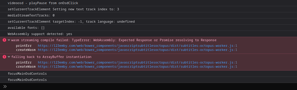

rechigo 367 Posted October 4, 2025 Posted October 4, 2025 (edited) Firefox 143.0.3, Emby Server Beta 4.9.1.36 (Move this to testing area please, oopss) When trying to enable ASS subtitles on a video, no subtitles display, and errors are visible in the developer console. Below photo contains a few log lines at the time of enabling ASS subtitles Edited October 4, 2025 by rechigo
Luke 42239 Posted October 4, 2025 Posted October 4, 2025 Hi there, let's look at an example. Please attach the information requested in how to report a media playback issue. Thanks!
rechigo 367 Posted October 8, 2025 Author Posted October 8, 2025 (edited) Here are direct stream and server logs with debug logging enabled from the time I enabled the ASS subtitles. ffmpeg-directstream-f684c14f-b3f0-4e90-978f-d2fc2ed3adae_1.txt embyserver.txt Edited October 8, 2025 by rechigo
rechigo 367 Posted October 15, 2025 Author Posted October 15, 2025 Same behavior can be observed in chrome. Sometimes skipping ahead/back is enough to get the subtitles to display as well
Luke 42239 Posted October 22, 2025 Posted October 22, 2025 Seems to be working just fine in my testing. Can you provide a sample video for testing?
