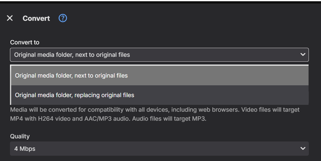

sa2000 697 Posted October 4, 2025 Posted October 4, 2025 So you are selecting the option to overwrite the original file when converting? Suggest you change that whilst the issue is being investigated I will see if I can replicate the problem

Pippinuk 5 Posted October 4, 2025 Author Posted October 4, 2025 Thanks so much for your responses! I really appreciate it. I should have tested the 'next to original file' - I'll do that later and let you know what happens
