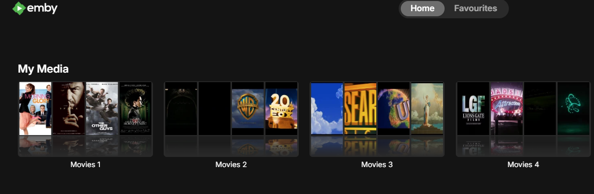

CineMac 1 Posted October 2, 2025 Posted October 2, 2025 Hi, new user here. Windows 10 and Emby version x64 4.9.1.80 I have added the video contents of 3 external drives in 3 libraries. Each one if configured identically. The first one, all the thumbnails for every video are the normal thumbnail you'd see on IMDB. The next 2 drives however, the thumbnails are mostly the very first frame of each video. How can I force Emby to download the thumbnails instead of a frame from the film?

CineMac 1 Posted October 2, 2025 Author Posted October 2, 2025 44 minutes ago, Luke said: HI there, can you please provide a specific example? How to Report a Problem Thanks ! I honestly don't know what else to say. I added the contents of one external drive to the library. When the thumbnails display they are the thumbnails that you'd get if you went to IMDB. However I've now also added library 2, 3 and 4. And there's no thumbnails like the first one. What Emby has done is taken the first frame from every film and used that as the thumbnail. Each library has been configured the exact same way so I can't figure why 1 is good but 2,3 and 4 are not. I wish I knew what else to say to you. I could add a screenshot if that would help, but it will show exactly what I described. If there's something you need to know just ask me, I honestly don't know what else to add.

CineMac 1 Posted October 2, 2025 Author Posted October 2, 2025 4 minutes ago, Luke said: This would be a helpful: I'm not getting thumbnails for movie _____________. My file and folders are organized and named as ____________. I have the ___________ metadata and image fetchers enabled on the library. I'm not getting thumbnails for 4 disks out of 5. All files are simply in the root of the drives, and the name is simply the movie name + year of release. eg: A Streetcar Named Desire (1951) All image fetchers are enabled, all the controls have been copied from disk 1 which worked perfectly. There's a couple of metadata sections, metadate readers and savers both asking to set it as Nfo. I have enabled both.

Luke 42289 Posted October 3, 2025 Posted October 3, 2025 All of your requests to both moviedb and tvdb are timing out and failing. Typical causes from this are firewall, security software, or VPN. Or that you could be getting blocked from them. Can you please look in those and let us know what you find? Also once you resolve this you will need to refresh metadata manually on impacted content. The server will not retry the failures over and over. Thanks.
CineMac 1 Posted October 3, 2025 Author Posted October 3, 2025 Just reading through this one. Is it failing to connect to the internet, so defaulting to producing a frame from the film? embyserver.txt
CineMac 1 Posted October 3, 2025 Author Posted October 3, 2025 7 minutes ago, Luke said: All of your requests to both moviedb and tvdb are timing out and failing. Typical causes from this are firewall, security software, or VPN. Or that you could be getting blocked from them. Can you please look in those and let us know what you find? Also once you resolve this you will need to refresh metadata manually on impacted content. The server will not retry the failures over and over. Thanks. Ahh w both came to the same conclusion. As far as I know nothing is hampering internet right now. Although it does get flaky from time to time like all internet. How do I refresh metadata please?
