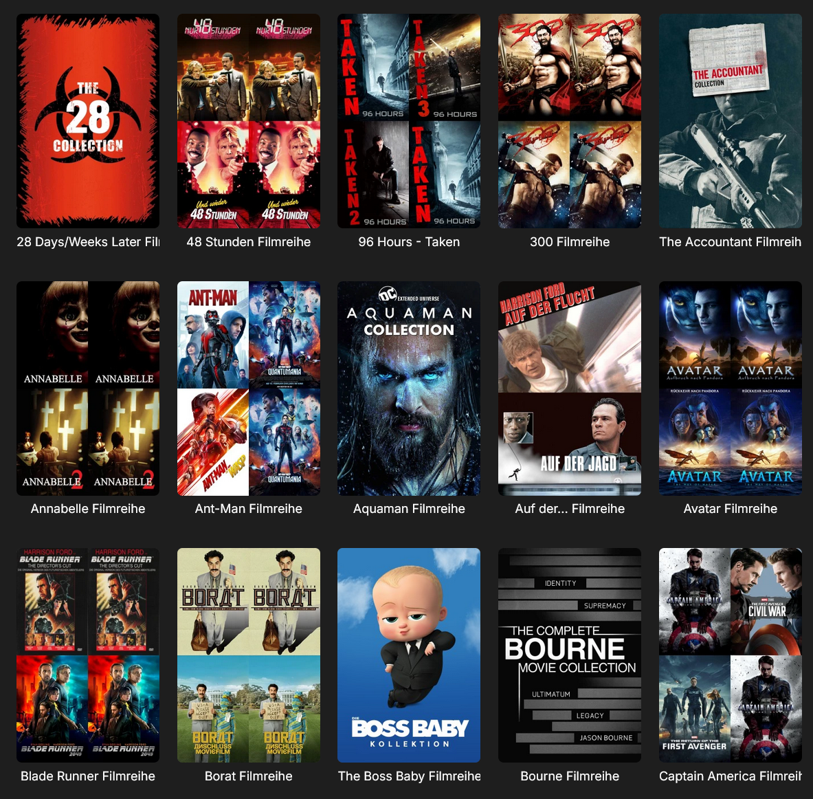

Phunkless 0 Posted October 4, 2025 Posted October 4, 2025 Hey, i think i got a similar problem as of @ejx982 mentioned. Only my collections tab have this problem and not all of them as shown in the screenshot My Meta Data Providers are all checked and the switch to a new metadata location don't seem to work for me. Emby Server v4.9.1.80

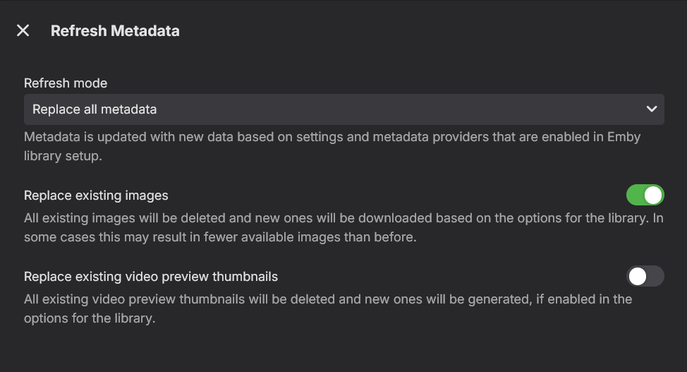

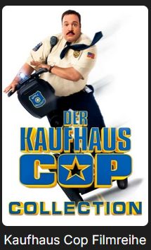

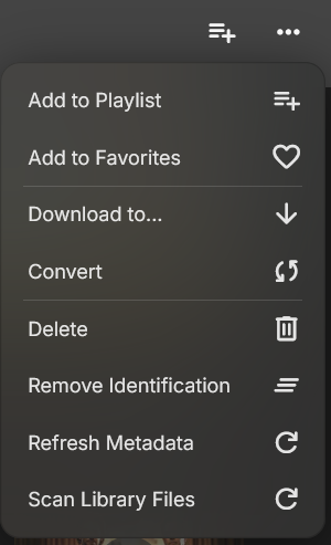

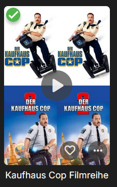

Phunkless 0 Posted October 5, 2025 Posted October 5, 2025 (edited) Here is my work around for this. In emby web-view: multiselect all the collections with wrong covers by clicking on the top left corner of the collection go to the 3-dot menu on the top right and select "Refresh Metadata" check "Replace existing images" and klick "Refresh" wait 30-60s, depending on the size of your collection refresh the collections tab by pressing F5 covers should now show the right collections cover Edited October 5, 2025 by Phunkless
