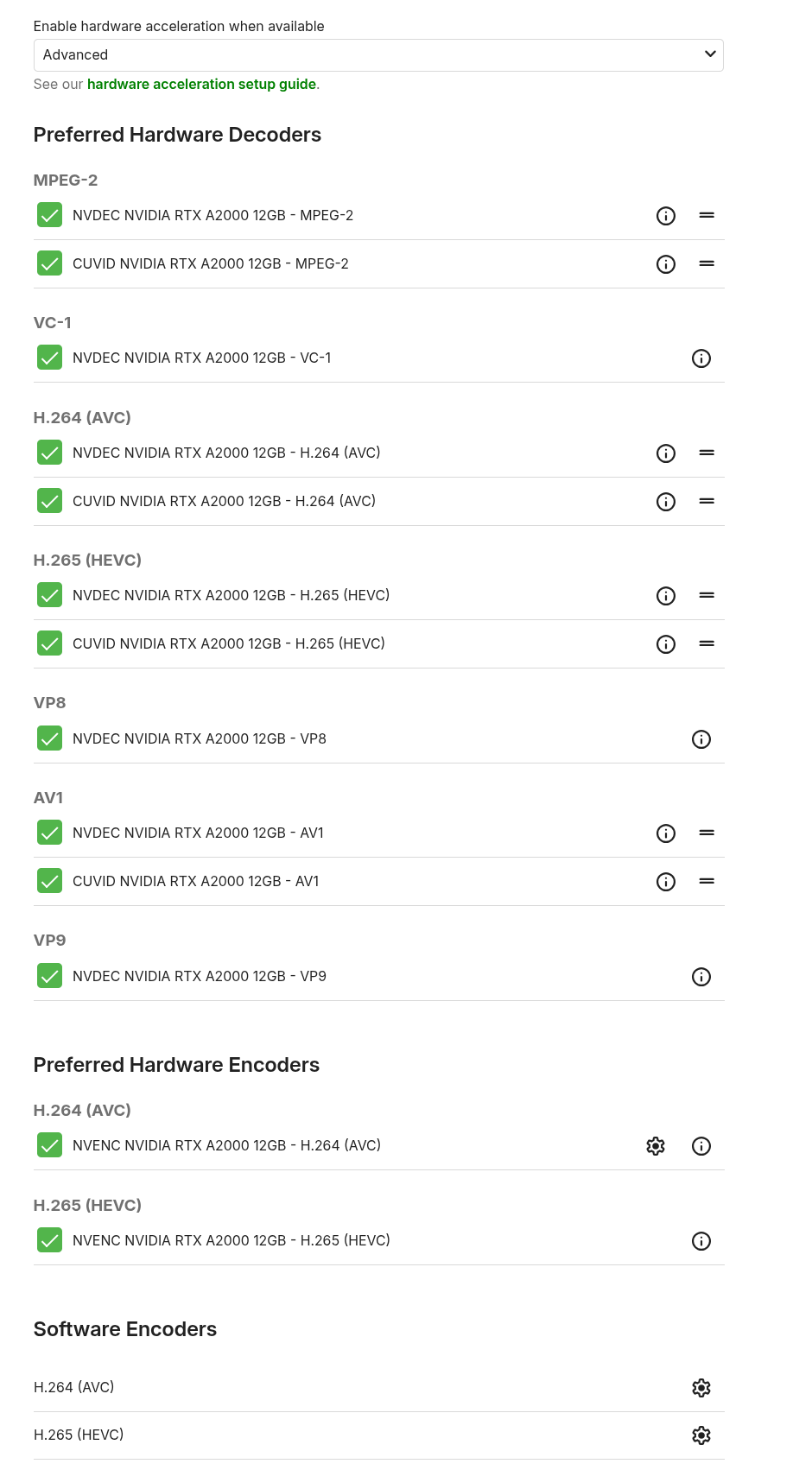

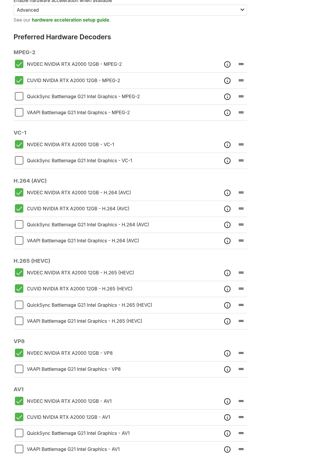

RetroZelda 6 Posted October 2, 2025 Posted October 2, 2025 I wasnt sure if I should post this question here or in the linux section, so i apologise if it should be over there. Anyway, I have my emby server(v4.9.1.80) running on a debian testing(forky) instance and everything is running fine, however I am attempting to transition to an Intel Arc B50 from an RTX A2000 and so far everything regarding the drivers seems ok, but the B50 isnt getting recognised by emby. Based on the kernel requirements listed here: https://dgpu-docs.intel.com/devices/hardware-table.html i should be running what I need(im on kernel 6.16.3) I have both cards connected to the motherboard and this is what I see inside Emby: im fairly confident that I have the B50's drivers setup and working because of the outputs of these commands: Quote $ lspci -k | grep -iA3 vga 25:00.0 VGA compatible controller: Intel Corporation Battlemage G21 [Intel Graphics] Subsystem: Intel Corporation Device 1114 Kernel driver in use: xe Kernel modules: xe -- 2d:00.0 VGA compatible controller: NVIDIA Corporation GA106 [RTX A2000 12GB] (rev a1) Subsystem: NVIDIA Corporation Device 1611 Kernel driver in use: nvidia Kernel modules: nvidia Quote $ vainfo Trying display: wayland Trying display: x11 error: can't connect to X server! Trying display: drm libva info: VA-API version 1.22.0 libva info: Trying to open /usr/lib/x86_64-linux-gnu/dri/iHD_drv_video.so libva info: Found init function __vaDriverInit_1_22 libva info: va_openDriver() returns 0 vainfo: VA-API version: 1.22 (libva 2.22.0) vainfo: Driver version: Intel iHD driver for Intel(R) Gen Graphics - 25.3.4 () vainfo: Supported profile and entrypoints VAProfileNone : VAEntrypointVideoProc VAProfileMPEG2Simple : VAEntrypointVLD VAProfileMPEG2Main : VAEntrypointVLD VAProfileH264Main : VAEntrypointVLD VAProfileH264Main : VAEntrypointEncSlice VAProfileH264High : VAEntrypointVLD VAProfileH264High : VAEntrypointEncSlice VAProfileJPEGBaseline : VAEntrypointVLD VAProfileJPEGBaseline : VAEntrypointEncPicture VAProfileH264ConstrainedBaseline: VAEntrypointVLD VAProfileH264ConstrainedBaseline: VAEntrypointEncSlice VAProfileVP8Version0_3 : VAEntrypointVLD VAProfileHEVCMain : VAEntrypointVLD VAProfileHEVCMain : VAEntrypointEncSlice VAProfileHEVCMain10 : VAEntrypointVLD VAProfileHEVCMain10 : VAEntrypointEncSlice VAProfileVP9Profile0 : VAEntrypointVLD VAProfileVP9Profile1 : VAEntrypointVLD VAProfileVP9Profile2 : VAEntrypointVLD VAProfileVP9Profile3 : VAEntrypointVLD VAProfileHEVCMain12 : VAEntrypointVLD VAProfileHEVCMain422_10 : VAEntrypointVLD VAProfileHEVCMain422_10 : VAEntrypointEncSlice VAProfileHEVCMain422_12 : VAEntrypointVLD VAProfileHEVCMain444 : VAEntrypointVLD VAProfileHEVCMain444 : VAEntrypointEncSlice VAProfileHEVCMain444_10 : VAEntrypointVLD VAProfileHEVCMain444_10 : VAEntrypointEncSlice VAProfileHEVCMain444_12 : VAEntrypointVLD VAProfileHEVCSccMain : VAEntrypointVLD VAProfileHEVCSccMain : VAEntrypointEncSlice VAProfileHEVCSccMain10 : VAEntrypointVLD VAProfileHEVCSccMain10 : VAEntrypointEncSlice VAProfileHEVCSccMain444 : VAEntrypointVLD VAProfileHEVCSccMain444 : VAEntrypointEncSlice VAProfileAV1Profile0 : VAEntrypointVLD VAProfileAV1Profile0 : VAEntrypointEncSlice VAProfileHEVCSccMain444_10 : VAEntrypointVLD VAProfileHEVCSccMain444_10 : VAEntrypointEncSlice I have attached both the hardware detection log and the main emby log. hardware_detection-63894944486.txt embyserver.txt

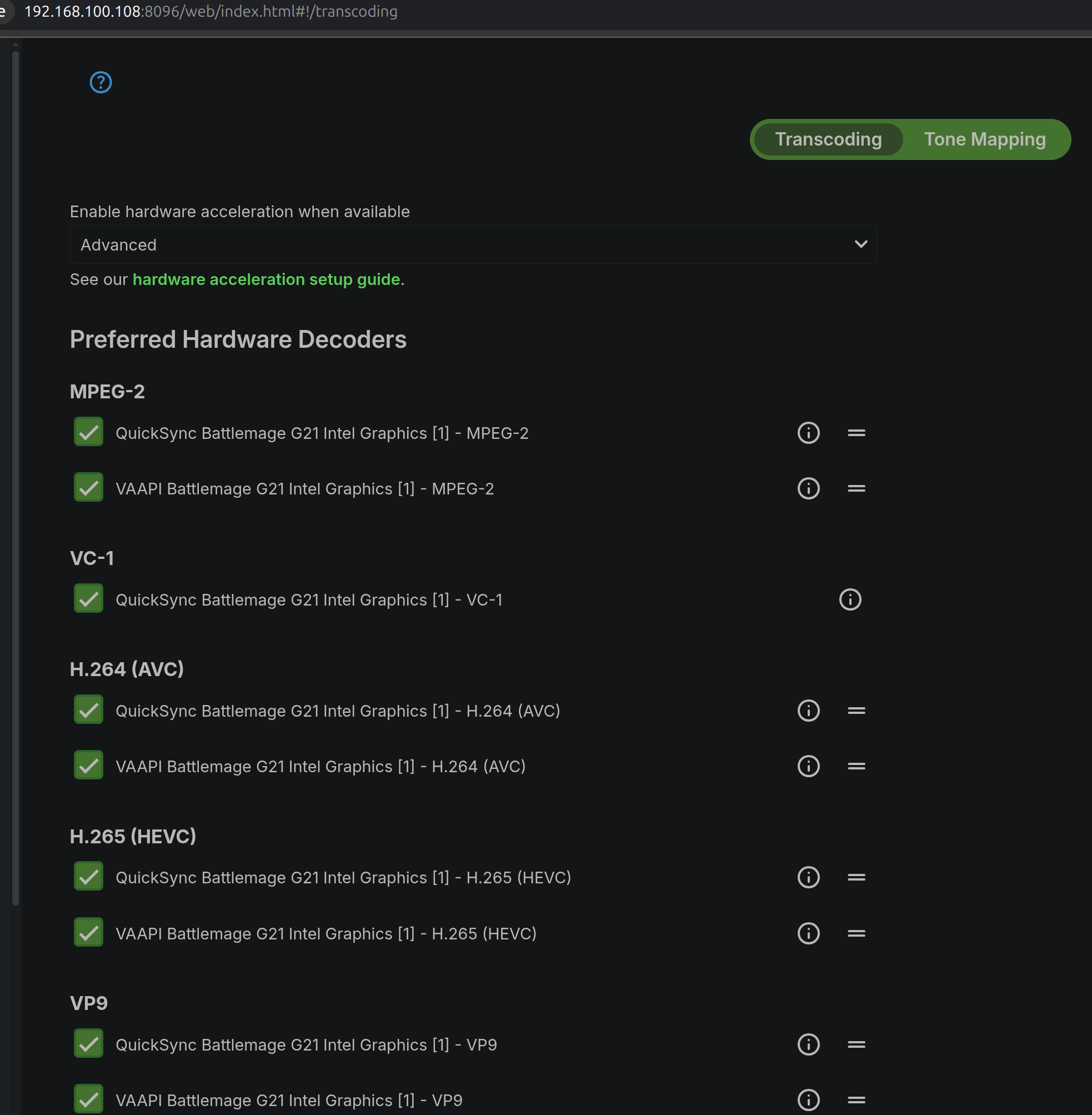

Walter_Ego 1 Posted October 10, 2025 Posted October 10, 2025 (edited) yeah i just whacked a b60 in a machine and ran up embyserver/emby:beta on it, and while the vainfo inside the container sees the b60, and ffmpeg inside the container can transcode with it, emby doesn't show any transcoding options available. will dig a bit deeper tomorrow. oh, i hit "advanced" and they all showed up. forgot i was on a new instance of emby, am used to already being in advanced. anyway @RetroZeldai am using an ubuntu 25.10 server 6.17.0 cloudimage in a proxmox vm with vfio passthrough and it is seeing it and can transcode with it. hopefully you get yours going too! Edited October 10, 2025 by Walter_Ego
Luke 42242 Posted October 10, 2025 Posted October 10, 2025 Hi, apologies for the delay. There is an updated Intel driver on the server beta channel in case that might help. 1 1
RetroZelda 6 Posted October 10, 2025 Author Posted October 10, 2025 @Lukejust installed the beta and it works! Thanks!! 2 1
