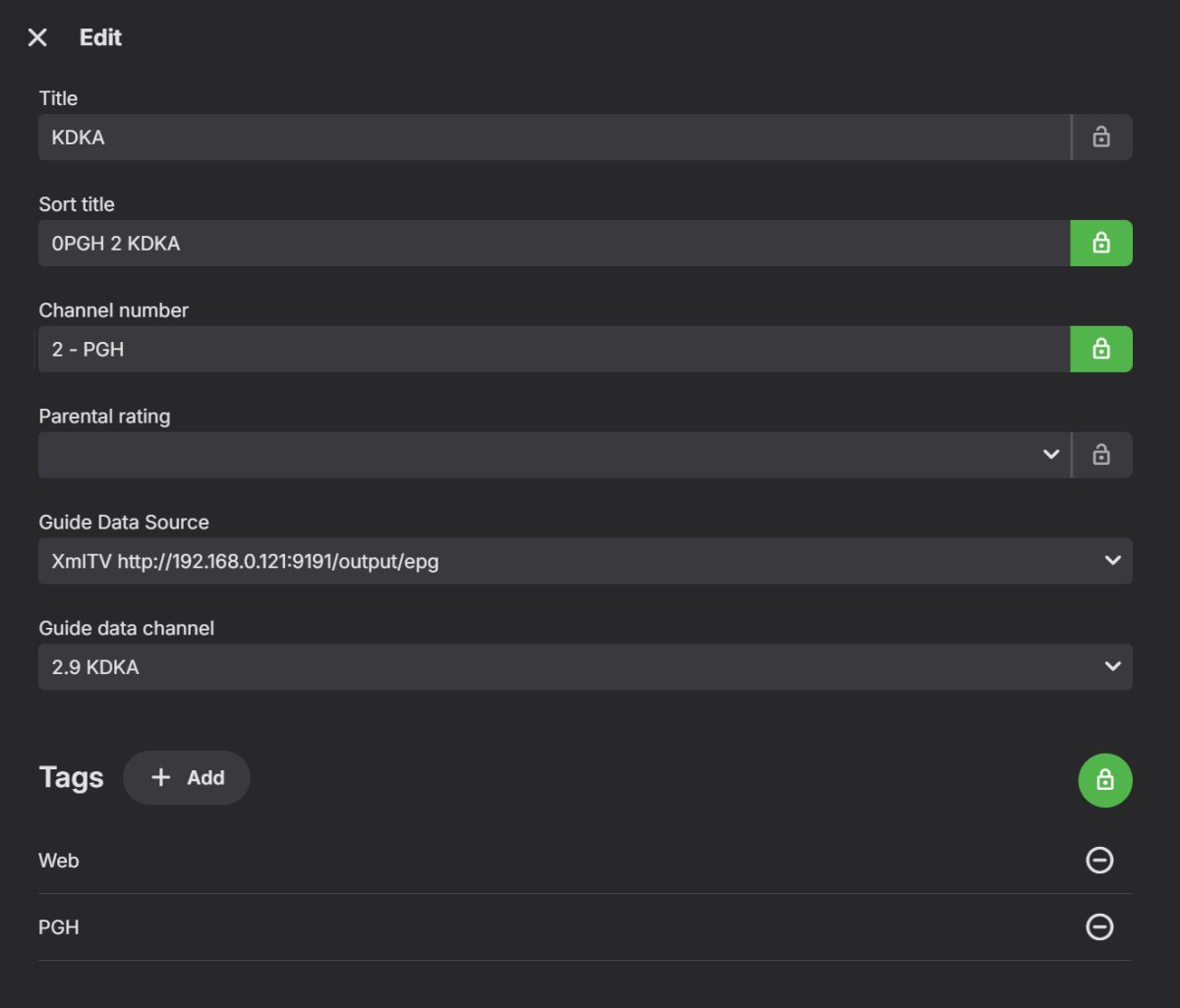

Lyfesaver 135 Posted October 1, 2025 Author Posted October 1, 2025 This is the best I can think of but I would not think it adds any new info. Channel before a guide refresh: Channel after a manual guide refresh
Luke 42239 Posted October 1, 2025 Posted October 1, 2025 Hi there, please attach the Emby server log from when the problem occurred: How to Report a Problem Thanks!

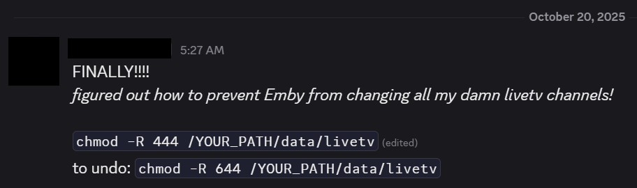

Lyfesaver 135 Posted October 20, 2025 Author Posted October 20, 2025 This person might have a good idea. Going to try it. Will just manually chmod when I have channels to be added/removed
