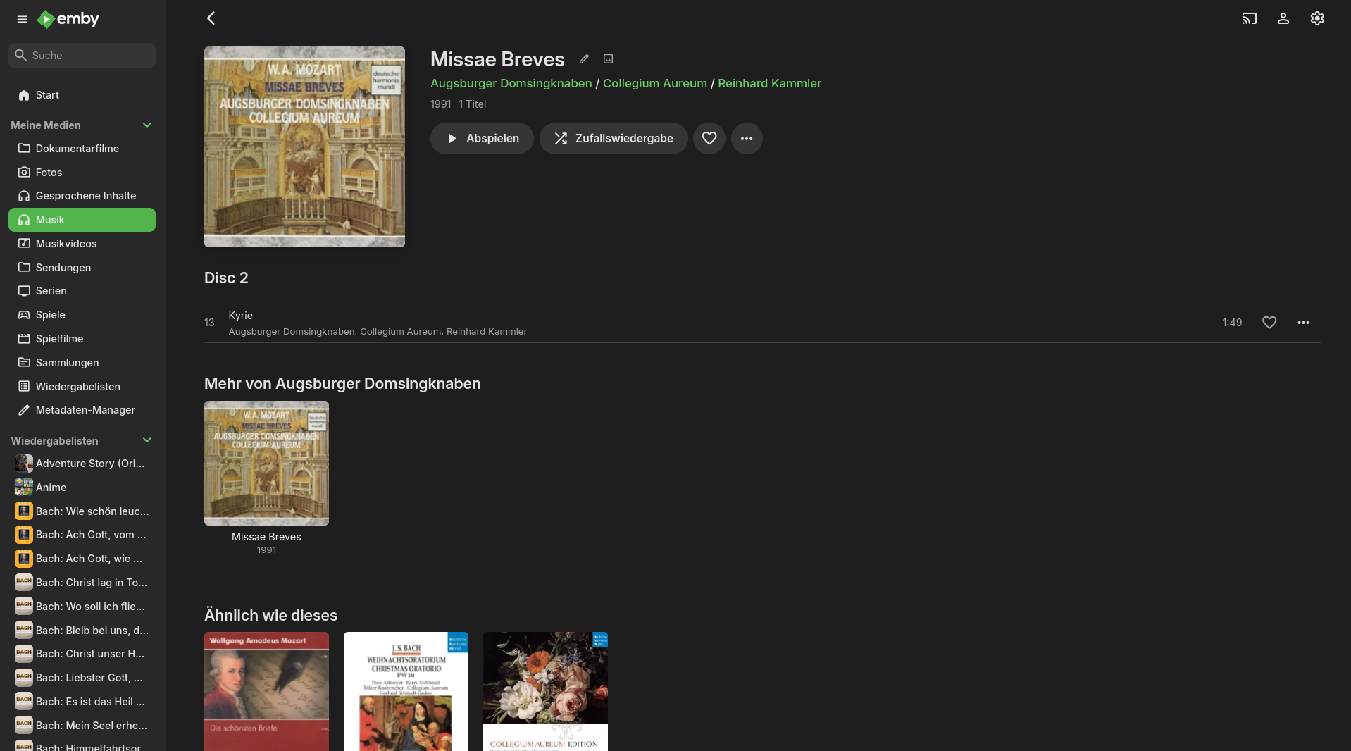

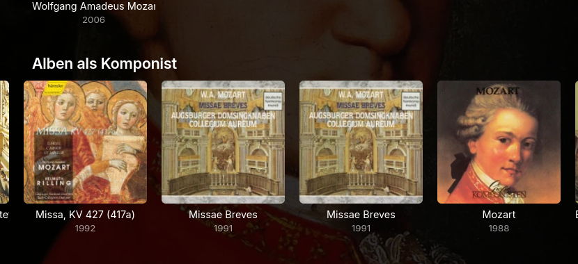

goblin2k3 6 Posted October 1, 2025 Posted October 1, 2025 Really infuriating issue (maybe related to the new version?): Had to change (correct) the name of an album. Emby now wants to separate it into two albums. Updating metadata of the albums and album artists did not help. Changing the file's metadata and reverting them did not help. Removing the file of the one track album and putting it into the album's folder again after a library scan does not help. Removing the nfo-file and doing a library scan does not help (btw: it seems, the nfo file is only created when updating the metadata of the one track album). I'm really out of ideas. What the hell is going on?

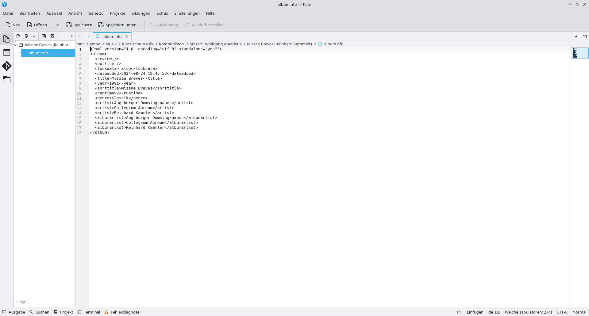

goblin2k3 6 Posted October 1, 2025 Author Posted October 1, 2025 Another thing I just found out: Saving the metadata of one of the "albums" will update the nfo in the folder and thus override the metadata of the other "album" (just look at the "runtime" tag)

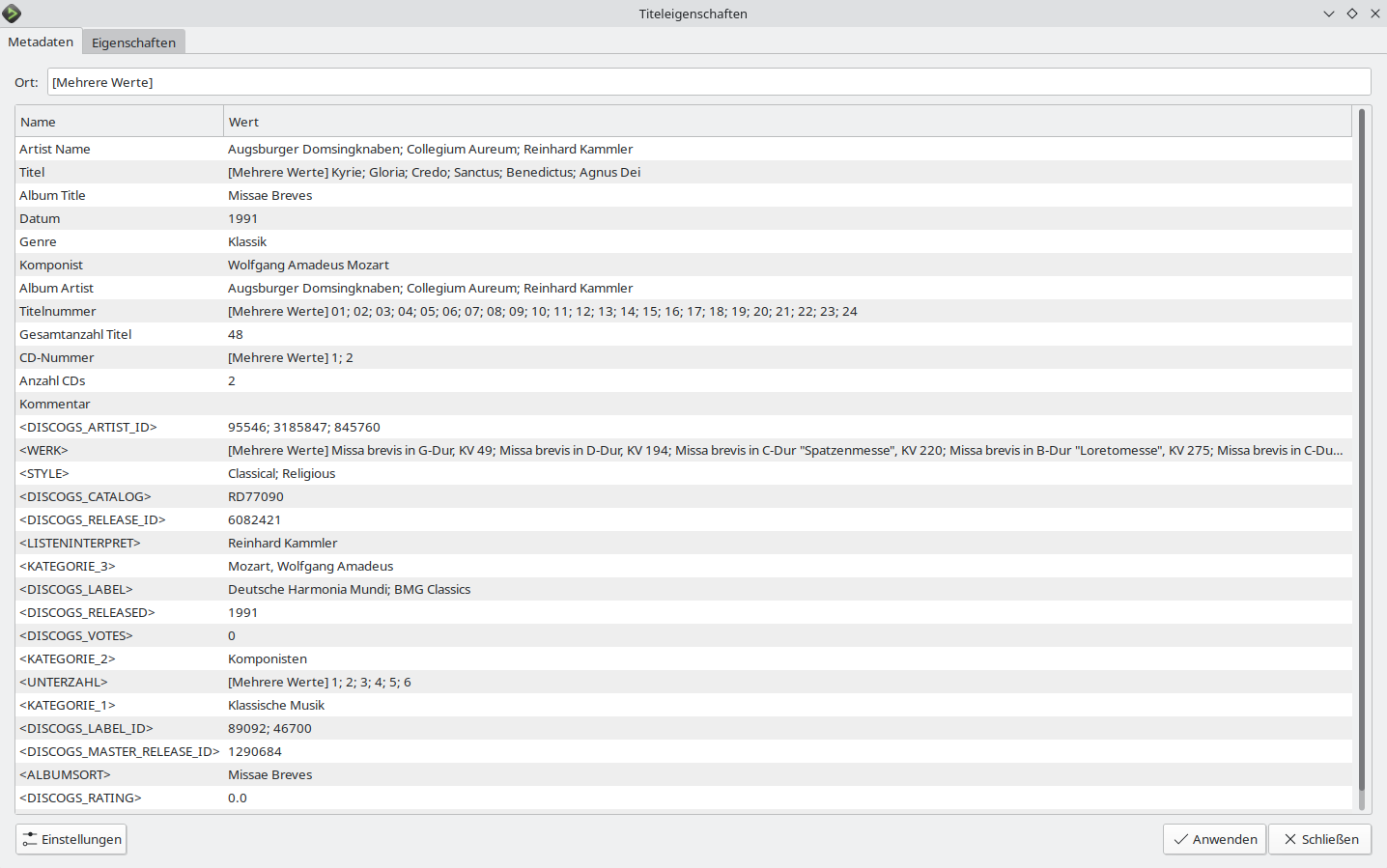

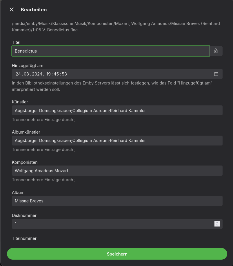

user24 369 Posted October 1, 2025 Posted October 1, 2025 What does Emby show for the individual metadata of the bad track compared to a good track? One way to get to this is, from your Emby tracklist screenshots, click on the RHS three dots and select Edit Metadata (of the individual song). This may give a clue as to what is being imported from the embedded metadata that may be causing this issue.
goblin2k3 6 Posted October 1, 2025 Author Posted October 1, 2025 Thanks for your quick response! I can really see no differences in the metadata.

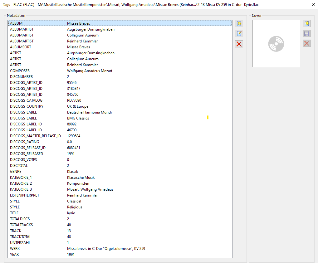

Luke 42289 Posted October 1, 2025 Posted October 1, 2025 Hi, do all the tracks have the same album and album Artist values?
goblin2k3 6 Posted October 1, 2025 Author Posted October 1, 2025 Yes, the values definitely match. Just tried changing the album title, hoping this would cause a reset. Well, searching the new album title will return the tracks but not the album(s). The album title in the tracks remains unchanged, even when i update the metadata.

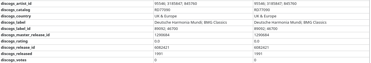

Luke 42289 Posted October 1, 2025 Posted October 1, 2025 Do they have discogs album and musicbrainz album values? If yes then they will also all need to match.
goblin2k3 6 Posted October 1, 2025 Author Posted October 1, 2025 There are (identical) Discogs IDs in the files, but emby seems to ignore them. There is no entry in MusicBrainz for the album.

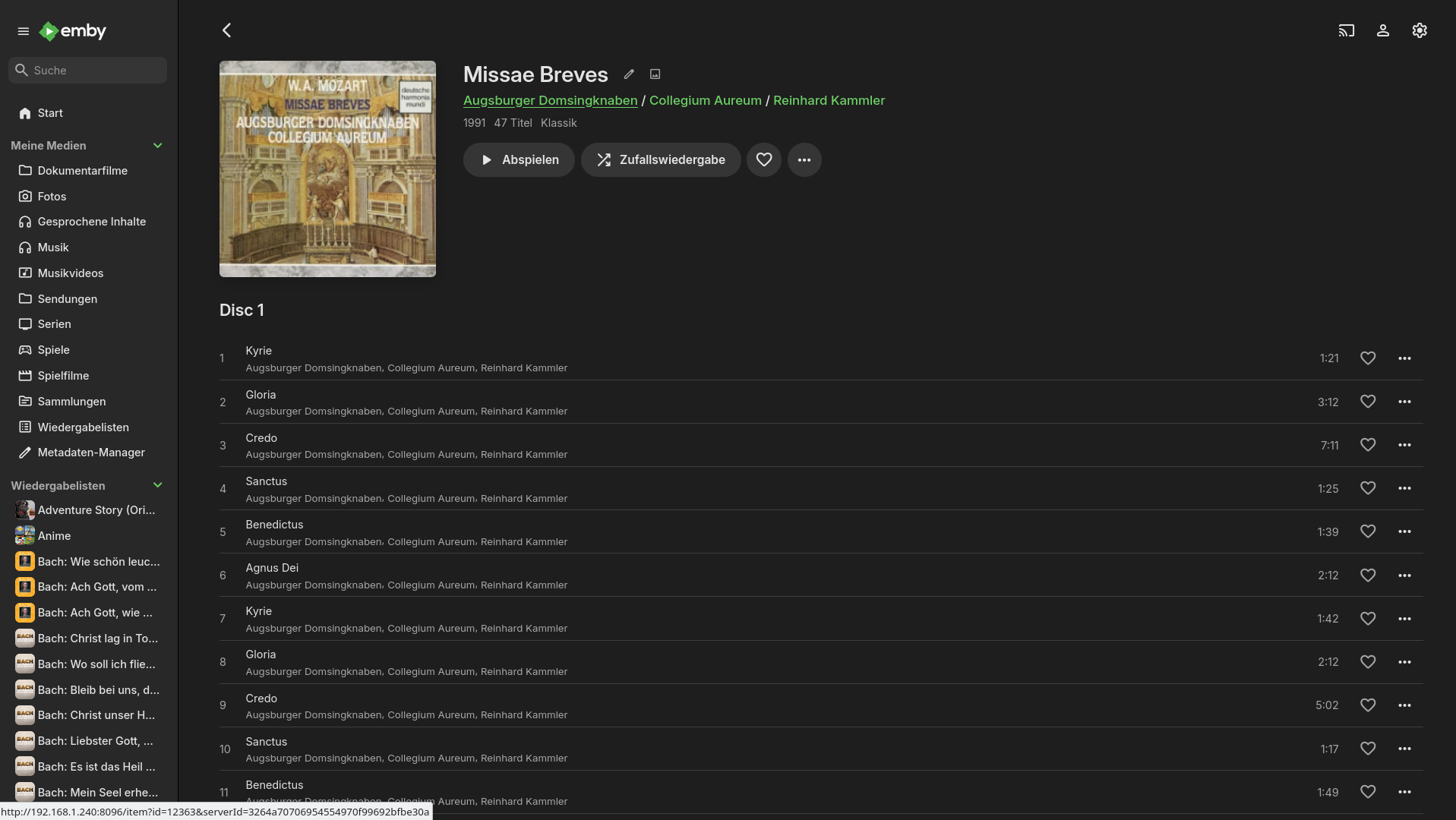

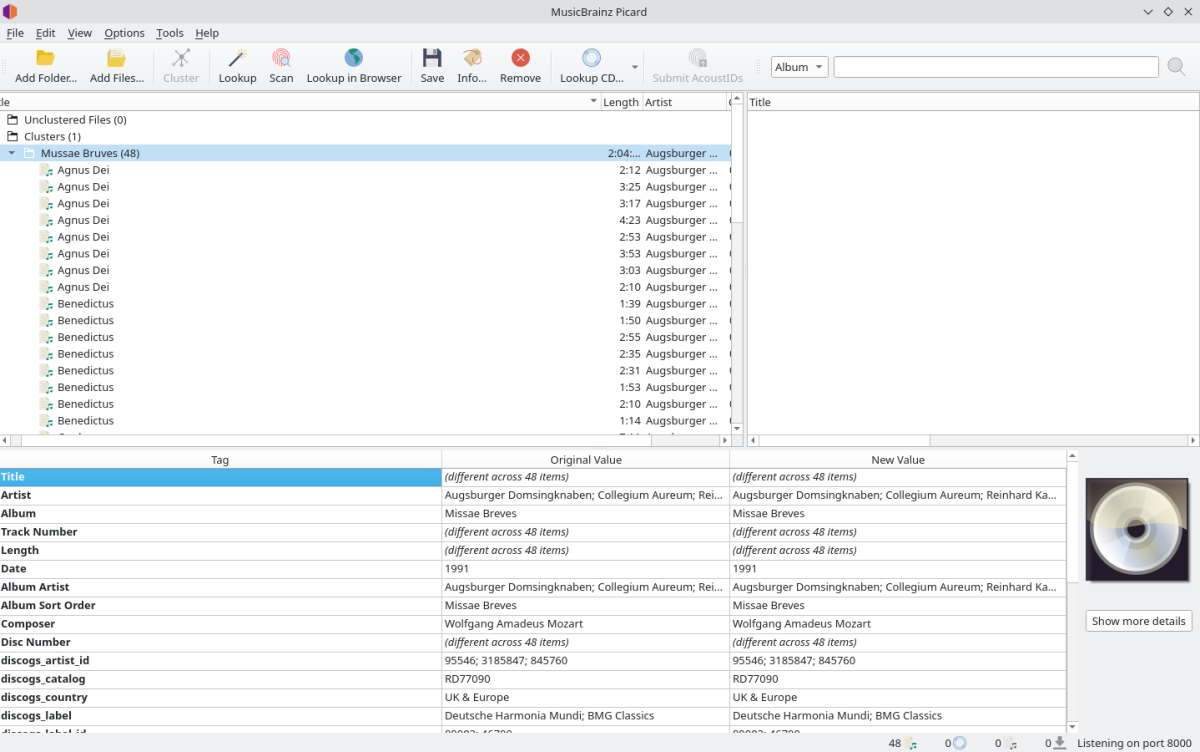

user24 369 Posted October 1, 2025 Posted October 1, 2025 (edited) Hi again, from looking at your info and the Album on Discogs, I am assuming that: You originally had a 2-disc album of 24 + 24 tracks that was displaying correctly across Disc 1 and Disc 2 under the one incorrect album title? You have embedded Discogs metadata but no MusicBrainz embedded metadata? Upon updating to the correct Album title with embedded metadata, using (MusicBrainzPicard or something else?) the album in Emby split into 23 tracks across Disc 1 + Disc 2, and 1 separate track 13 incorrectly under its own Disc 2? Upon changing the Album title to something else for more testing, the Album split into 48 individual tracks in Emby??? This still look like an Album Artist metadata issue to me Here are a few more areas to check: Even though you don't have MusicBrainz embedded metadata, Emby may still be fetching info from MusicBrainz directly if you have MusicBrainz turned on as a metadata provider within your Emby music library? If your music folder structure is different from what you have selected for your Emby library then this may be causing problems? If you have both AlbumArtist and a "hidden" Album Artist tag then the "hidden" tag could cause issues. You may be able to check this with your tagging program? (in Mp3tag for example - use View>Extended Tags). The three areas mentioned above, individually or in combination, may be causing the problem??? At least it is something to check, and rule in or out. Let us know what you find or any other info that may help. Cheers! Edited October 1, 2025 by user24
goblin2k3 6 Posted October 2, 2025 Author Posted October 2, 2025 Your assumptions are all correct. Quote Even though you don't have MusicBrainz embedded metadata, Emby may still be fetching info from MusicBrainz directly if you have MusicBrainz turned on as a metadata provider within your Emby music library? MusicBrainz is activated as a metadata provider for artists. It is not activated for songs or albums. Same goes for TheAudioDB and Discogs. Quote Even though you don't have MusicBrainz embedded metadata, Emby may still be fetching info from MusicBrainz directly if you have MusicBrainz turned on as a metadata provider within your Emby music library? I have selected the third option (tracks in album folders). This only applies for subfolders, though, as album folders are grouped in folders for genres, composers, artists etc. Quote If you have both AlbumArtist and a "hidden" Album Artist tag then the "hidden" tag could cause issues. You may be able to check this with your tagging program? (in Mp3tag for example - use View>Extended Tags). I cannot see any hidden metadata or differences between the metadata.
