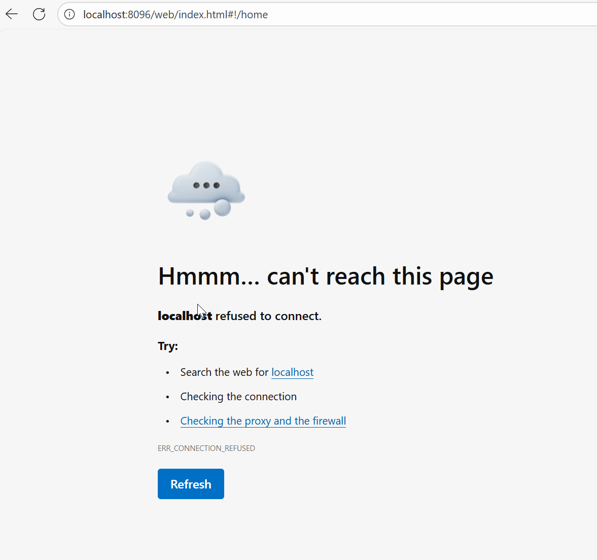

brothom 211 Posted October 1, 2025 Posted October 1, 2025 (edited) 56 minutes ago, michaeltruncale said: No, I don’t think so, Emby Server does not launch at all, I don’t even get any error screen. When I try to load the Emby Server exe the mouse spins for like a second, it generates another log file and nothing. Is there a way to downgrade and go back to the previous version and see if it works? The logs aren't showing anything weird, just that the server shutdown. Are you trying to connect to your emby via localhost or via app.emby.media? Have you tried clearing your browser cache? Does your server visit via the web just show a "This site can’t be reached" message? Whatever your cursor or system tray says, is there an Emby process running somewhere on the system? Perhaps there's a process that's lingering and preventing the "new" Emby from starting. Edited October 1, 2025 by brothom

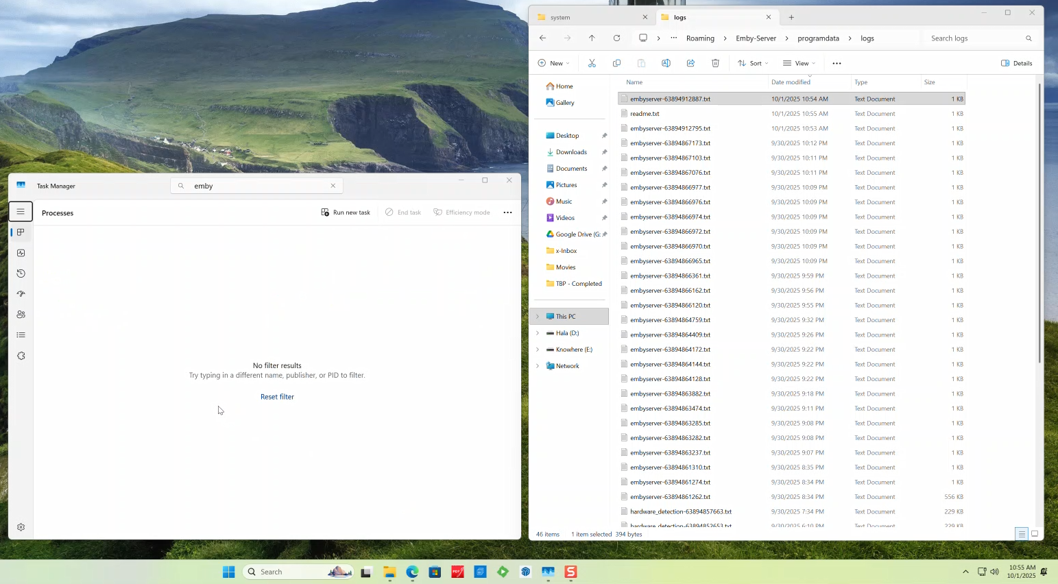

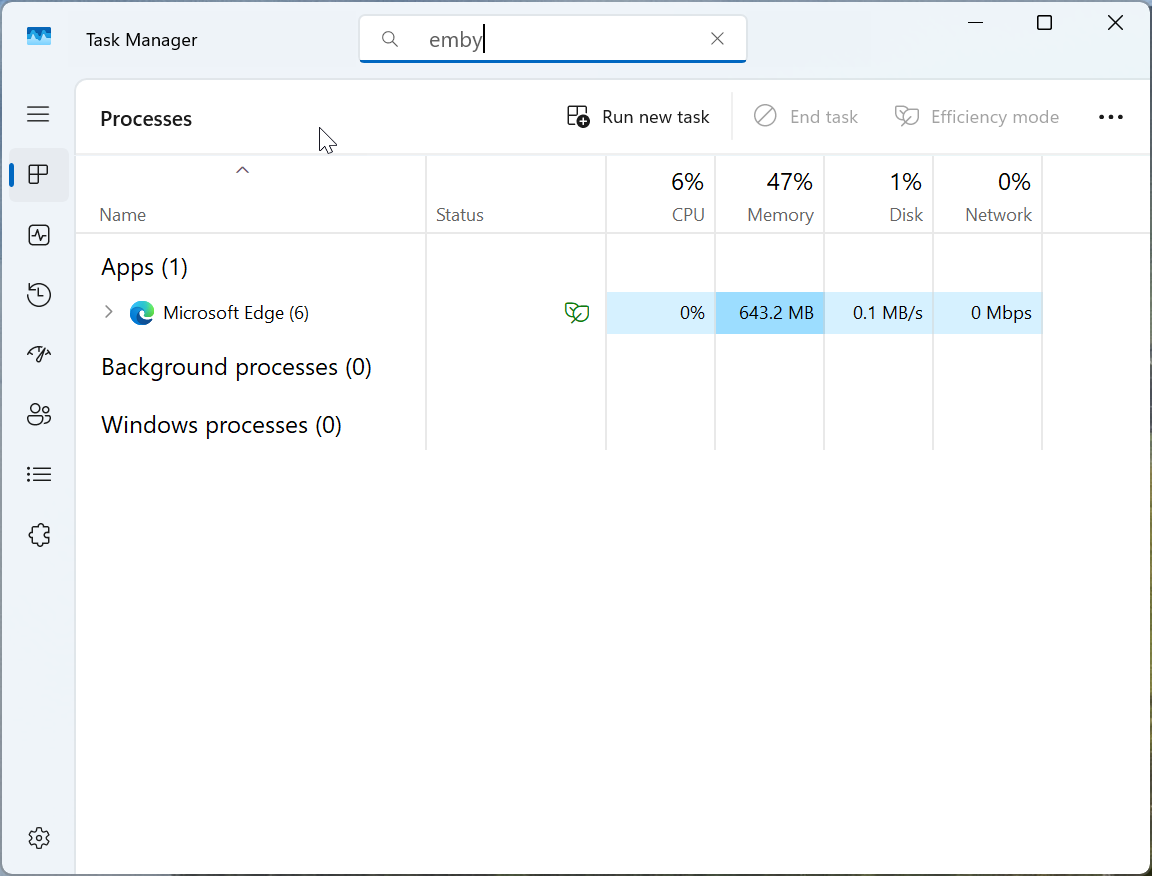

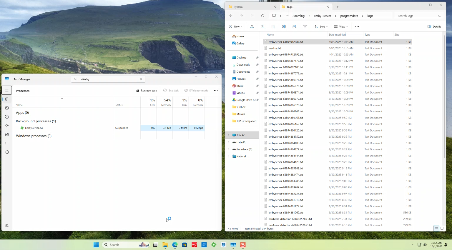

michaeltruncale 8 Posted October 1, 2025 Author Posted October 1, 2025 @brothom @ebr @Happy2Play I've tried restarting my computer. When I click on Emby Server it pops up on the Task Manager for a second, and says Suspended by it, then disappears. When I try to connect to Emby via browser (localhost) it just shows "Hmmm... can't reach this page", which makes sense since Emby is not running in the Task Manager. There is no Emby process running in the system tray or Task Manager. I don't think I can "roll-back" the system.old folder, after Emby Server did not load lastnight, I downloaded the Server install, and ran it again, would that have overwritten the system.old with the version that was not working? If I need to uninstall and reinstall what configuration files do I need to backup so I do not lose any configuration (i.e., server settings, users, watched, etc.,)?

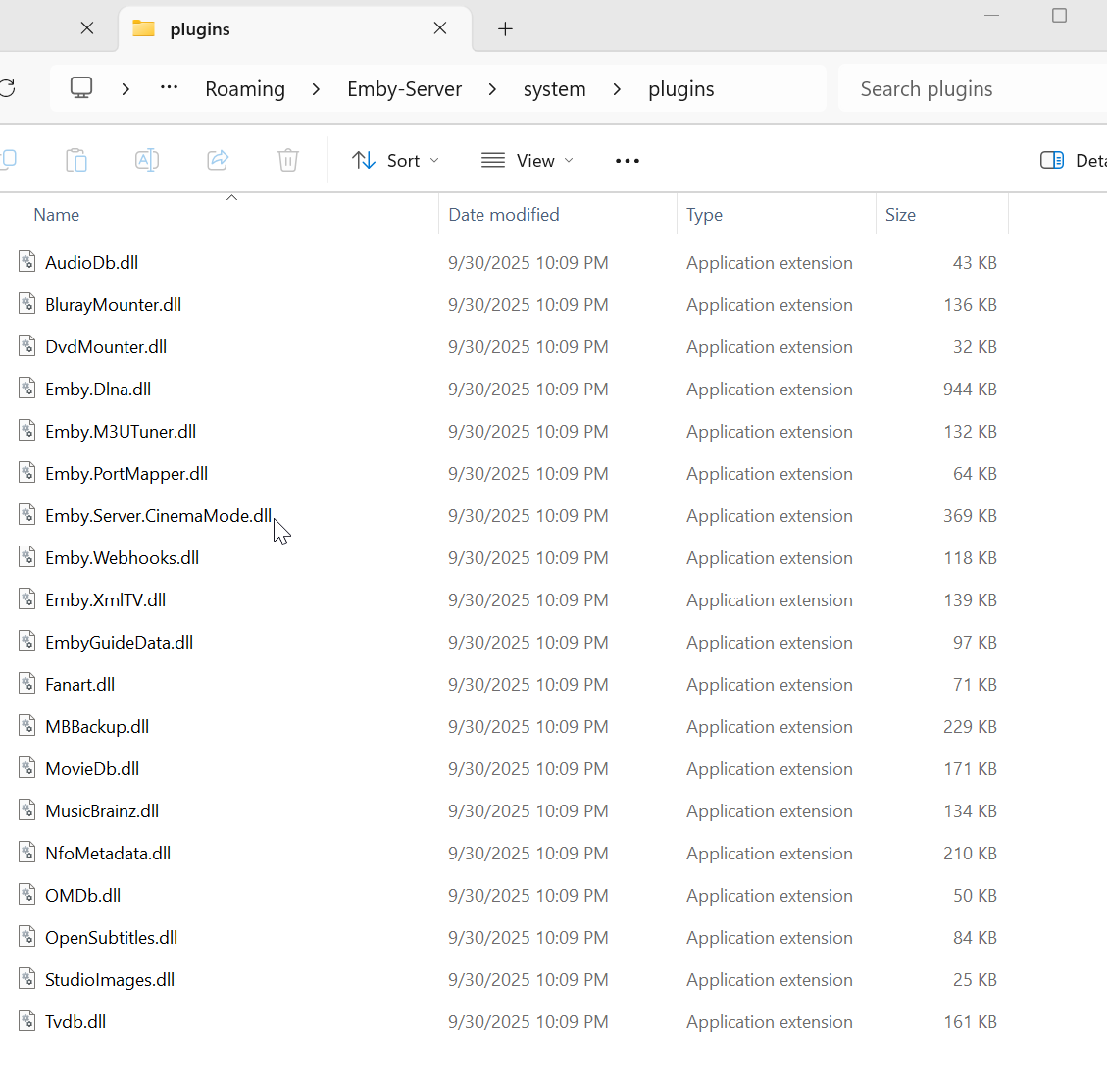

michaeltruncale 8 Posted October 1, 2025 Author Posted October 1, 2025 20 minutes ago, ebr said: Hi. Any 3rd party plugins installed? I'm not sure what a 3rd party plugin would be versus a non-3rd party. I attached a screenshot of my plugin folder:

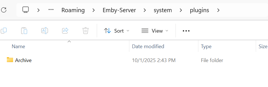

michaeltruncale 8 Posted October 1, 2025 Author Posted October 1, 2025 3 hours ago, ebr said: Hi. Any 3rd party plugins installed? I moved everything to an Archive folder, rebooted, tried to start Emby Server again, didn't work, I also then tried to reinstall Emby again, didn't work. So, I don't think it's the same 3rd party plugin issue that plagued another user with the EmbyIcons.dll. Next idea?

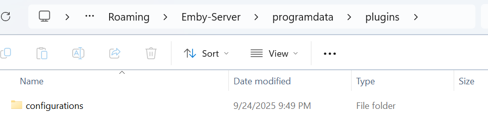

Luke 42288 Posted October 1, 2025 Posted October 1, 2025 10 minutes ago, michaeltruncale said: I moved everything to an Archive folder, rebooted, tried to start Emby Server again, didn't work, I also then tried to reinstall Emby again, didn't work. So, I don't think it's the same 3rd party plugin issue that plagued another user with the EmbyIcons.dll. Next idea? Don't mess with that folder. Please undo whatever you did. Then I would delete all of the .dll files in this folder: C:\Users\Michael\AppData\Roaming\Emby-Server\programdata\plugins
michaeltruncale 8 Posted October 1, 2025 Author Posted October 1, 2025 28 minutes ago, Luke said: Don't mess with that folder. Please undo whatever you did. Then I would delete all of the .dll files in this folder: C:\Users\Michael\AppData\Roaming\Emby-Server\programdata\plugins Okay I've deleted all the .dll's in that folder, there is a folder left in there, I am assuming don't touch that either...

michaeltruncale 8 Posted October 1, 2025 Author Posted October 1, 2025 (edited) 5 minutes ago, Luke said: OK now please try starting up the server. I get the same result. Cursor spins for a second, and it shows in Task Manager for a second, then disappears. Edited October 1, 2025 by michaeltruncale

michaeltruncale 8 Posted October 2, 2025 Author Posted October 2, 2025 (edited) 7 minutes ago, Luke said: Keep emby server shutdown while you install from the website. If there's still an issue after that then please attach the server log file that got created. Thanks. When you say keep Emby Server shut down, it's not even loading, like nothing in the task bar, nothing in the Task Manager, Emby Server does not load, is there a different process I need to kill? Each time I've attempted to install, Emby Server has not been running, and I get the same results. server-install.log embyserver-63894934788.txt Edited October 2, 2025 by michaeltruncale
