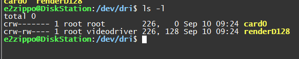

e2zippo 25 Posted October 6, 2025 Posted October 6, 2025 2 hours ago, Bims0n said: @e2zippo: Sometimes the assigned rights on the corresponding transcoding driver files reset, you then have to reset them again manually to the correct user. This once broke transcoding for me, and it took forever to diagnose. You can find them under "/dev/dri" with the rights split into [owner/group/0600]. For me they are: card0 (root/root) renderD128 (root/videodriver) Thanks, I'll take a look how that looks on my end!
e2zippo 25 Posted October 6, 2025 Posted October 6, 2025 5 hours ago, e2zippo said: Thanks, I'll take a look how that looks on my end! Looks Ok here i guess?

Bims0n 14 Posted October 7, 2025 Posted October 7, 2025 On 10/6/2025 at 7:03 PM, e2zippo said: Looks Ok here i guess? Looks good to me. Is a reason mentioned in the transcoding log why it fails?
