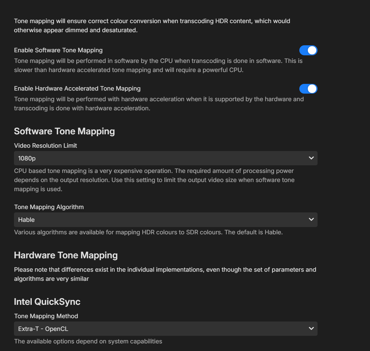

heffeque 78 Posted October 5, 2025 Posted October 5, 2025 (edited) 16 minutes ago, firefox1970 said: I have Update to Version 4.9.1.80 on my Synology 720+ today and the HW transcoding is still working. With tone mapping it isn't. Edit: check here Edited October 5, 2025 by heffeque 1
rekit 16 Posted October 6, 2025 Author Posted October 6, 2025 12 hours ago, firefox1970 said: That shows it’s enabled but not necessarily that it’s working. Also it may be software tone mapping since you also have that enabled. 1
